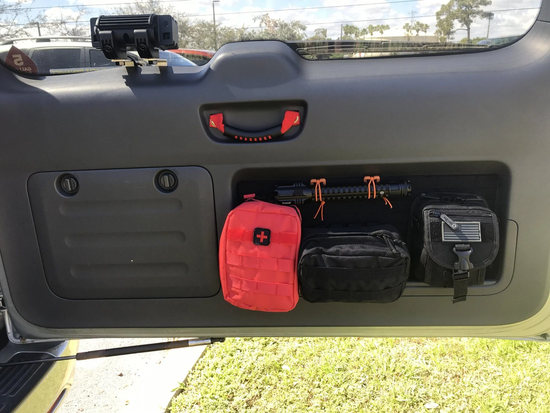

Here is what I did with mine. Not a whole lot of storage but much better than the factory net. I did a write up in the best mod under $100
I am still not clear how you riveted the panel in... How were you able to rivet the last side in and keep it tight? Also which panel did you get and where?
Hey, I actually just rolled the edges on all four sides and put the rivets in from the front side behind the molle loops. There are better pics in my best mod for under $100 write up.
