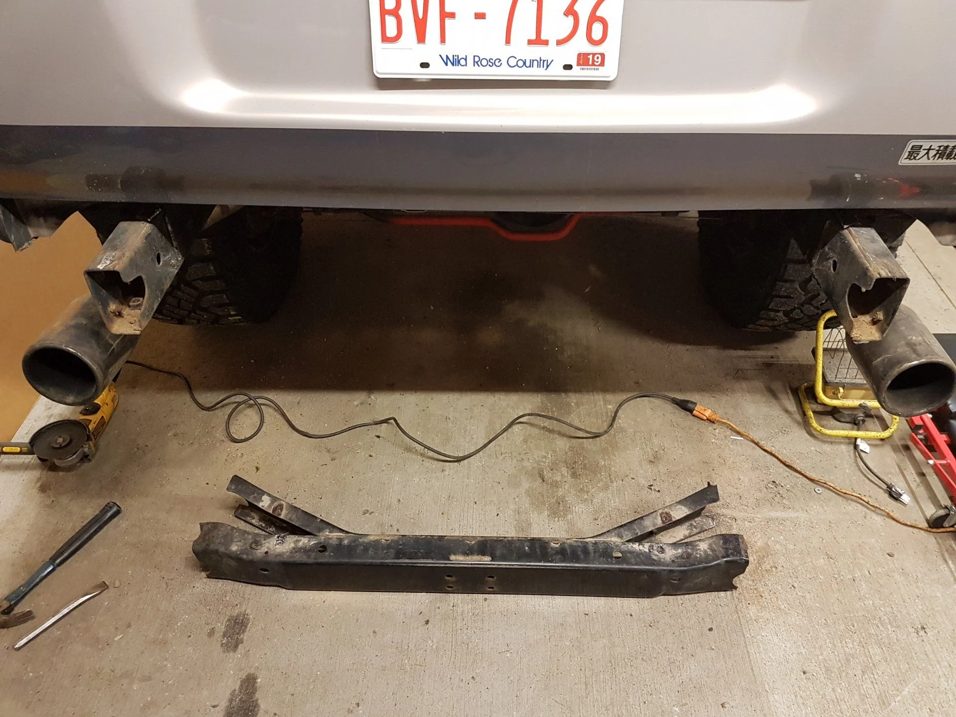

Rear Crossmember Replacement Poll Time
Weld or Bolt?

Doing that here in Australia will require a very extensive engineering assessment before such a mod is approved. In effect, it's completely altering the original design of the chassis. Looks really good though but as mudgudgeon said Oz rules say that you cannot weld on any kind of aftermarket towing setup. I think it's because when a vehicle is approved for sale here it gets 'type approved' for it's baseline standard engineering spec by a federal government dept and anything that modifies it requires engineering approval or it voids rego and insurance.

After 5 saw-zall blades met their maker, whichever route I decide to go, there's no turning back now.

If Tow Hitches have to be welded to a frame than any hitch on a Unibody car is illegal including my Lexus RX.
Also, every Tow Package on US spec 80's would be illegal

How Tall is that C-Channel? About 4"? I have an idea
