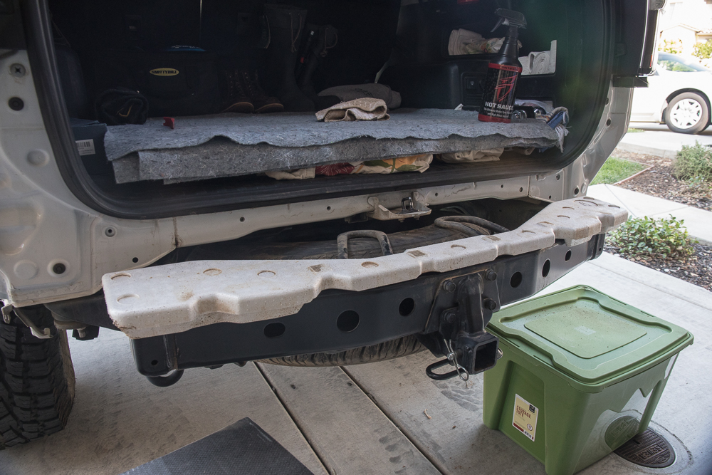

Also, I ordered two of the bolts as (all thread). There are nuts welded on the backside of the cross member on two of the holes (the other two do not have them). So I didn't want the shoulder of the bolt to be longer than the thickness of the pintle, safety chain plate and cross-member. The bolts are longer than needed but it helps to be able to reach them and get the nuts started.
I tow from the pintle holes, although it's not a pintle hitch. This setup does just great with my popup camper, including a little bit of off-roading with the camper in tow.

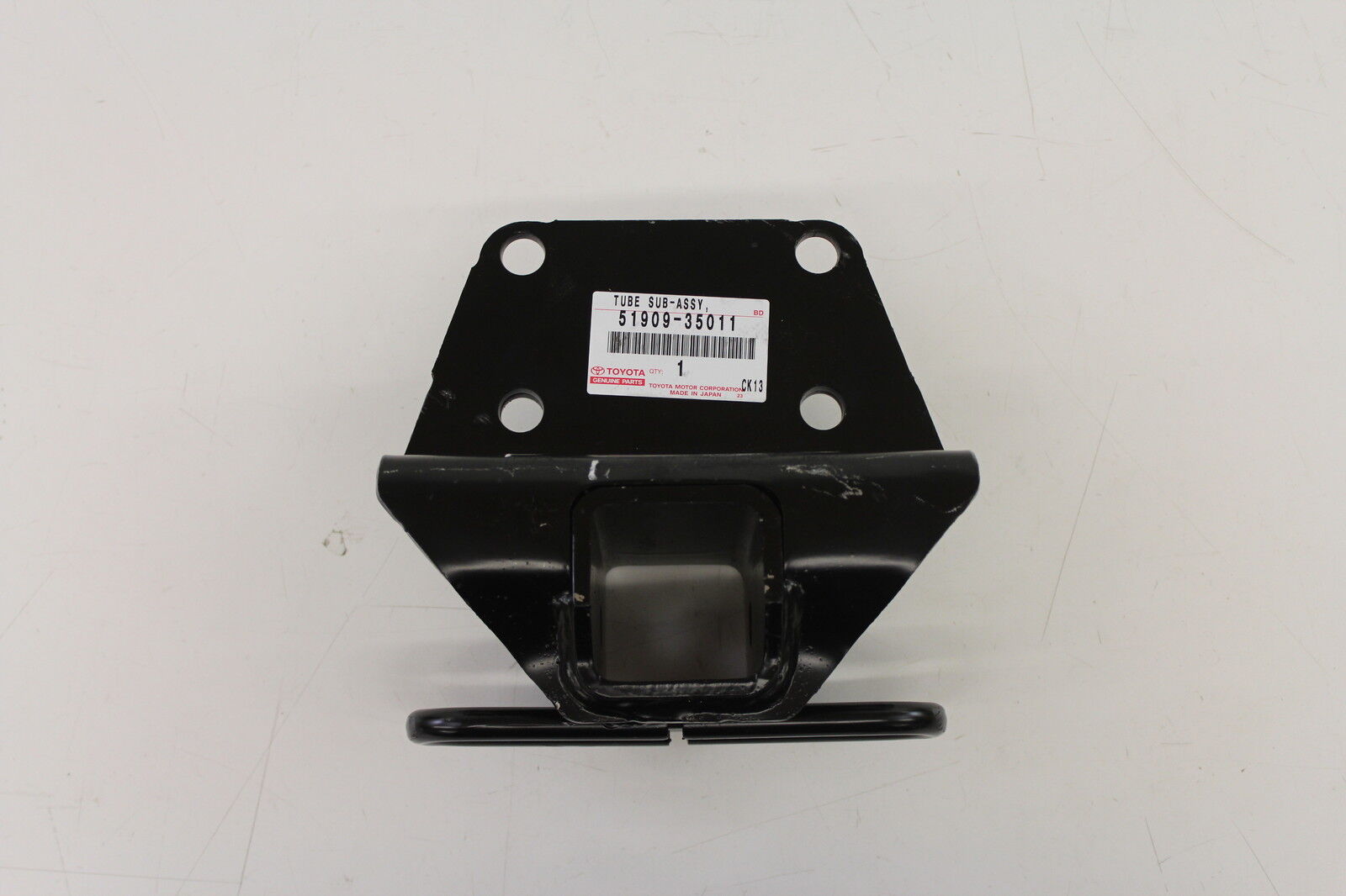

Also bear in mind that toyota has no problem approving pretty much the identical setup on late-model vehicles. I think they just didn't bother with testing/approvals back in the 90s. I have also read here and there that the 80 series with a pintle is actually rated to 5000 in other markets, but can't really back that up with anything.
Here's genuine toyota hitch for a late-model 4runner. Bolts to the rear subframe exactly like mine.
:edit: to be fair, the 4runner rear crossmember does appear to have more structural metal out where it meets the rails (no gaps)
