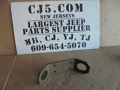

Deletes the chrome ball and bolt in favor of a forged 2" ball/hook. Should suit my needs, if not exceed (short distances with about 3k# behind). @flintknapper where did you find the chain plate? most I've found are in the $50 range with shipping...sounds high to me.

Ebay, nice condition and quality $30.00

I'm about to digress, so fair warning. in the above pictures of @flintknapper surplus safety plate, what's the prescribed method for introducing a bend in metal that doesn't immediately create a fatigue area? Is it simply heating then bending? More of a fab question I know. Sorry.
If you want more info about fabricating and bending the metal in more detail from a fabrication perspective, I can advise on how most fab shops get there based on material and tooling, within the failure ranges of the material.
