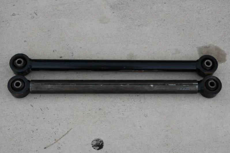

This may be something in my future...good mod. To Nay, how much did you lengthen the lca's to return pinion angle?

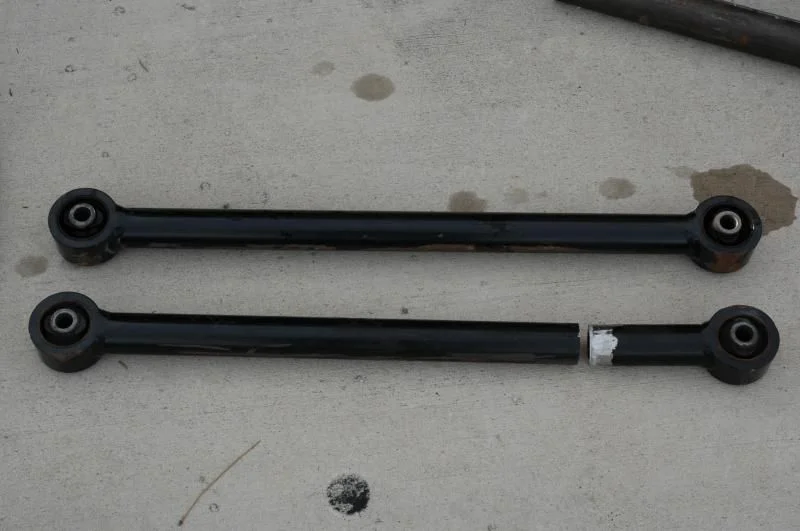

It ended up being a hair under 3/8". It looks good that way, my arms are now 2" OD, 3/8 wall with tube in the middle reinforcing where they were cut.
Here is what a perfectly good 1/4" wall Slee arm looks like when you cut it in half and then sleeve it :D
