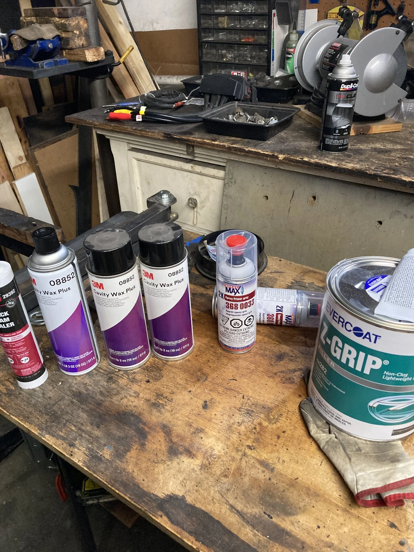

This is the epoxy primer - B67
and used reducer R7K111
https://www.paintdocs.com/docs/webPDF.jsp?SITEID=STORECAT&doctype=PDS&lang=E&prodno=B67A5
This is the Acrolon industrial paint (comes with hardener), and I used Reducer #58. It comes out super thick. I had to reduce it down well below what they recommend in order to spray it through my gun (had no effect on the properties, just didn’t go on as thick)
https://www.paintdocs.com/docs/webPDF.jsp?SITEID=STORECAT&doctype=PDS&lang=E&prodno=B65B600
Go here to match up colors
and get the color codes. They can cross over any color they have a code for in their home line(?) to Acrolon. If they don’t have anything close to what you’re looking for, they can still work to match, but takes longer.
These industrial primers and paints are only available at the SW Industrial locations and can’t be purchased at their regular house paint outlets.

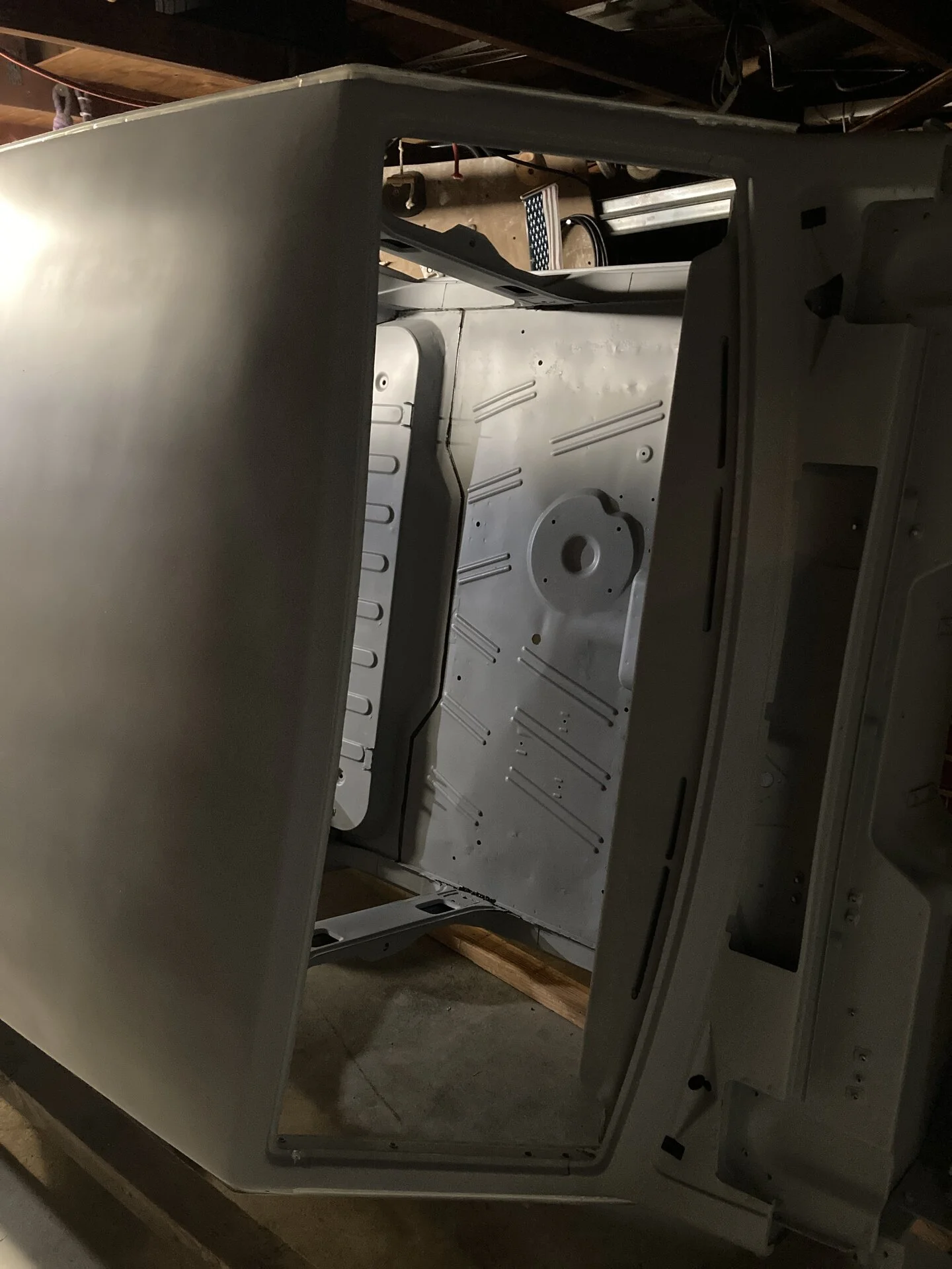

You can look back on this knowing you did everything right.
Right , wrong or indifferent you have to move forward or it will be the perfect project that never got finished. I don’t know that the perfect Pig exist or ever will but we all share ideas trying to achieve that one pig that will get the closest.
What I’m trying to say in a whisky fueled tirade after a long day is don’t let these minor details we talk about delay your forward progress but rather incorporate them if it’s convenient, if not keep moving forward with your plan and finish the pig. So with that said a good primer then a good top coat on everything first. If you need texture on your undersides apply it over the top coat.
