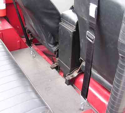

Correct use of reinforcement (like fender washers to spread the load and a backing plate under the sheet metal) should be fine. I mounted Crows 3 point harness system into the floor boards (sheet metal essentially) using Crows floor mounting hardware http://www.crowenterprizes.com/shop_details.asp?cat=Mounting+Hardware&prod=FLOOR+MOUNT+SET (plus I used a backing plate).

I am not sure I would want to trust seatbelts to a bench seat, though. Floor-mounted with proper backing plates is the way to go. The nuisance is that the floor mounts restrict the usable space in the back.
photo of mounting into floor board. I can agree that it does restrict space to some very minor degree, but no other real great way to mount them.

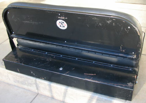

anyway, as for the rear bench which is his concern, here is my confer bench seat
there are mounting spots on the bench specifcally for seatbelts AND the bench is bolted to the floor with 5 bolts with backing plates... hella stout. so not sure why you would not trust belts attached to a bench? virtually every bench seat has belt attachement points, no.
the frame of the bench does not strike me as being particularly stout; just my $0.02
as far as space: I was talking about space behind the rear bench....... that becomes restricted with seatbelts mounted to the floor
well, mine is easily 5mm thick where attached.. that is pretty solid I would say. Plus, I would be hard pressed to think they would provide the eyelets for belt attachments if they wern't up to par? then again, I have seen weirder.
ah yes.. I would agree there. wouldn't want to tie in behind the bench like I did behind the front seats, BUT I would if I had kids back there. for shizzle.
