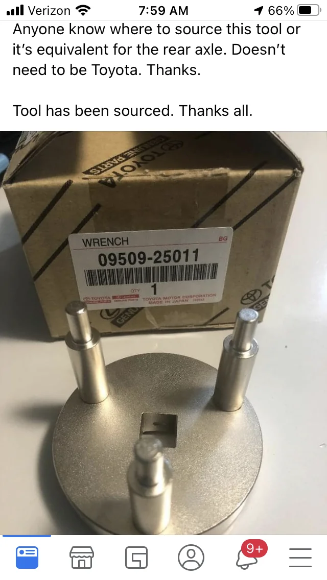

Can anyone tell me where I can purchase the socket required for tightening the nut on the rear axle bearing nut?
Toyota Part Number 09509-25011
Toyota said they cannot sell tools to customers.
Does anyone know if MAC, MATCO, or SNAP-ON carries something equivilant?
Thanks in advance.
the socket above also does the front wheel bearing lock nuts

Or just take the socket you have and cut/grind out the spots for the stubs on the rear axle nut.
We made a plate (1/4" thick) and drilled 3 holes in it to match and then inserted (3) fully threaded bolts and tightened them on, the cut a square hole in the center for the ratchet. Looks like the tool in the Toyota pic.
If you have a socket just like the black one for the fronts, all you need to do is cut the 3 slots to fit the rear bearing nut. No need to buy another socket.
this^^^^
It's not rocket surgery, a magic marker, a hacksaw and a file for clean up. Easy Peezey lemon squeezy.
Yup, this is what I did after finding another post on here a year ago suggesting the same thing. ****ing brilliant.

I ground slots in my front hub socket. 15 minutes with a grinder, job done. And you have one tool with two purposes. Less junk to pack or store.
Fwiw, the socket I carry in my trail bags on FF Cruisers… is a modified front socket. Kevin (ToolsRUs RIP) pioneered it as I recall and it’s the best option for a single tool. Takes a few minutes to build. We use the traditional individual sockets in the shop.
AND it does the rear wheel bearing lock nuts. Read that desc and look at that pic, it's pretty cool!
