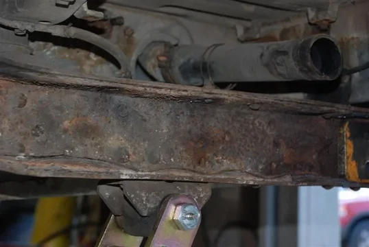

Well truth is I screwed up in the order, should have just went for a full off frame restore but did not have the equipement and from my initial checking the rear frame minus the cross member was ok. But after cutting out the 6 inch angle iron that the PO has used to cross brace a receiver hitch found that there was a very rusty c channel in the rear. And BT was not on her axle's with half the body lifts cut out. So to keep her rear end together put the bumper back on for temp and now had to wait till the axles back on so the tires could carry the weight of the frame and drivetrain to lift the body for the body lift. Was just about to have too many things hanging over my body. Any way with the lift compleated will have a few more inches of room under there to hammer chisel and grind this mess out, then box in the frame.DSC_0090 (Medium).webp

So next is wheels then lift and more rust grinding and some welding to follow pic's as soon as possible.

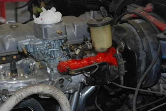

Bad MOJO
Bolt in, you have the spacer.
You need to get rid of that rusty master cylinder and put one o those purty T100s in there, it detracts form all that glare on the manifolds.

That damn ugly m cylinder finally got to me was working on putting in the plugs for the air rail and smashed into the ugly thing one time too many. Short story it's out and to be replaced by a inch T-100 master pic's to follow. :cheers:

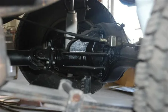

Tidy up a bit, working on all the little things that seem to come up. Had to order greasable shackel pins the kit did not have them and I was not happy so got them installed this weekend. DSC_0021 (Medium).webp

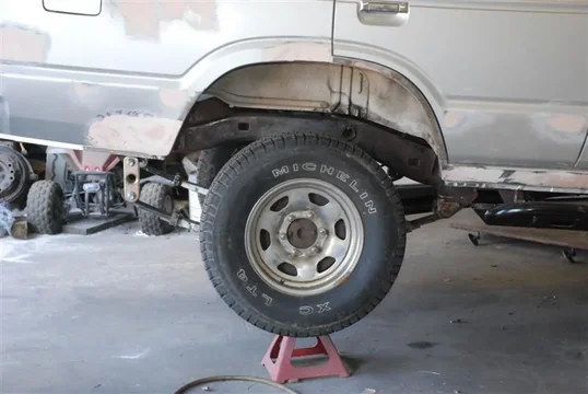

and going
Put the Michelins back on had to put some pressure on the springs and the new tires and rims are not here yet. But this heavy lift gives pleanty of clearance the stockers were just about even with the outer fender in the rear from spring sag in the orginal springs. Not the case now!
Looks like a vw would fit above the stocker now.
And that is compressed all the weight is on the rear axle so not much compression. DSC_0020 (Medium).webp
I think i'll fit!!!!:flipoff2:

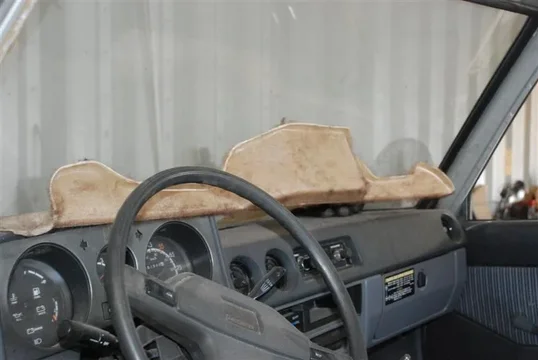

Gauges and switches
Here is a shot of the overhead console from SOR after taking off the crappy brown carpet. Have several switches and gauges going in as I can plan on not covering it just putting a good heavy coat of paint on after installing all the electricals.
It's red not rusty
Kevin could not find a T-100 mc in stock in the area, so just wire brushed and painted the old mc. Will have to change later but it'll do for now. At least it's cute now!!!DSC_0012 (Medium).webp

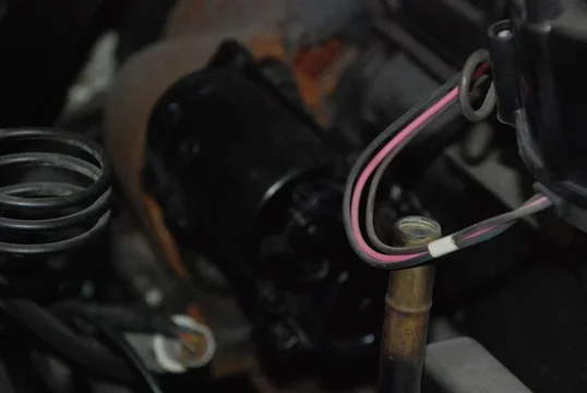

Let's see starter reinstalled and y pipe to exhause headers, Plugging along.
DSC_0018 (Medium).webp Cleaned up nice with some black paint
All for now still going. :beer::beer::flipoff2:
