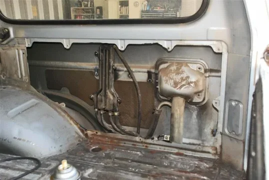

2. Kevin at Wagon Gear let me know that my Quarters are on the way so I went ahead and cut out the braces and went to get the new hoses to relocated the vent thingie. Pic's

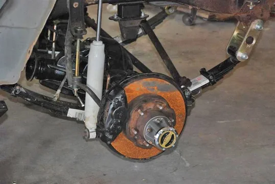

3. Big news is the lift kit install and the axles are back under the rig. Now if we can just find the lug nuts(don't know how they grew legs) we can at least roll her around the shop to finish the body lift and the painting.

Cutting out the braces was easy just a few seconds with a cut off wheel and air compresor and gone then smothed with a grinder. Piece of cake. The lift that I purchased was before I found mud and therefore not what I might have ordered now. But I had it so I installed it. SOR Heavy 3 inch kit. Photos's follow the axels have been compleatly redone with all new bearings and lockers rear and auburn limited slip in the front. DSC_0005 (Medium)c.webp
