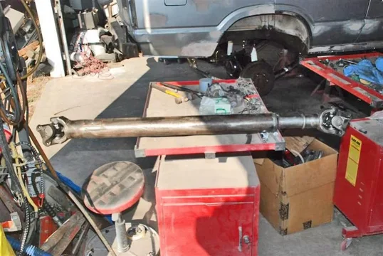

U joints and Drive shaft worked on
Yeah the ujoints were showing some wear in the bearings when I took them out, but they were not giving as yet. Should be good for a while with the new one's in place. DSC_0048 (Medium)c.webp

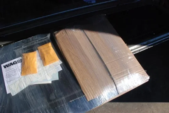

Santa came early
FedEx tells me there should be a big heavy present waiting for you at Johns. :cool:
And look how nicly wrapped for delivery!
First layer removed plastic wrap and corrigated cardboard.
