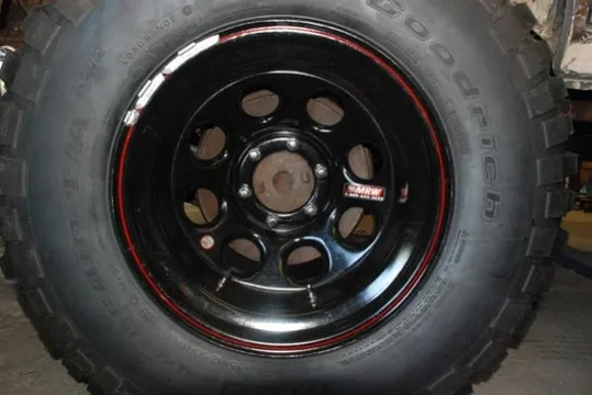

Have recieved and installed today the Marsh Rims, 17 X 10 Black Steelies with custom backspacing to off set the tires to the outside by a little.
Also recieved and installed today stran internal beadlocks in above rims. Not as hard as it seemed just the nerves of drilling a valve stem hole in new rim gave me doubts.

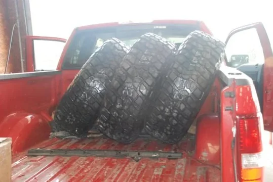

And the 35 X12 KM2's mounted and installed today as well.
You can see the second hole one is for the beadlock tube, the other for the tire prssure chamber.

How much did those bead locks run you? That seems to me to be the best way to have beadlocks on the street.
They are indeed proud of there invention, but when you consider the cost and mod's necessary to run double beadlocks and mods to drive links etc to clearance double bead locks(calipers?) they are competitive. The 17 X 10's were 168.00 plus shipping. :eek:
And these have a run flat advantage over regular beadlocks. So take's you path pay's your money. :)
A piece???? I certaintliy hope not!!
What backspacing did you go with? 3.5 or 4 or what?

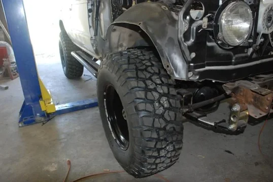

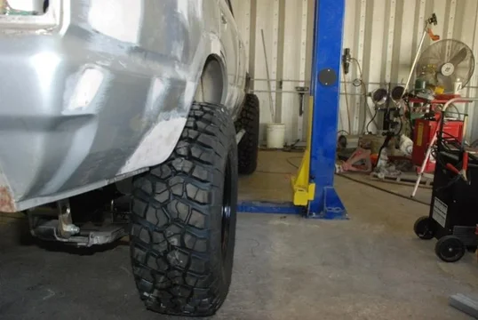

BT on her 35's
Got em on and some pic's
