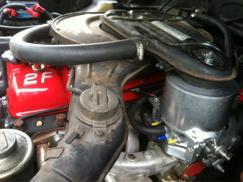

Word is that Trollhole will have it ready at the end of the week. So looking forward to this, will post more pic's when I get it back:)

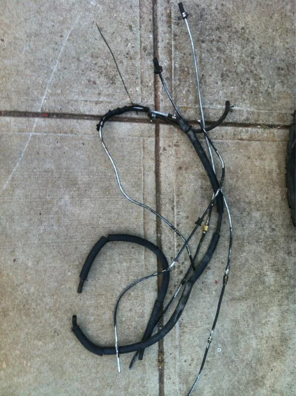

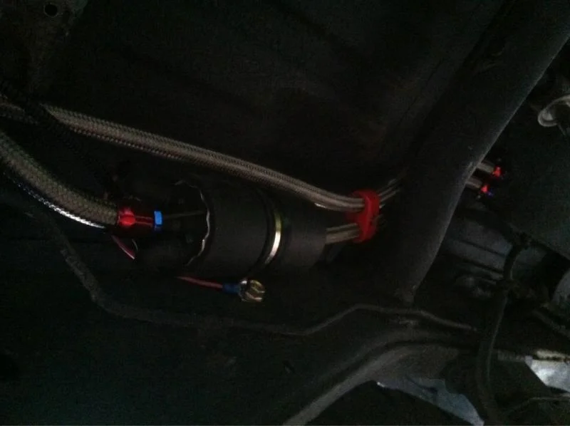

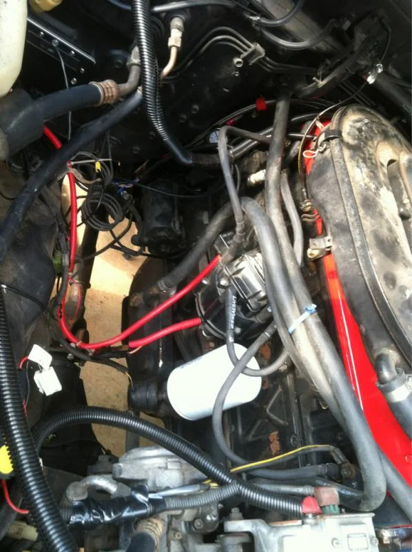

Old fuel lines out and new installed. ECU is up and running.
Pic's
Thanks for posting those up trollhole, I just love those fuel lines and that fuel pump install looks top notch to boot. Going to be fun showing off your work at the upstate meeting this Saturday. Keep up the good work. And thanks again for the photo's . Oh and Happy birthday dude I sure did not know that your birthday and mine were so close. We will have to have a beer to toast or older age. :cheers:

Am I mistaken, or is that the CPU I see on the firewall?
Also I now see I need to paint that air cleaner , didn't seem important before but dang that install looks good. Thanks in advance.
OMG this is farking awesome!!!!

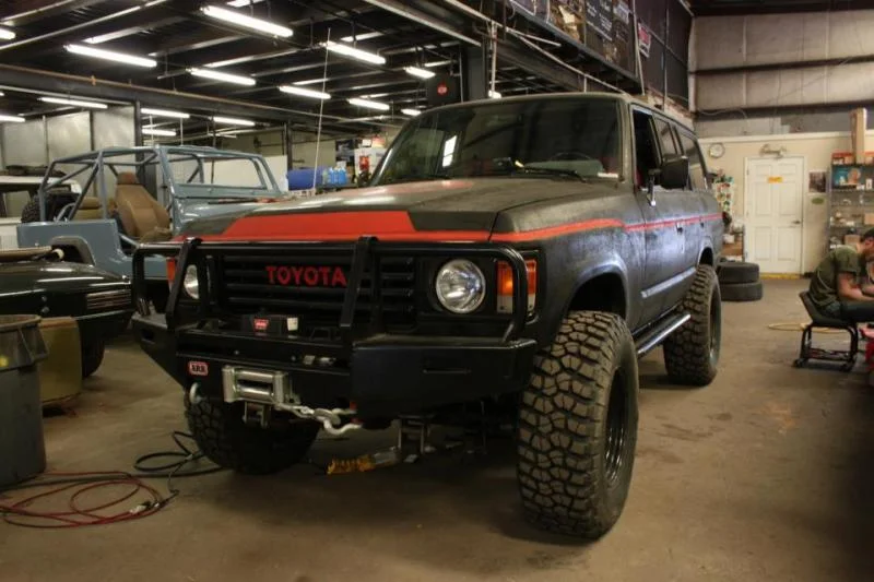

Folks just got thru driving the new fuel injector installed by Trollhole in my 60. OMG you can not believe the difference from the webber. Now I did not get to do any off camber stuff yet(I was only home for a few hours as I passed thru to another assignment) but it starts cold on call, idles smoother than it ever did with toyota or webber carbs. Throttle response is adequate and the overall perfomance seems smoother and I bet with time the mileage will increase. Can you say I am happy with the conversion you better bet the farm that I am. And the service Marshall gave on the install went way above anything you would expect. Got to say it loud and proud Thank you Marshall for coming up with this install. :cheers:

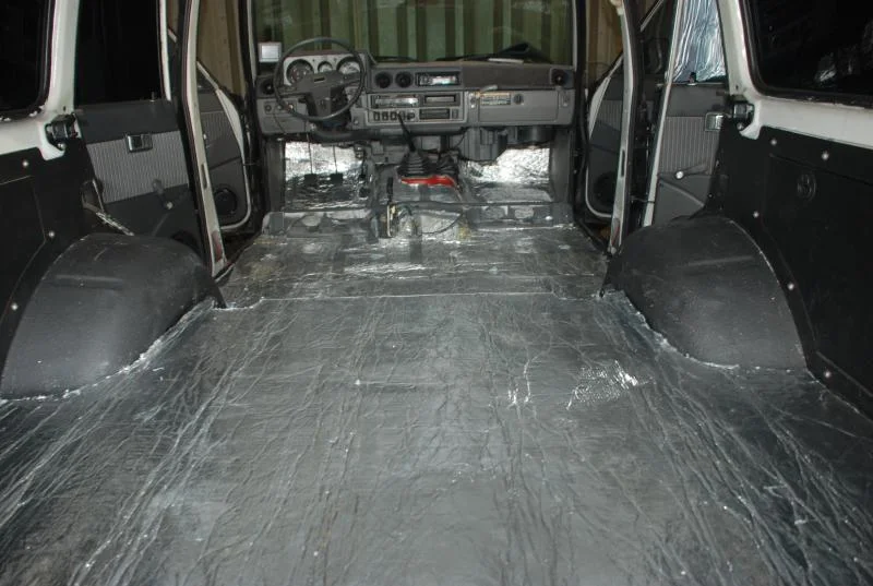

With the TBI's highter fuel efficency had come another problem, When I rebuilt this rig I opted(read whoops) to toss the heat shields as I was installing a custom stanless exhaust and any way how hot could it be. Well with the Webber carb it was barely liveable, not comfortable but doable. As the efficency of fuel burn has gone way up I now have temp's in the floor board area that are downright uncomfortable, close to melting the soles of my boots. It seems that the 5 speed and the low range gears also contribute some heat as well so my toes were getting roasted.
But not anymore, I used a heat shield product from second skin and the heat is gone. Also used a dampner paint and closed cell product to lessen heat, and also to cut down on the gear whine from the AA gearset.

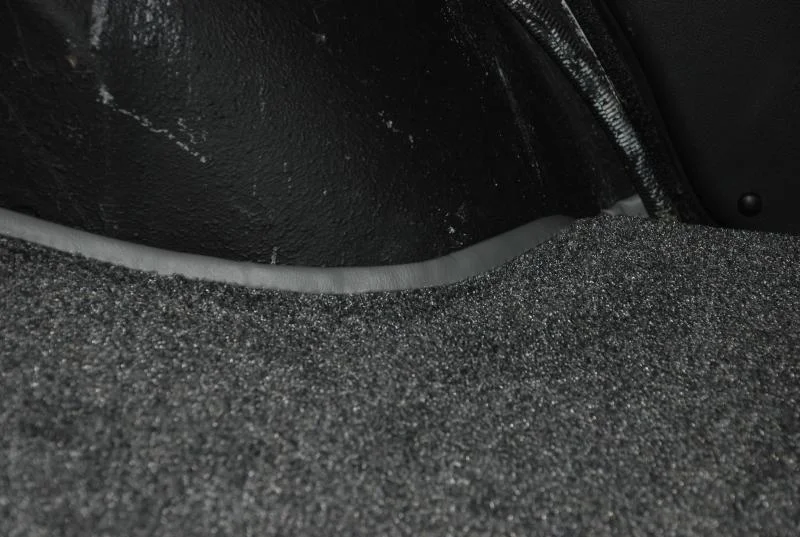

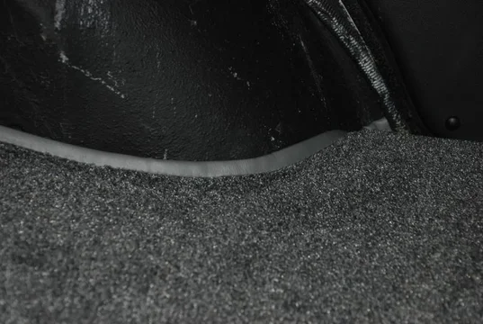

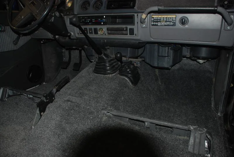

I have now installed marine carpet dark gray over the insulation and sound damp products from second skin.
A local shop sourced the carped and installed for 300.00 and they did a very professinal job. They even banded around the wheel wells, and that's under the rear seat, professional at the least.008.webp

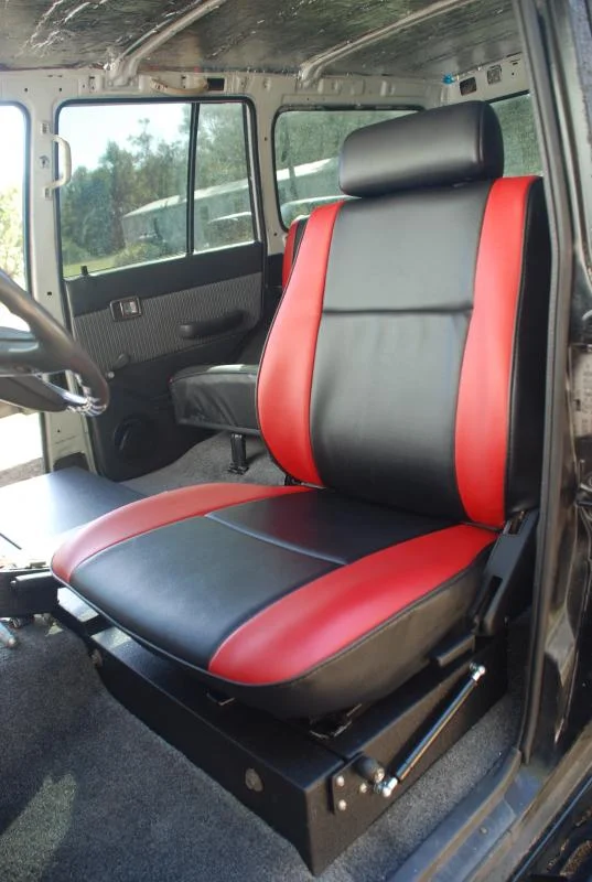

Traded away my Corbeau seats they are not really made for a 300lb load that I was subjecting them too. A local ih8mud member and I traded, I got his really nice brown FJ-62 seats that were like new. Had them recovered and this is the final result, mounted on the new seat storage box from Wagon Gear (thanks Kevin)
