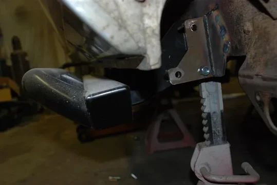

Glad to hear that ingrid is running, got some pic's of the sliders installed, at least temp instalation as final adjustment will be after the body lift install and paint, darn things got to come off again and the 4+ rear bumper is on as intended, it too has to come off for paint etc. Lots more filled in areas and fiber filler, note the sliders are covered in dust didn't have time to clean up for pics.

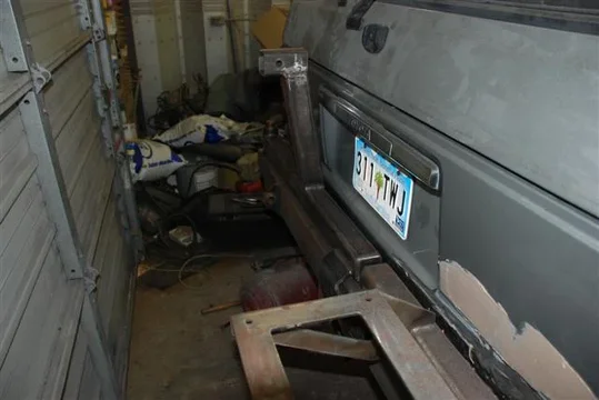

And the rear bumper is in place, man the stuff the po had welded in to that rear frame for a simple bumper hitch was astounding. Took 4 hours with a plasma cutter and torch,and of course a BFH to get it in place correctly. But I think the fit is ok, and the thing is massive to say the least. DSC_0010 (Small).webp

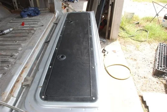

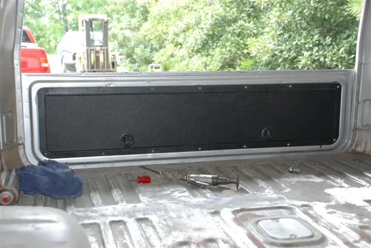

And as the install has been covered in several places and on the wagongear web site some photo's of the dry fitted door. Will have to come out when the bedliner finish is applied to the interior of the tailgate.

It is even better than it looks what a wonderful product and sturdy is not the word, but then this is the heavy weight prototype not the production door. Still it is awesome. :):bounce::bounce::bounce:and again if you have the right stuff to cut the hole a simple install.

Oh man, I can wait to get mine!!!! I'm like 25th-26th in line though....Looks great. Good job, looks as easy as kevin says, did you line the chamber with sound deadening?
No just going to bed liner the interior of the door and the FJ-60 ans see what happens , if too noisey or roughf on stuff can always do the liner later . I mean there is not a place inside the tailgate that I can't reach to add coating or sound proofing. :D:D:grinpimp:
