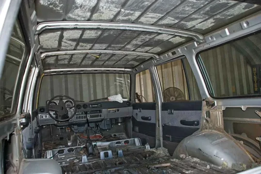

Over the last two weeks I got to work a little on the BT. Mostly removal of the headliner and the associated hardware. Then scraping off the insulation and finally sanding off the glue and most of the old paint. Not many photos too boring.
That crappy glue clogs up wire brush, grinder wheels only thing worked was a sander and grinder grade disc.
DSC_00051.webp:mad::mad::mad:
