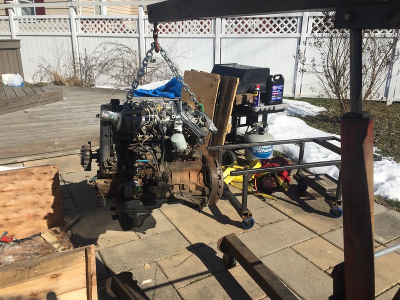

Been on mud for a while and figured I would start a thread for my 1KD swap.....from a 3 point slow to 3 point Go!(at least I hope)

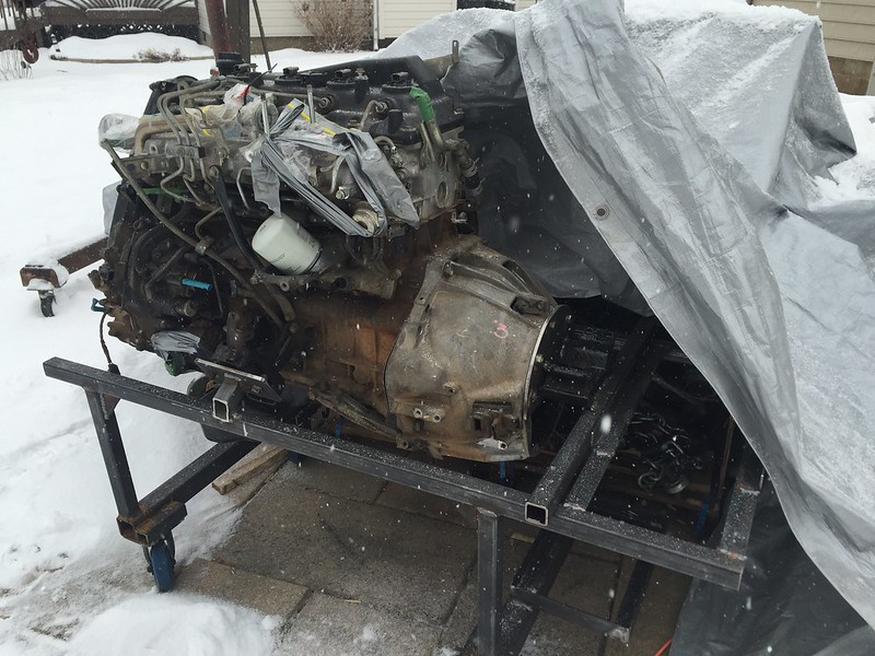

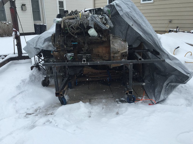

1KD-FTV engine testing

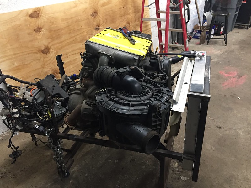

Build a stand I can start the engine on. Still need to add the radiator support, ground leads and wire harness holder. I'm going to fully assemble the engine so I can diagnose it before install. Hopefully the lump will just need a freshen up on some gaskets and clean the egr mess.
and then it snowed

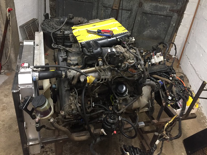

How will you deal with all the sensors etc?
Plug them in! Sorry couldn't resist.
Seriously though, I have all of the sensors and devices attached to the ECU and engine, not to mention the immobilizer, gauge cluster(for VSS) and the entire vehicle wire harness. I also have TechStream software that will let me diagnose any electrical issues, and test engine sensors. This engine is a late 2006, so it has no watercooled egr, and a simpler immobilizer system.

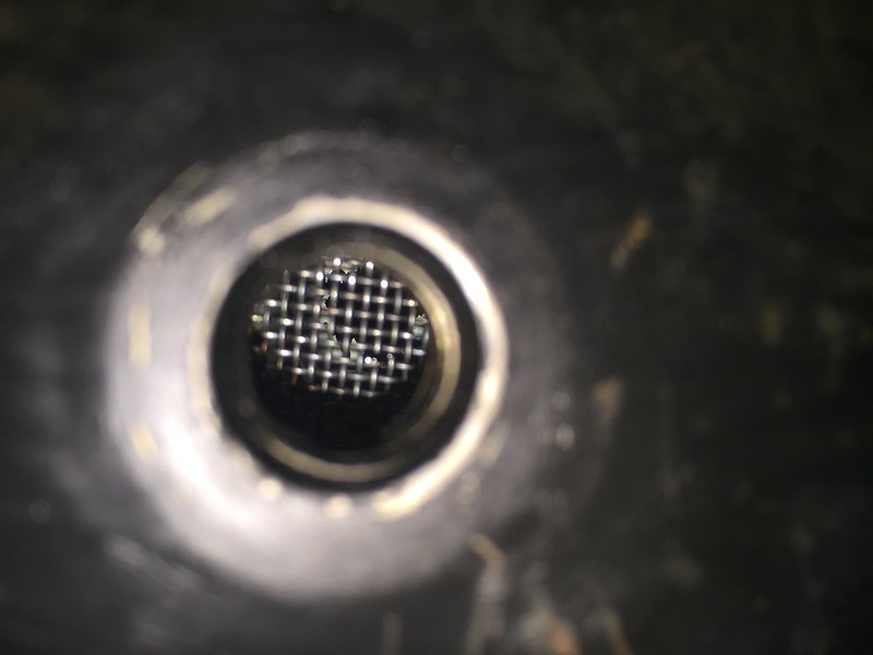

The good news is that I inspected the oil screen on the sump and it was free of any oil globs that can plague this engine from faulty injector washers.

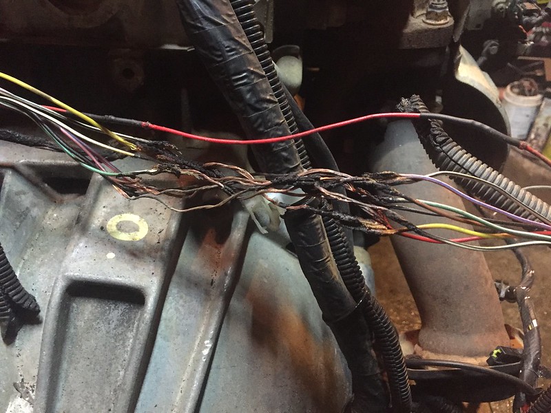

Found some damaged wires that were all burned together like they were resting on the exhaust. They have since been repaired
Checked the timing belt, brand new. This engine is very clean (on the outside), but I haven't scoped the pistons and cylinders. I'll get that once I get it running.

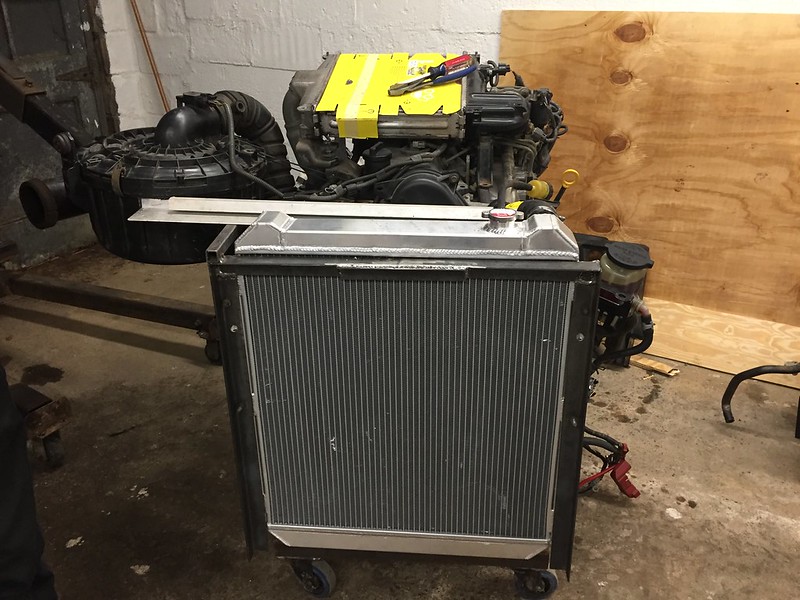

I hope to have it running soon, need to order a 1KZ radiator for a 90-94 hilux.

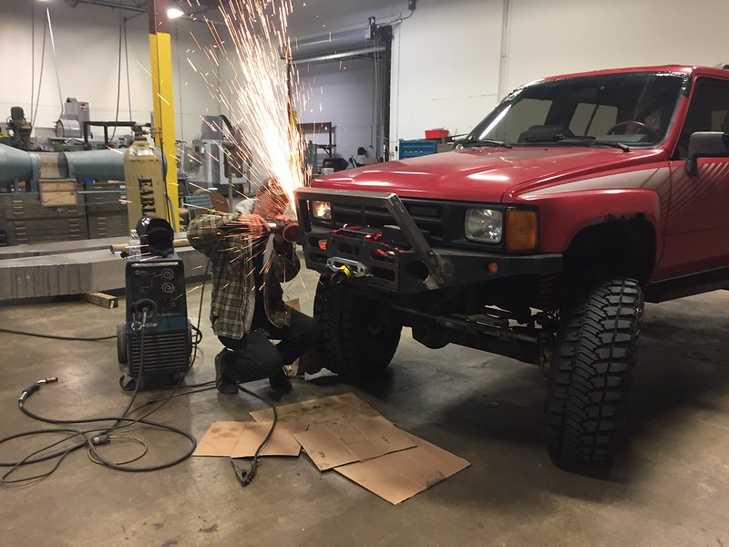

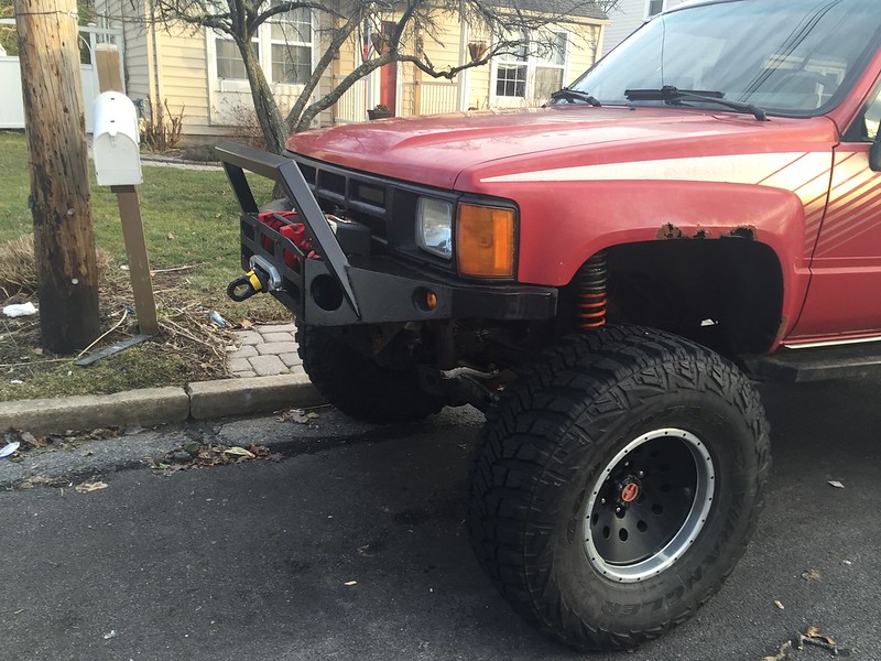

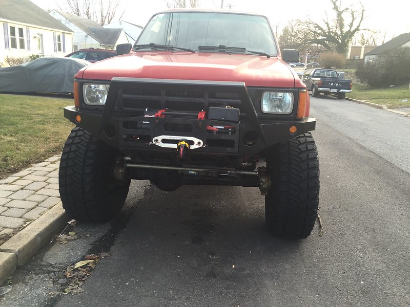

not an update to the engine swap but an update to the rig.
Built a stinger of sorts so I can judge the front end better, I can just see the top of it from the driver seat.

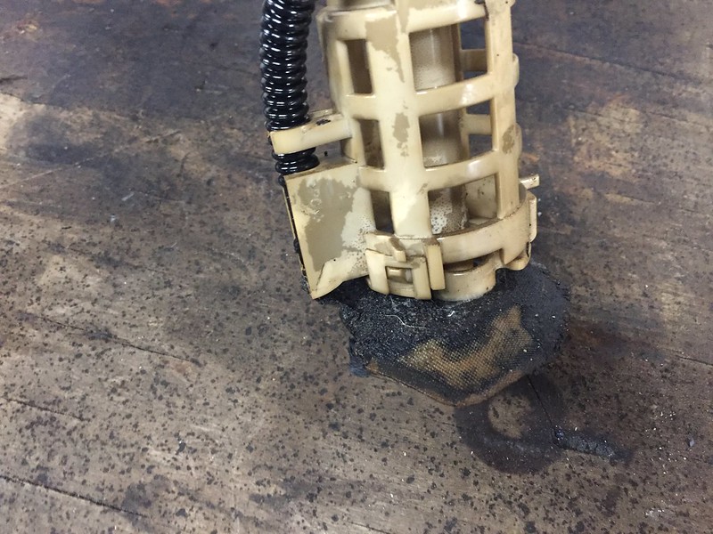

Starting work on the 1KD, inspecting the

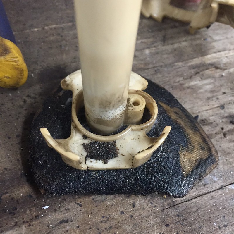

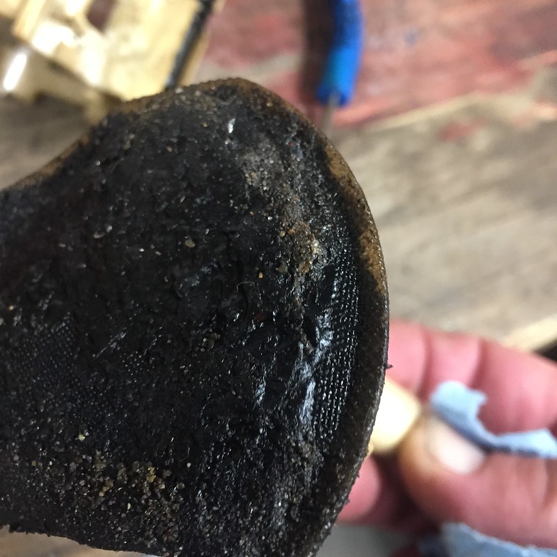

Filthy fuel tank sock from the Hilux

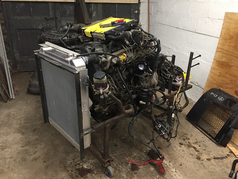

Might actually get this lump started this weekend.
Coolant added – Check
Oil added – Check
Steering fluid – Check
Intercooler and intake hoses connected – Check
Wire Harness grounds – In progress
Battery – Need
Fuel Supply – In progress
