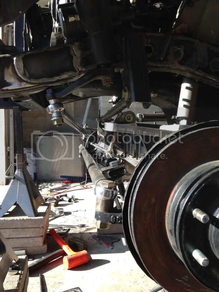

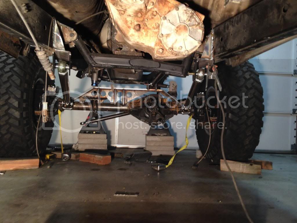

I guess maybe I didn't understand what you were asking. I'm running a dana 60 with a 3 link so I cut everything off the frame, plated it and started fresh.
My picture was more to highlight the same ruffstuff tower I modified which is so much less clean.
Not to hijack boogerz thread but heres some different angles of my 3 link/60.
Booger I wouldn't mind your help with some ideas to mount the rear shocks on my setup...

Yeah, good luck with the shocks back there. Pickup trucks have way better options. Im even considering cantilevers.
