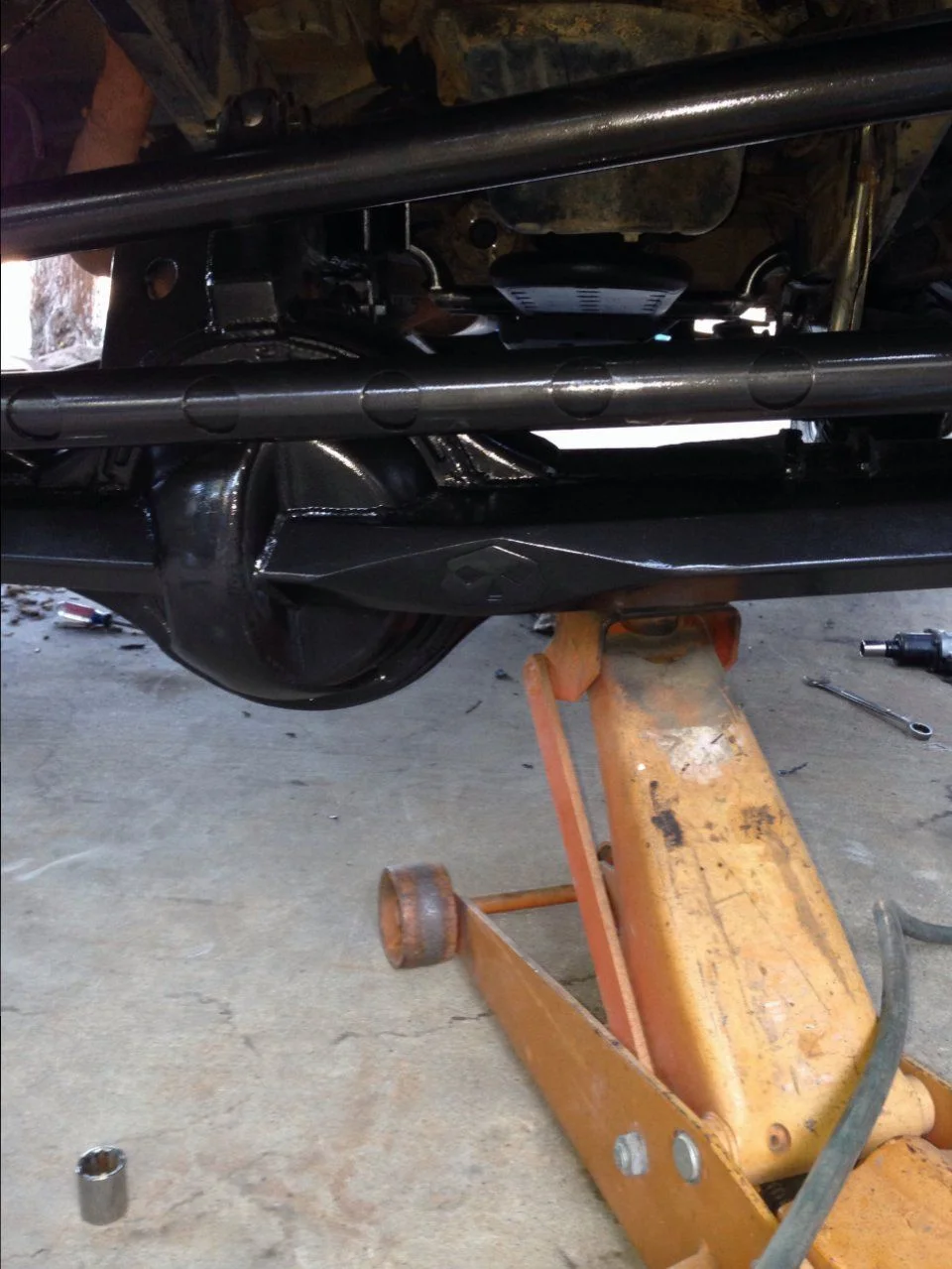

4340 longfield pieces
For rear reference, slee 4" non HD coil yields exactly 17" of available shock length (compressed) in this position(my shock is 16.25" compressed and safe).@ 29" extended begins to depart the coil bucket without retainers.
Pic kinda sucks, but the lugs barely touch the rear sheet metal (not touching the bumper as it looks)and the bump(3" extended is smooshed). 9" wheel, 4.5" back spacing.
I dunno if that helps. Cutting it all away (factory suspension)regardless. It's cancer as far as I'm concerned.

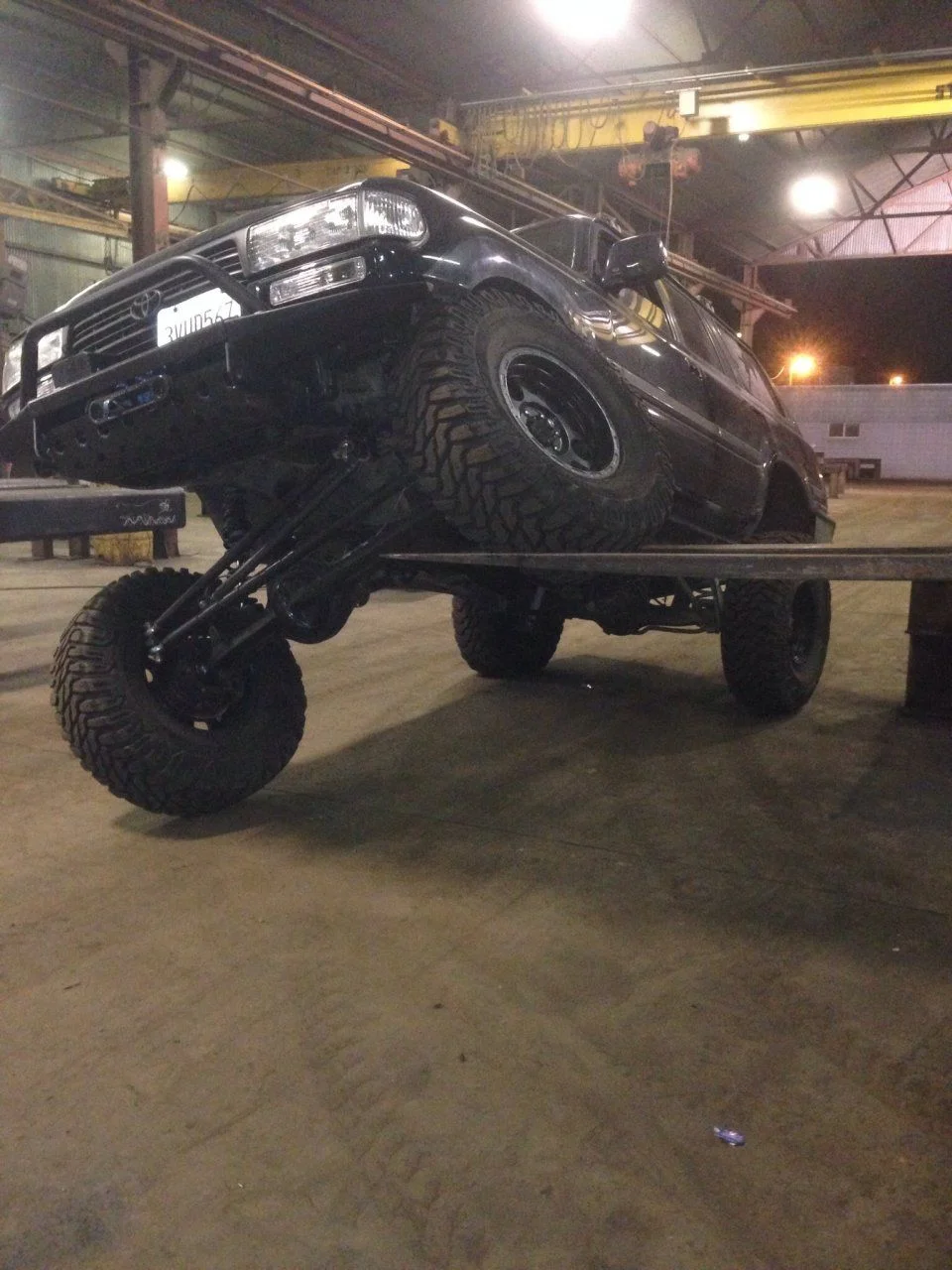

This thread is awesome. Gave me something to read in the hospital. Now if I wasn't so sleep deprived I might understand it. Love the sexy welding pics though.
That front stuff pic is gorgeous!
And, I skipped a lot of pages, but when you became a vendor does that mean you're for hire now!?!?
I dunno, I don't wanna cut up into the rear cargo area, but it looks inevitable... That area will be a pickup bed someday anyhow so I guess it doesn't really matter.
I need to crucify the 80 body wheelin it so I am 'forced' to do this
