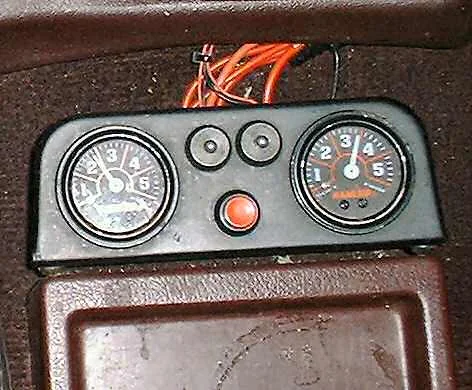

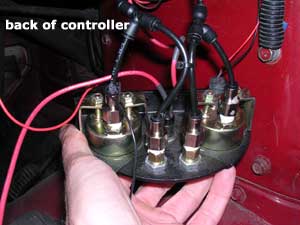

in-cab controller - I put the in-cab controller next to my CB where there just happened to be perfect space. under the dash and out of the way so that all of the air hoses and wiring can be hidden (as there is a LOT coming into that controller).

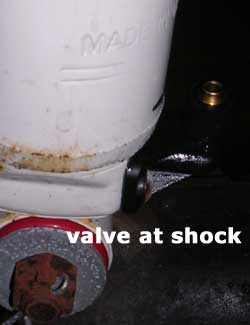

shock valves connects - bolt on after removed the knobs, be sure to use ample lube/grease to make a tight seal on the o-ring as that seemed to be a leak source for me.

Thus far, I only have local road usage as I just installed it yesterday during the week. Initial impression is it is a pretty rocking tool and at this time, I am glad I did it. quality seems solid. Controller seems well built (but exposed back side so you see all of its guts), the hose is stiff and hard plastic - not a flimsy rubber hose that easily kinks or folds/bends and there is like 90' of it - I had maybe 45' of that left so only used about half of it, pump seems solid and had rubber bushings to isolate it, etc. System is SO easy to use. press a button to air all 4 shocks up at 1 time (about 10 seconds), then push an air release button for the front or the back (or both) to dial in the number you want to roll at. slick as hell and works. I look forward to really using it offroad (maybe drop the pressure to hit the washboards at high speed - pump up for the road - middle ground for general off road) all from the comfort and arm reach of the cab. I dig the concept and will use the hell out of this.

3. surprisingly, in my case, 100% of the leaking in initial testing and install came from the copper fittings at the in-cab controller - not the hoses or t junctions! so keep that in mind and start there and put ALL of your adaptors and air fittings on while the controller is out of the truck and on the work bench.
4. use a small bit of motor oil on the tips of the hoses before pushes them into the quick release coupplers. the rancho guys told me this helps swell the o-ring in there you cannot see and helps with the seal.

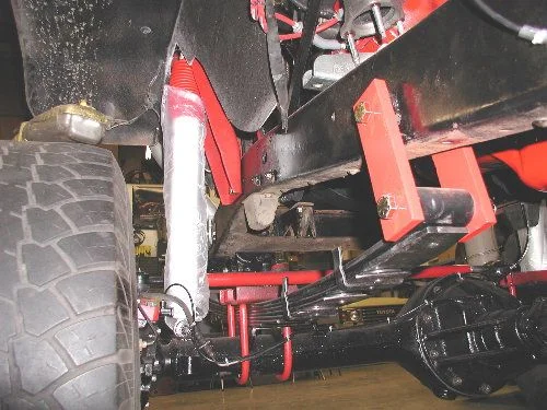

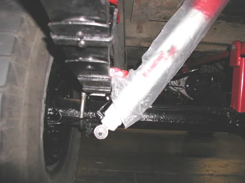

I zip tied the lines to the brake hoses and sleeved the lines with rubber hose where it enters & exits the frame rails.
nice install on the firewall. I also sleeved the lines to protect them at critical rub potential spots as it is pretty stout tubing.
are those shock condoms? :)

I'll tell you right now, lose the boots! What finally took out my shocks was RUST under the boots! It took 5 years but they rusted all the way through and started leaking fluid right where the zip tie was and became worthless. :frown:
