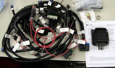

MEFI4 computers are commonly used in sand rails out west here due to their ability to survive the elements so well. You can buy a MEFI4 harness and a used computer, add in the necessary sensors that you are missing, and then have someone custom tune the computer for you. This could save you months or years of searching for a NLA NOS setup. When i bought my new harness foe my sandcar it was $700 4 or 5 years ago.

I suspect this harness would work on the SBC even though it says its for a 502.
Also, i know there are at least two versions of the MEFI4, the 4a and 4b. One is preferred over the other, but i cannot recall the differences or why the preference.
There are likely over a dozen ways to add IAT and 02 sensors to make the engine run in closed loop, but they are pretty much all going to involve a new ECM, Harness, and tuning. Holley has some self learning/tuning options that are probably in the $3k range, but when youre looking at that kind of money, an LS swap isnt much more money if you can find the right deal. I sold a nice LS1 with mefi4, harness, and fuel system for $4k a couple years back when i upgraded the engine in my sand car.
Yes, it is a harness only. The plug ends on the harness will be the same regardless of engine displacement. I was suggesting that harness could be used in conjunction with a used MEFI computer, which you would also need to source on the aftermarket. Finding that NLA NOS kit is certainly possible, but you could build it yourself if you wanted.

Try this place , painless wiring did not care about their mefi kit and told me to call them if i need assistance
These guys are local to me and who I bought my standalone harness from for my sand car. They are one of the top motorsports engine builder/parts supplier in the area. They do marine, street, and off-road engines. The guys at CBM know their stuff.
