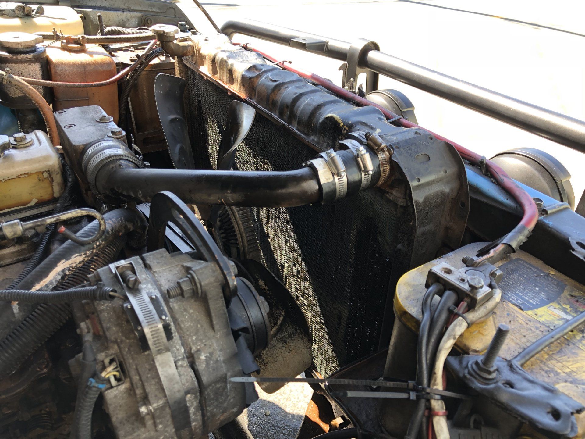

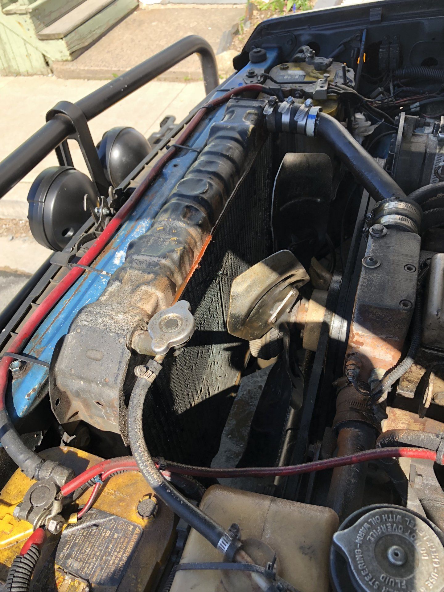

Here are a few pics of what I have now. If it looks like a different shape than stock that will at least tell me it's not from another cruiser model:

Thanks for the link, I'm starting to think someone took an HJ60 rad and just swapped the outlet on the bottom.

Based on some basic research, kind of looks like it could be a a BJ series (BJ60 or 40/42) radiator.

Well, I happen to have my HJ60 rad with me at my shop. Here are the pics....yours definitely looks stock, and may have even started life as an HJ rad. Luckily, they are still available new from Toyota. Just ask @beno - he just hooked me up with one to replace this one...
