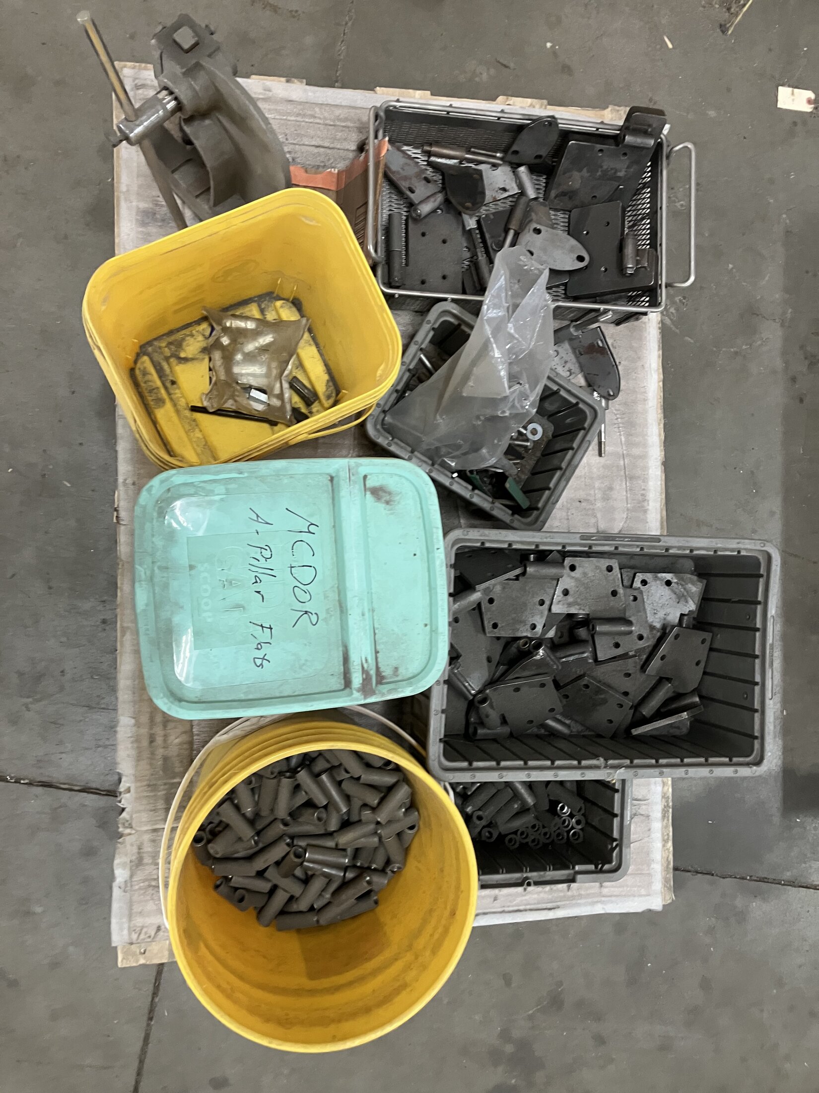

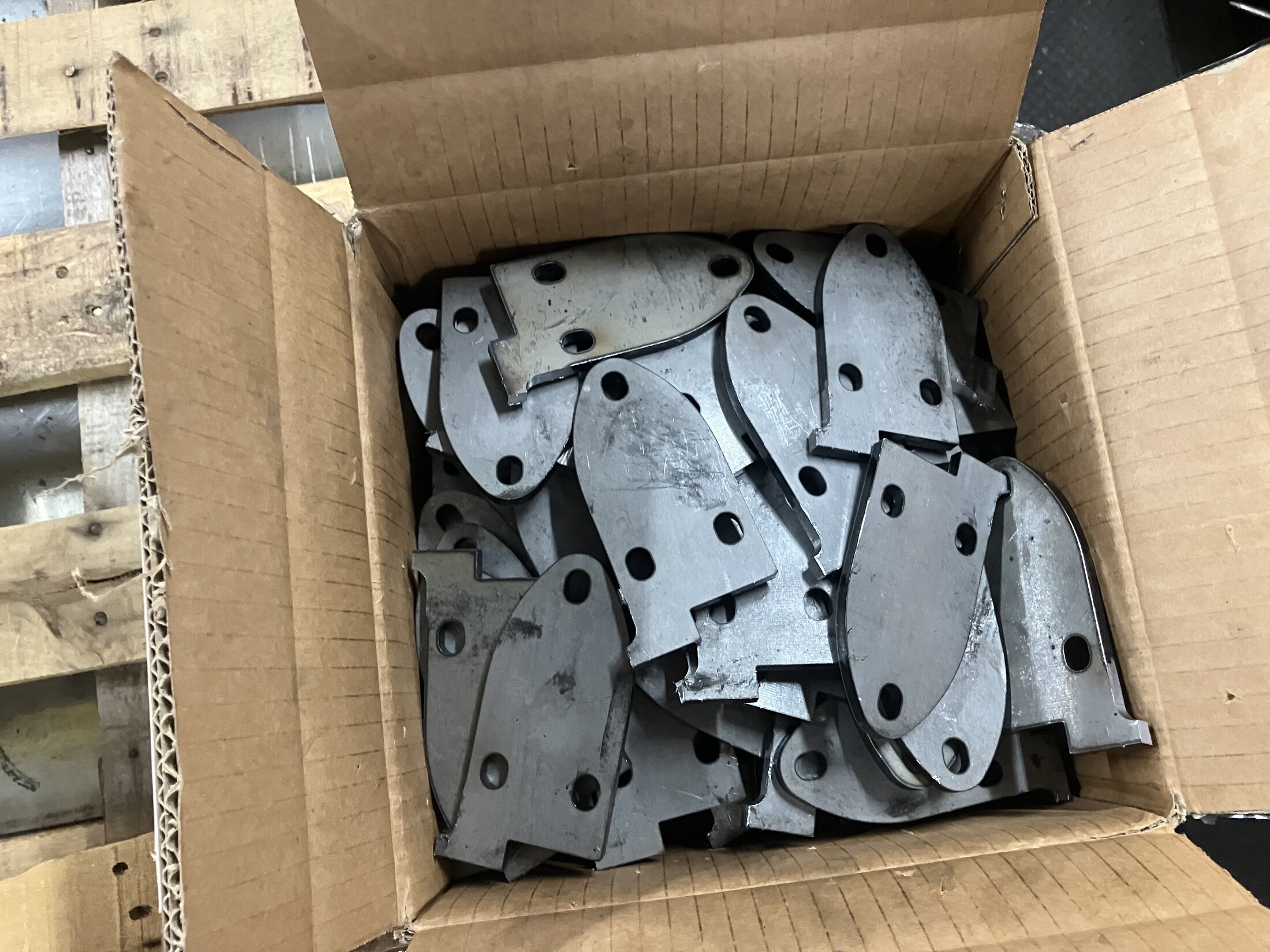

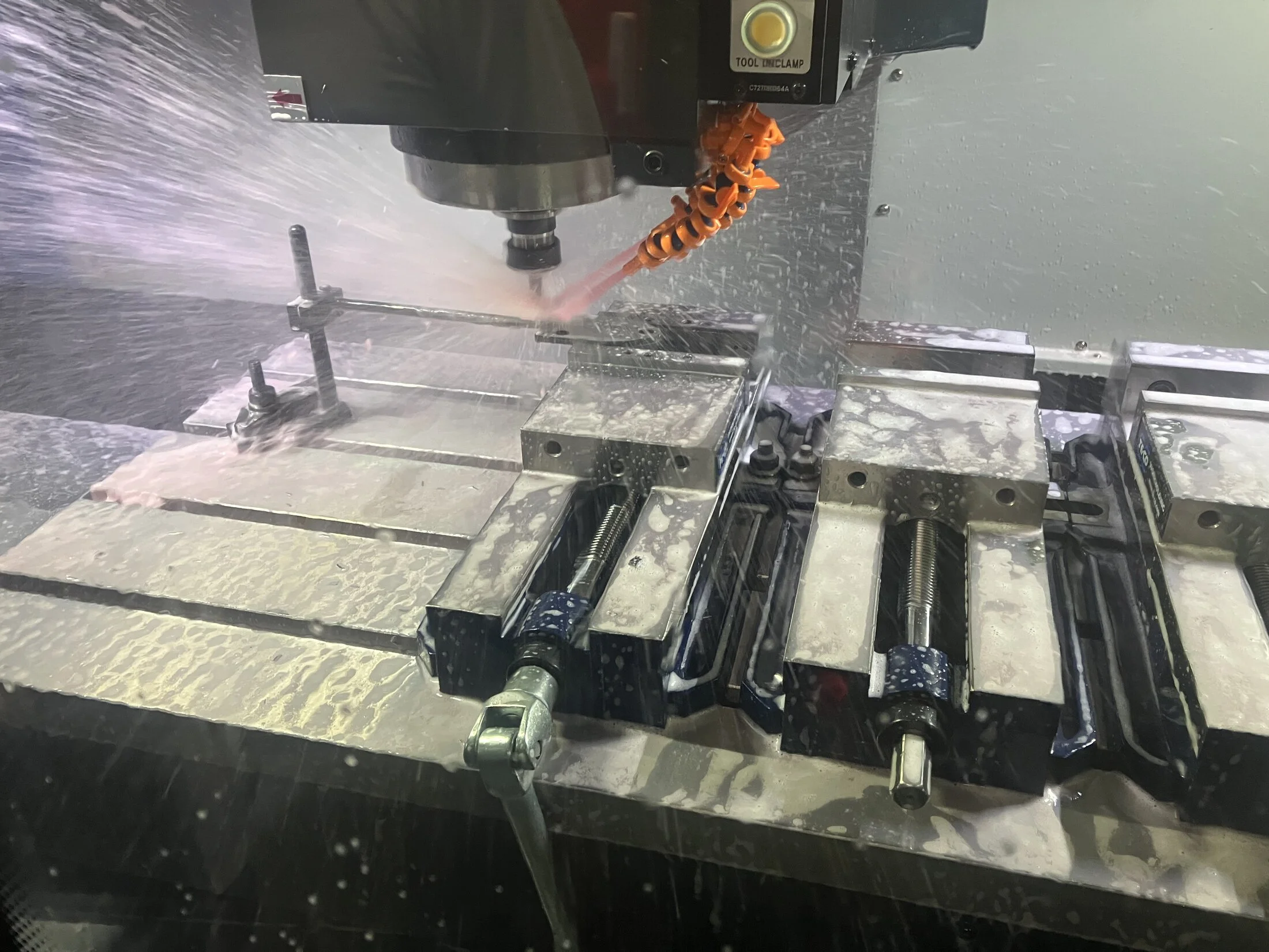

I just stopped by the shop during my morning break to check on the hinges. They are actively machining the door halves as I write and will be starting the weld process soon after.

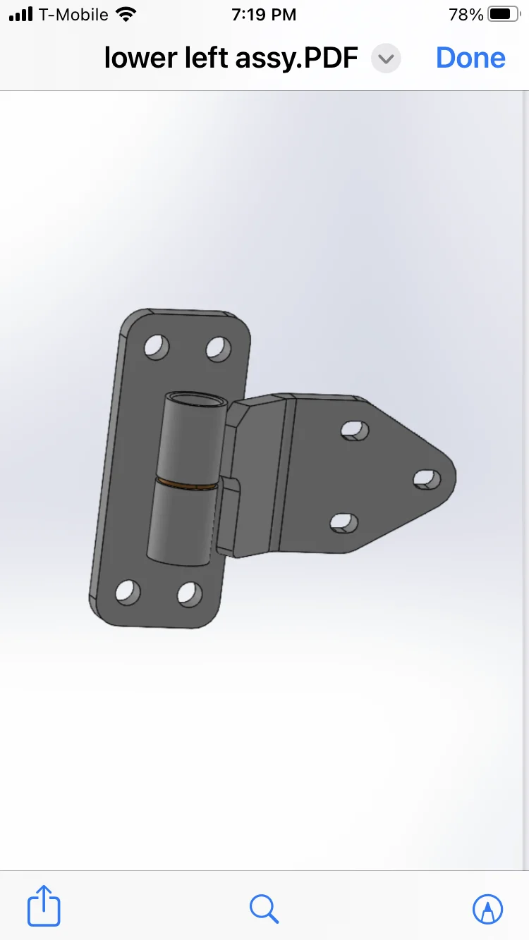

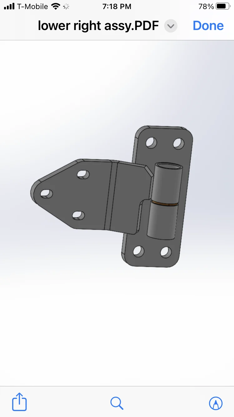

I wasn’t feeling work projects too well today after a long (4 day) super drill inspection practice so I putzed around in Solidworks trying to relearn some functions. Got some good help and made some progress with the ambi-hinge bottoms.

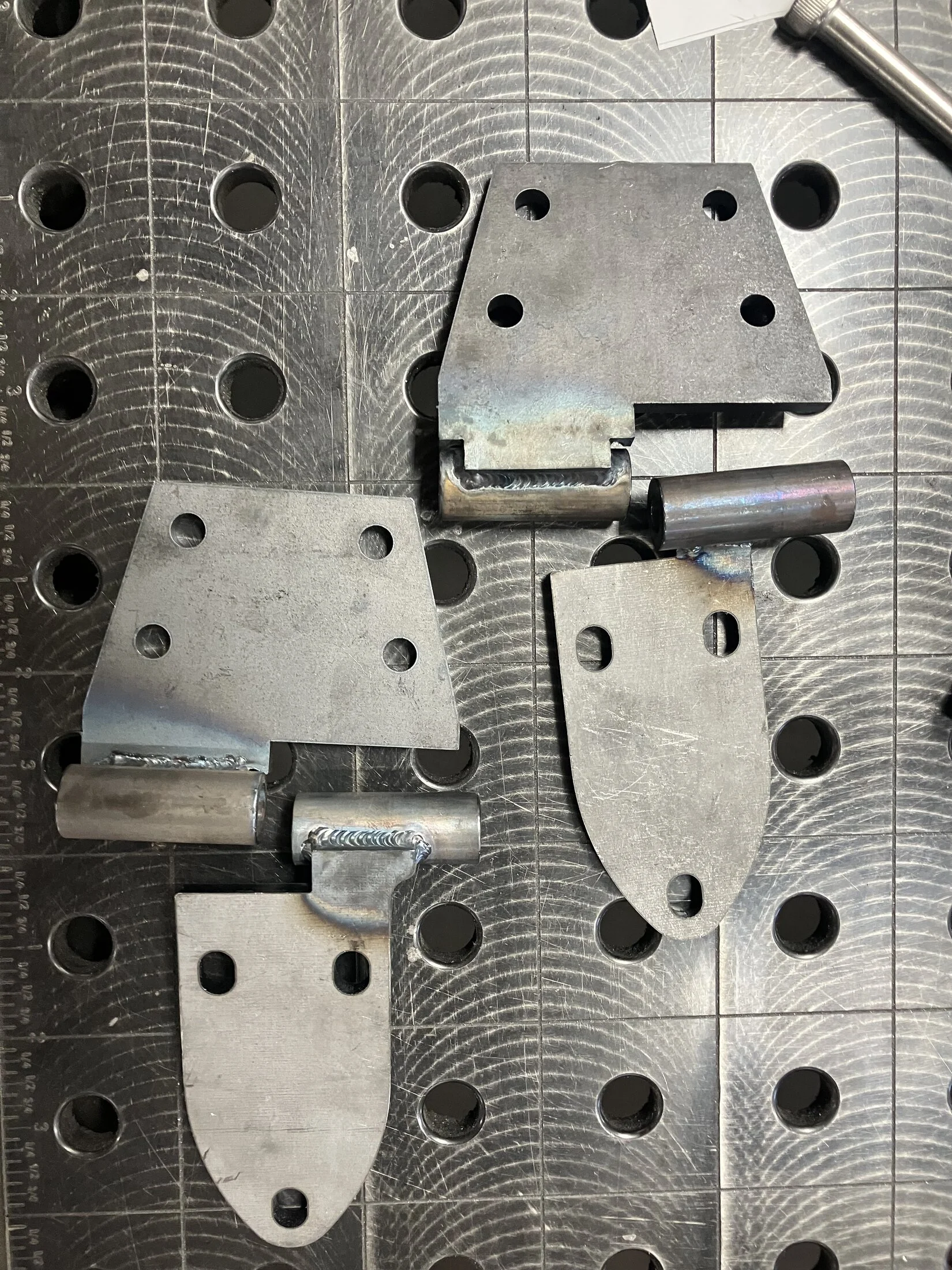

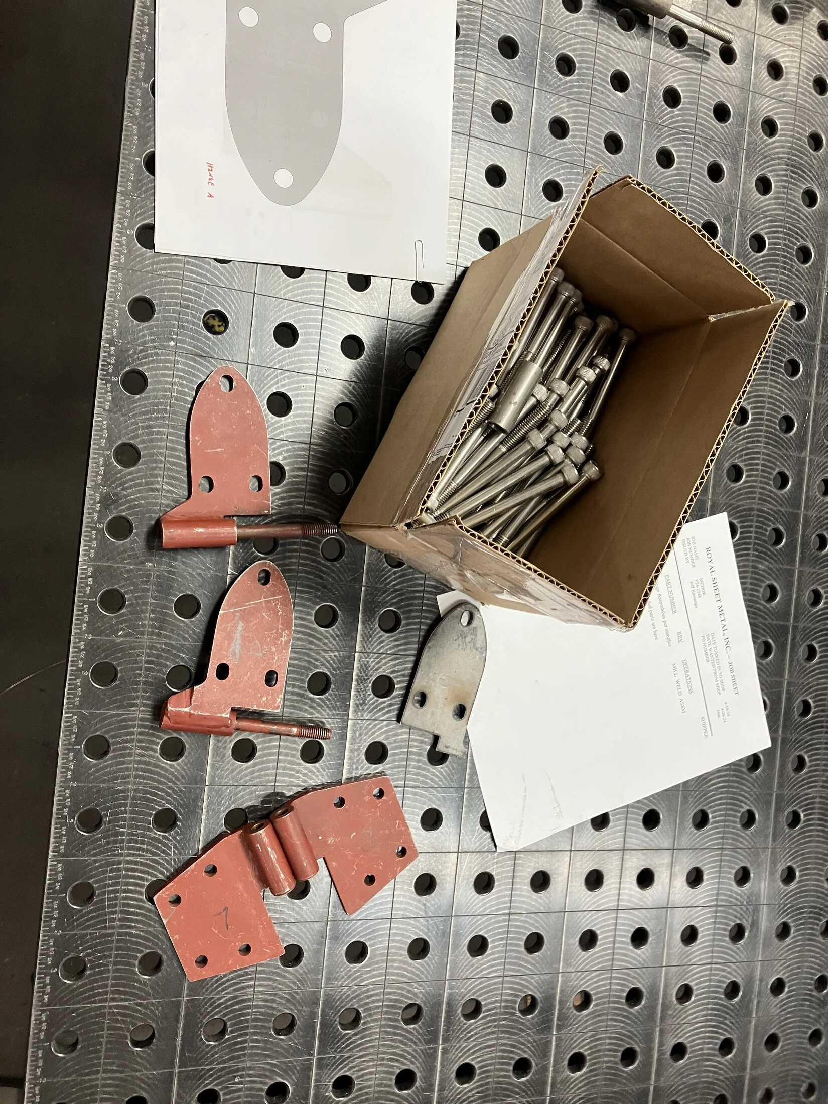

I stopped next door during my break to go over things with the welder-setup and fixture stuff. I’ll go de-burr a bunch of flat stock after work so they can get welding, show them what I’m looking for.
The old red primer parts are some I built myself years ago and sent to @landcruisnman for his fixturing, and will be the reference for the new stuff going forward so all old and new parts are compatible.

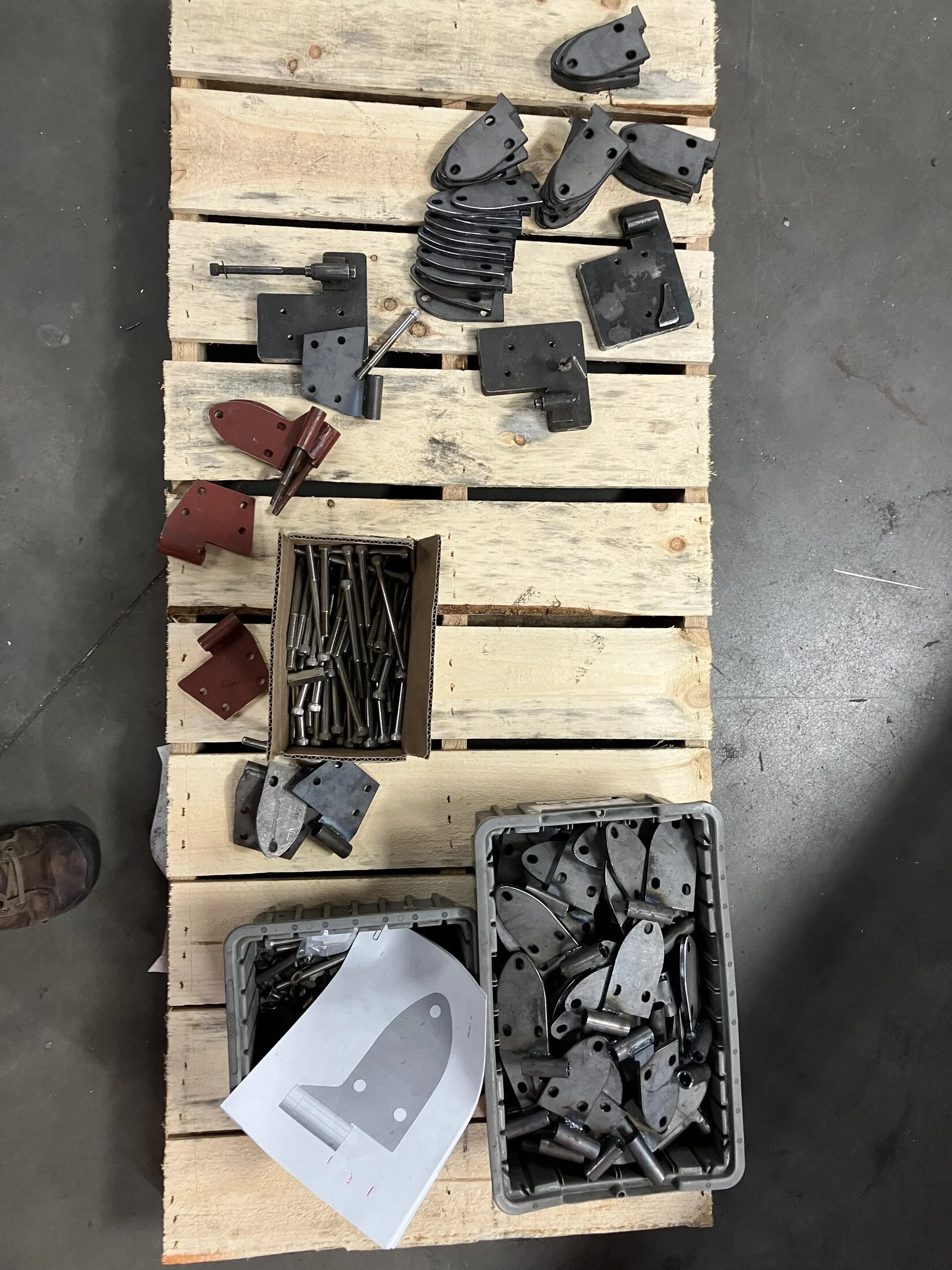

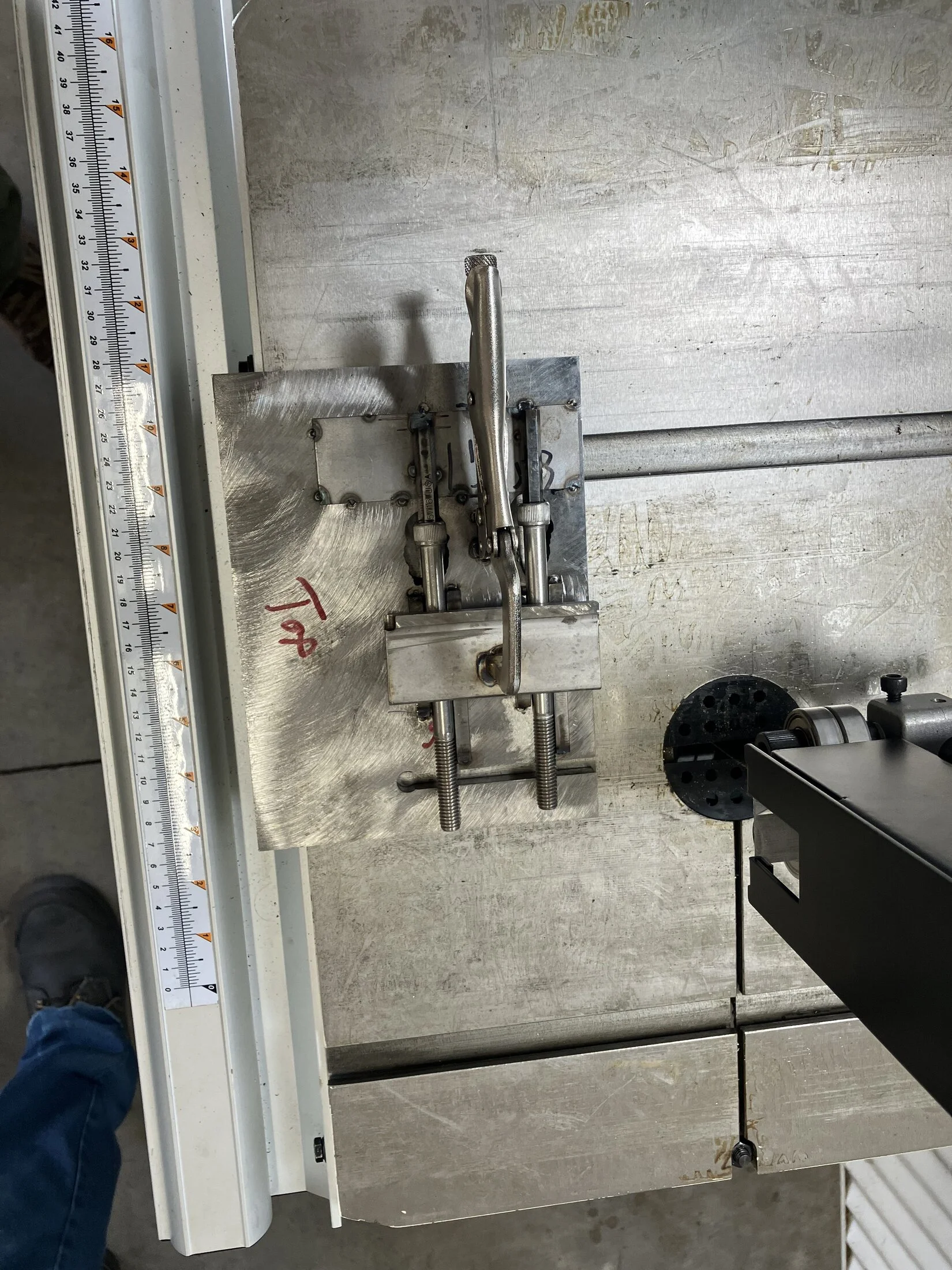

Chatted with the shop this morning. They have everything that needed welding - welded. My project gave them an excuse to finally buy a new shop tool. They’re picking up a bandsaw for trimming the bolts to length. I use long bolts to get as much unthreaded bolt in the bushings as possible.

The shop has their new band saw and is building a fixture to trim bolts. I’ll stop in tomorrow to check on progress.

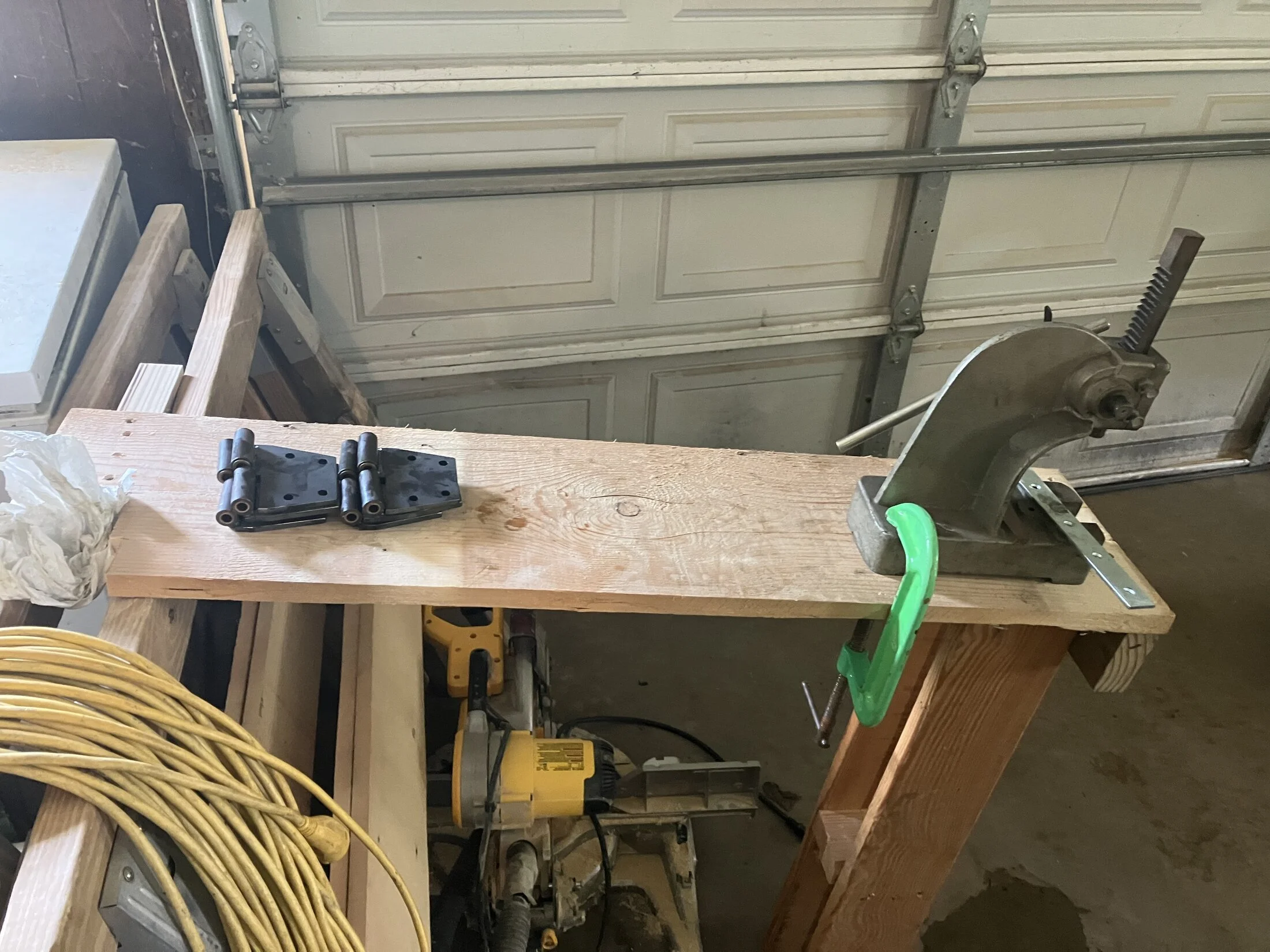

I started dressing threads on my last batch of bolts to allow clean pressing in the door halves. (When the bolts are made, the thread OD ends up bigger than the unthreaded shank.)
I’ll finish them on my breaks tomorrow and deliver them to the shop next door and pick up a bunch of door halves to start pressing already cut bolts. I have some bushings to press too and then I can start getting some kits together and finally start shipping.

I start my 3 mo of MIL orders later this week, but I’ll have my laptop with Solidworks to keep working on them. My son has a 3D printer to help me do some models to check with trucks at a local dealer.
