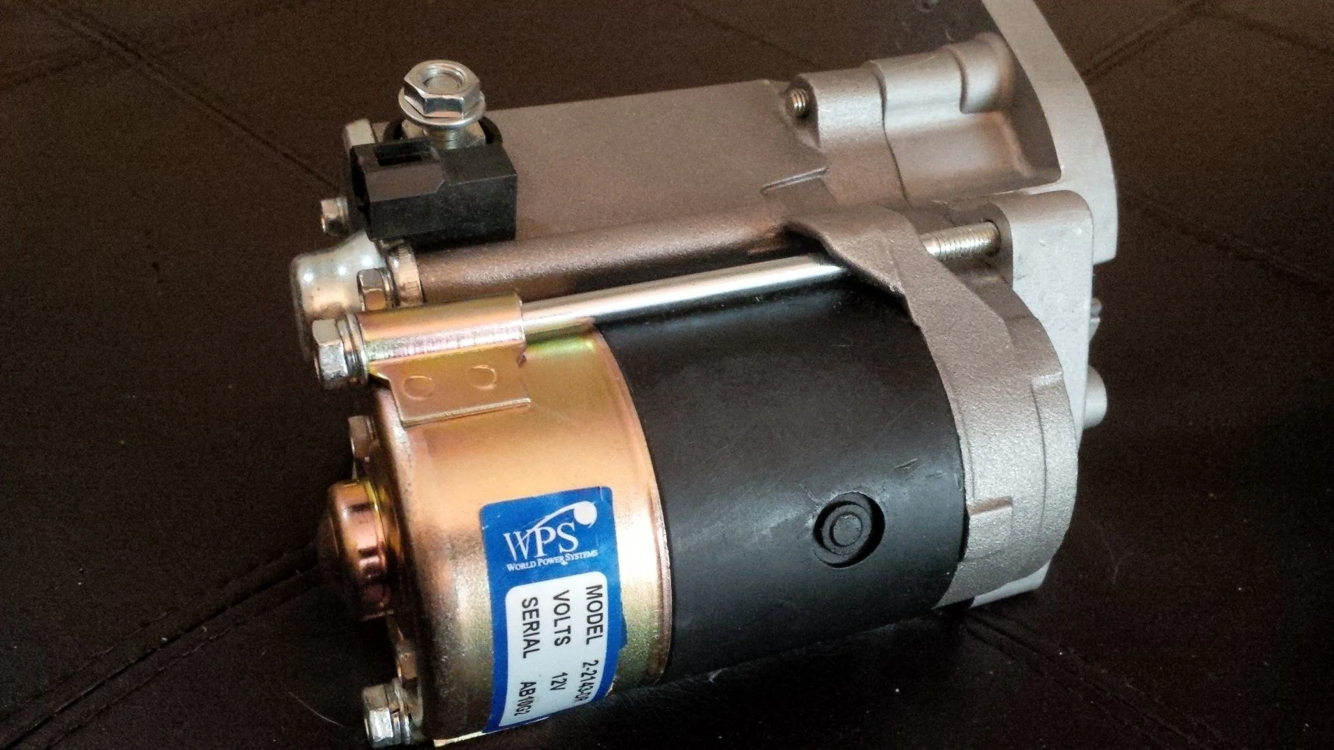

The old starter in my '76 FJ40 has been flaky for quite awhile now. It will usually will start the truck, but sometimes just makes a x10 slower than normal turning sound before maybe starting it. So, I decided to try one of these newer GRS starters:
It installed just fine, and it will start the truck, but makes a crazy loud/whiny sound in the process. I knew it would sound different, but this is crazy loud. It sounds plenty strong; way too strong really. Once the truck is started, the sound somehow gets even louder and faster before I hurry and turn the key back.
Did I install it wrong somehow? I attached the positive and negative battery cables, and the one cable (ignition, I assume) that was connected to the old starter. There were no shims on the old starter, which looks OEM to me.
Or maybe I just got a bad unit?

So, I tried a 2nd starter and the results aren't much different from the first. I ran a new ground strap, and added two more grounds, but that also didn't seem to make much difference. The 40 starts up great, despite all the noise. ¯\_(ツ)_/¯
