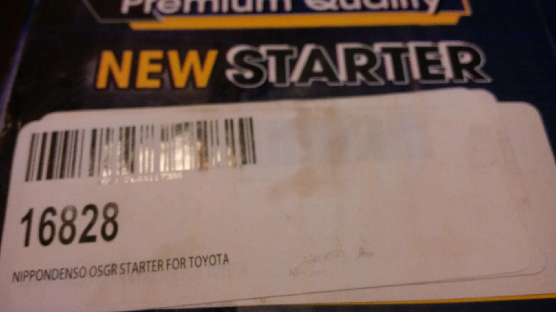

First Impressions

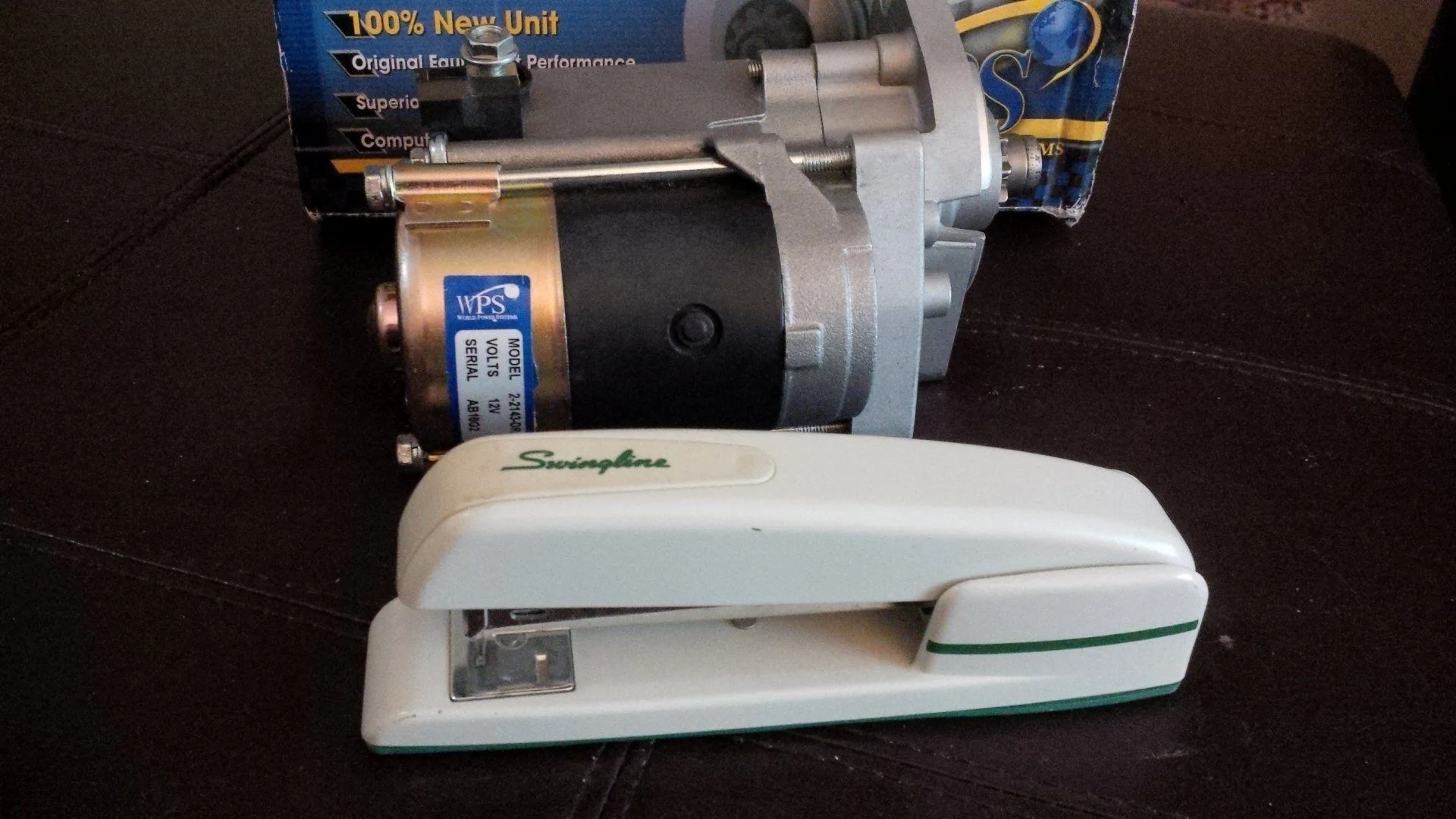

1. The GR unit is brand new and very compact compared to the OEM Circa 1978 starter with external solenoid
2. The GR unit is manufactured by WPS (World Power Systems) http://www.waiglobal.com/wps.html
3. The box has a NIPPONDENSO OSGR STARTER FOR TOYOTA sticker
4. The GR starter has a WPS sticker on it with the following info.
MODEL 2-2143-DR
VOLTS 12V
SERIAL AB10G2
5. The size of the GR is no bigger than a small Swingline stapler and about half in size of the OEM, the weight is 8.5 Lbs
6. There's absolutely no indication of country of origin or manufacture
7 The quality appears to be an 'A'
8. The body is made of aluminum that's nicely finished and free of any burs

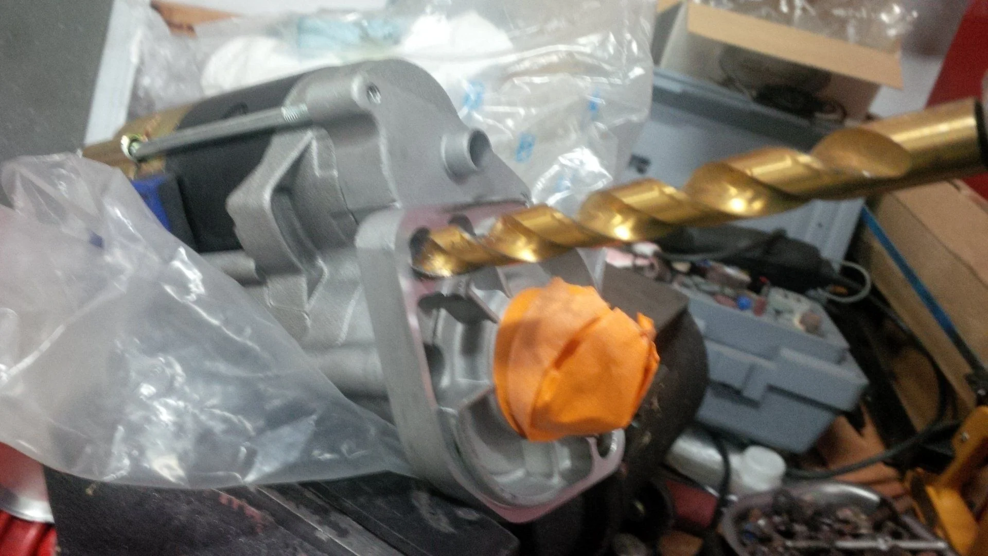

Installation
I finally had some spare time to install the GRS and this is how it went.
Removed the old Dinosaur, heavy sucker! The new GRS is literally half in size.
full

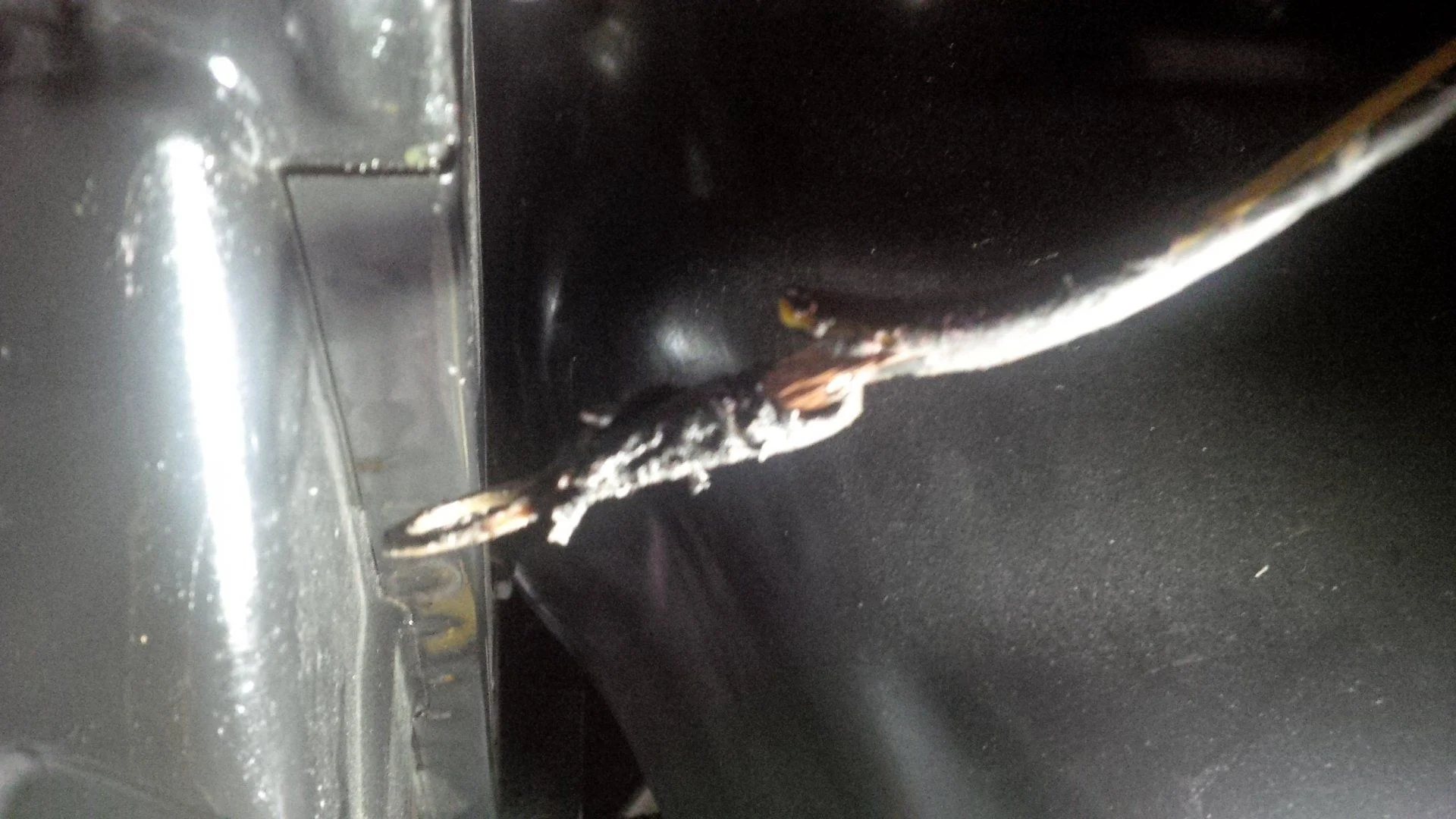

First issue was a melted ground cable
full
Cleaned some gunk residue from around the starter opening
full
Installed upper bolt 18mm, another issue, cable to battery is now too short because of the GRS small frame
full

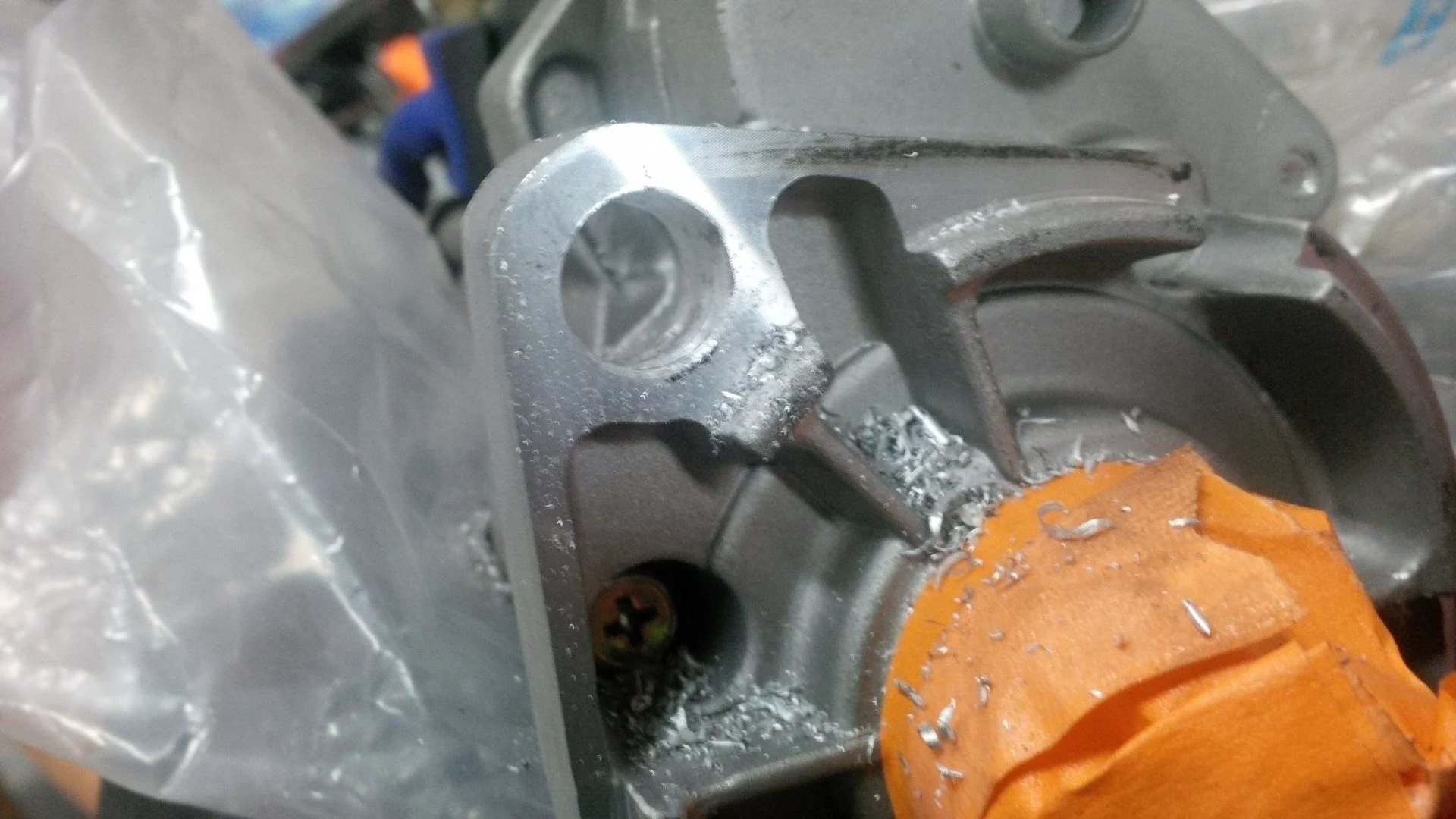

The lower bolt (19mm) did not fit in the hole
full
Elongated existing hole to fit 19mm bolt
full
full
Bolt fits perfectly now
full

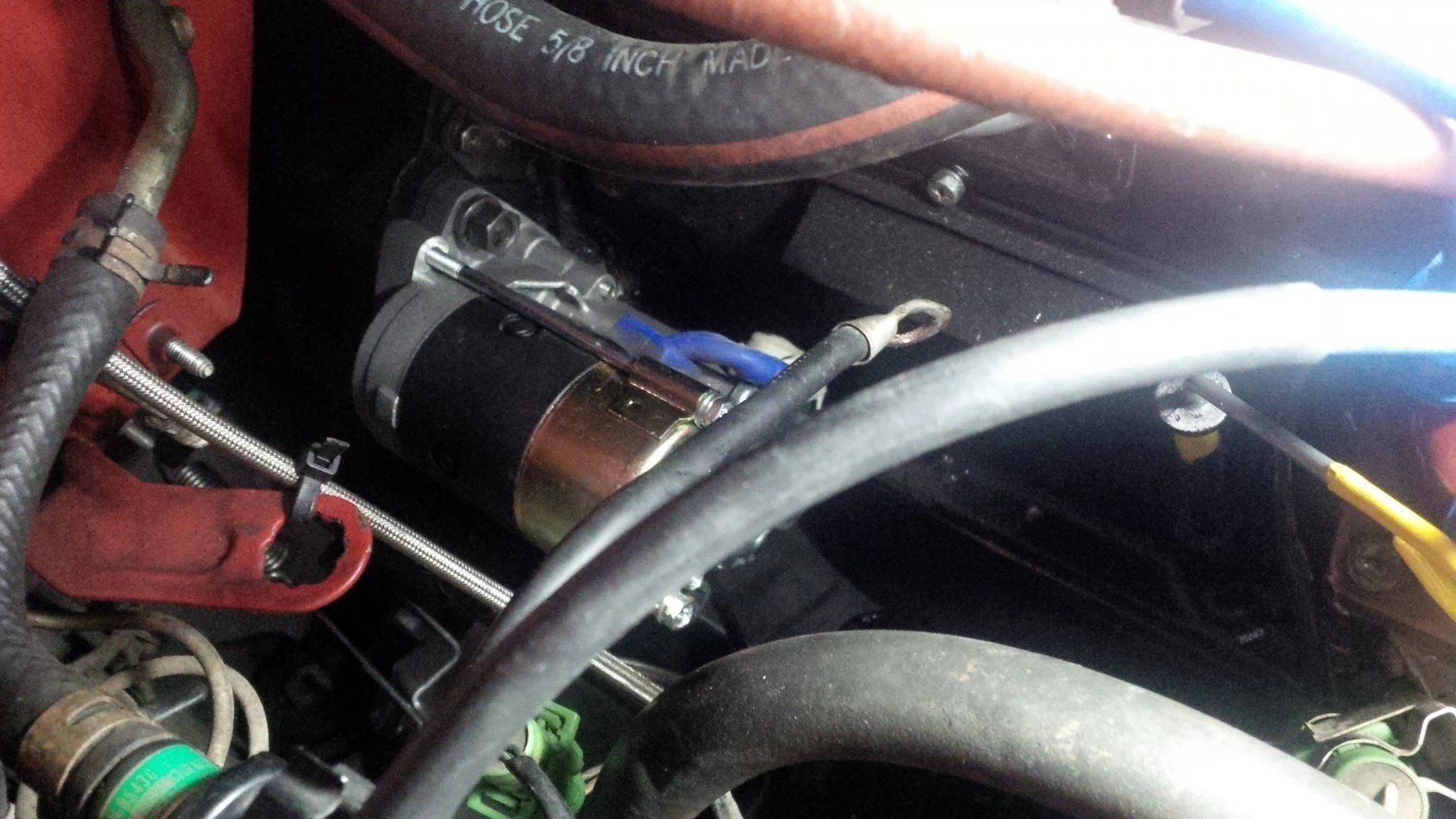

GRS installed
full

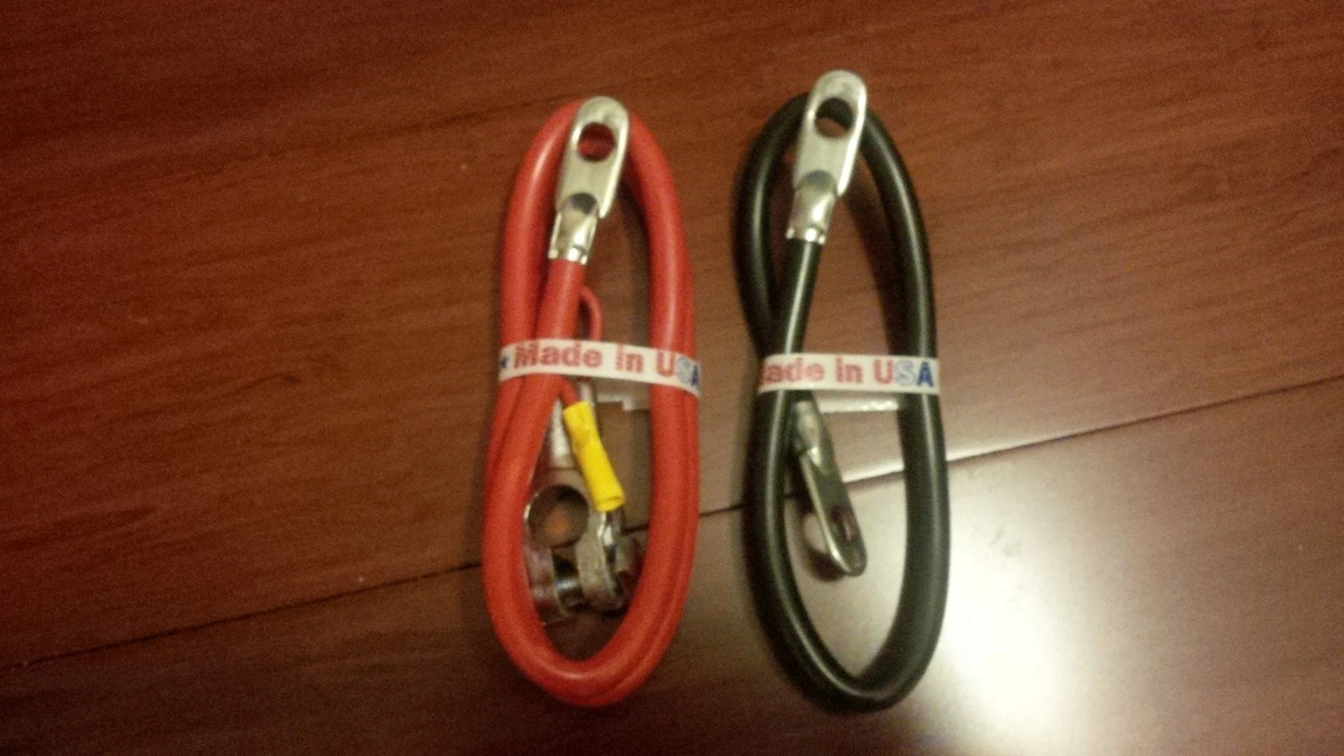

Next I'll be installing new cables and making the final electrical connections
full
GRS installed
Electrical Connections
full

Mike - Nice work. I'm interested in the final outcome and review....As for having to drill one of the bolt holes, first I've head of that. :hmm:
