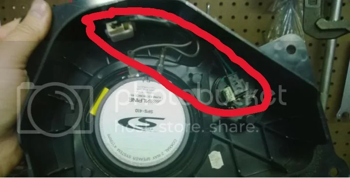

@coinball, any chance you can tell what normally goes on here? OEM tweeter wiring gets spliced into woofer wiring?

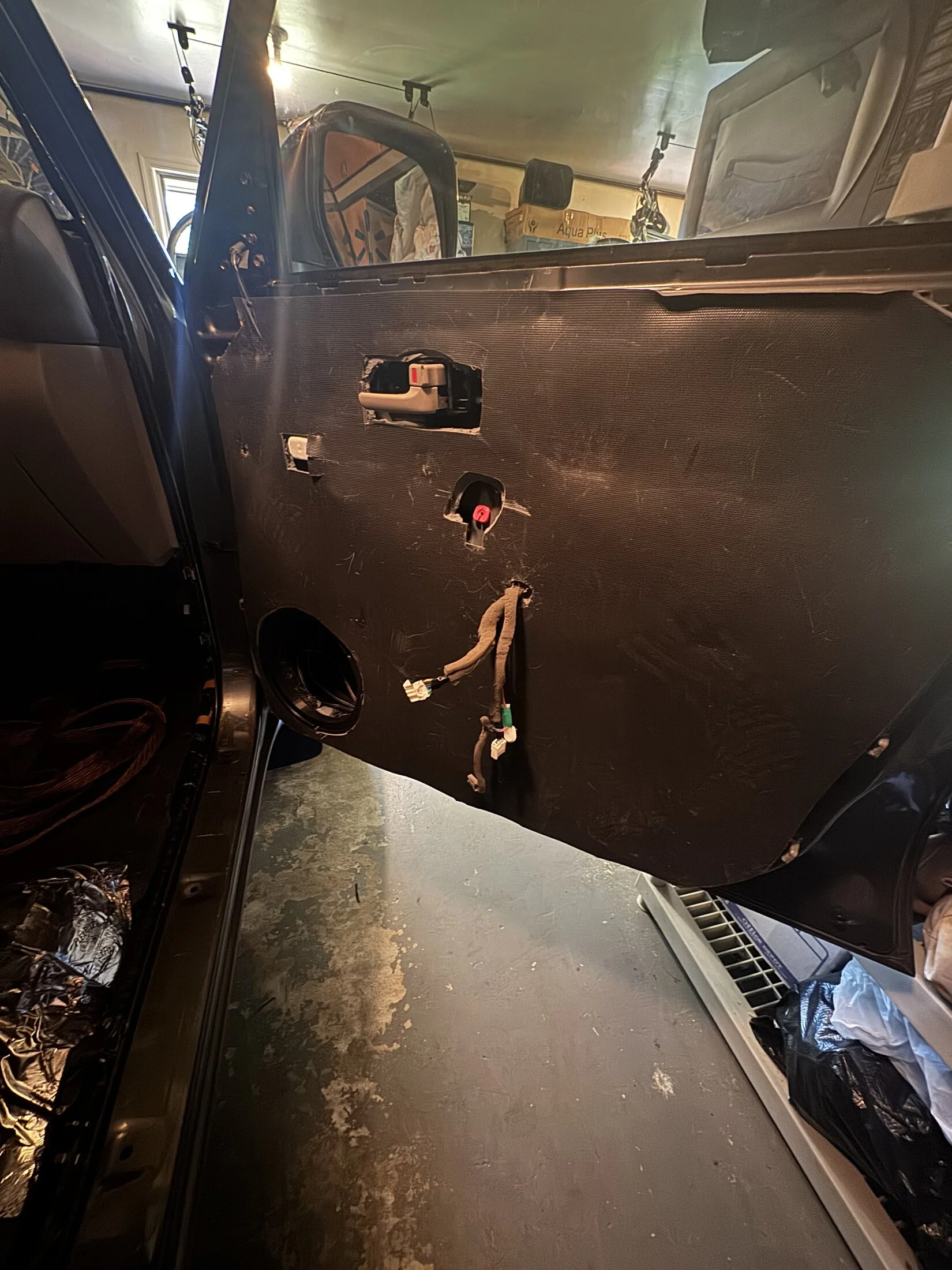

Made the mistake of not appreciating the work fitting bigger tweeters would take! While these will be nice and on axis, I know I may be introducing reflecting wave issues, by pulling it off plane with the door.
Terrible pic, but upped my sound deadening game this week on all 4 doors in prep for a major change. Added more damping, butyl rope along the bar in doors, foam tape under rings @Berkut10r made me, then butyl rope around those, sound absorption in doors, MLF curtain back on, then layer of sound absorption between door and door card, and hit resin on door card to be able put on some damping. X4!

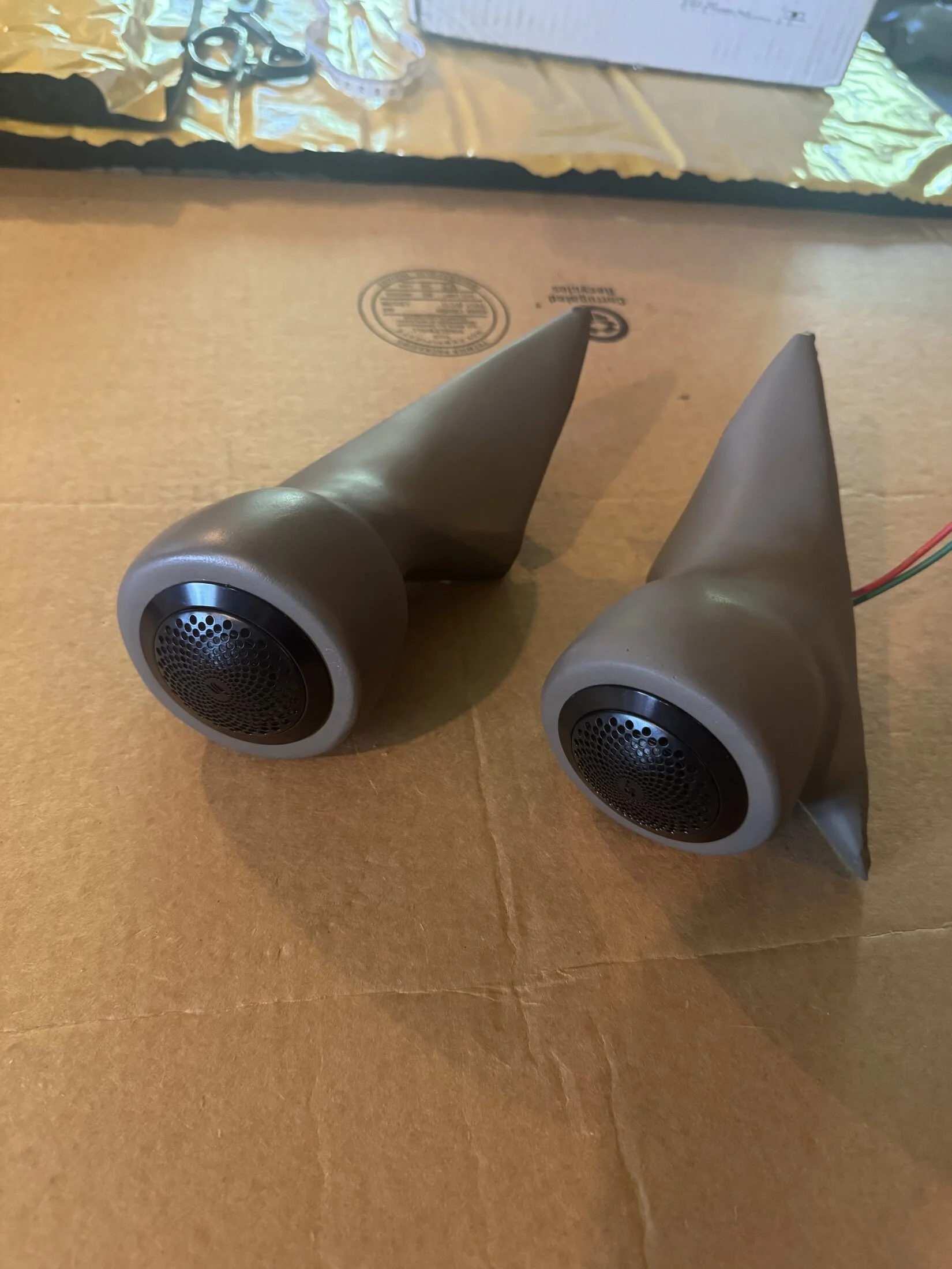

Any pics of these roughly installed? Curious to see how much they protrude beyond the dash.
Those are the SI tweeters, right? Cutout is 52mm / 59mm OD?

Anyhow, Killerbox has gotten tweeter pods from me, according to him they are a Go. @rbrave since you have been on the sidelines waiting, you will get a set for free. I deeply apologize for the absence.

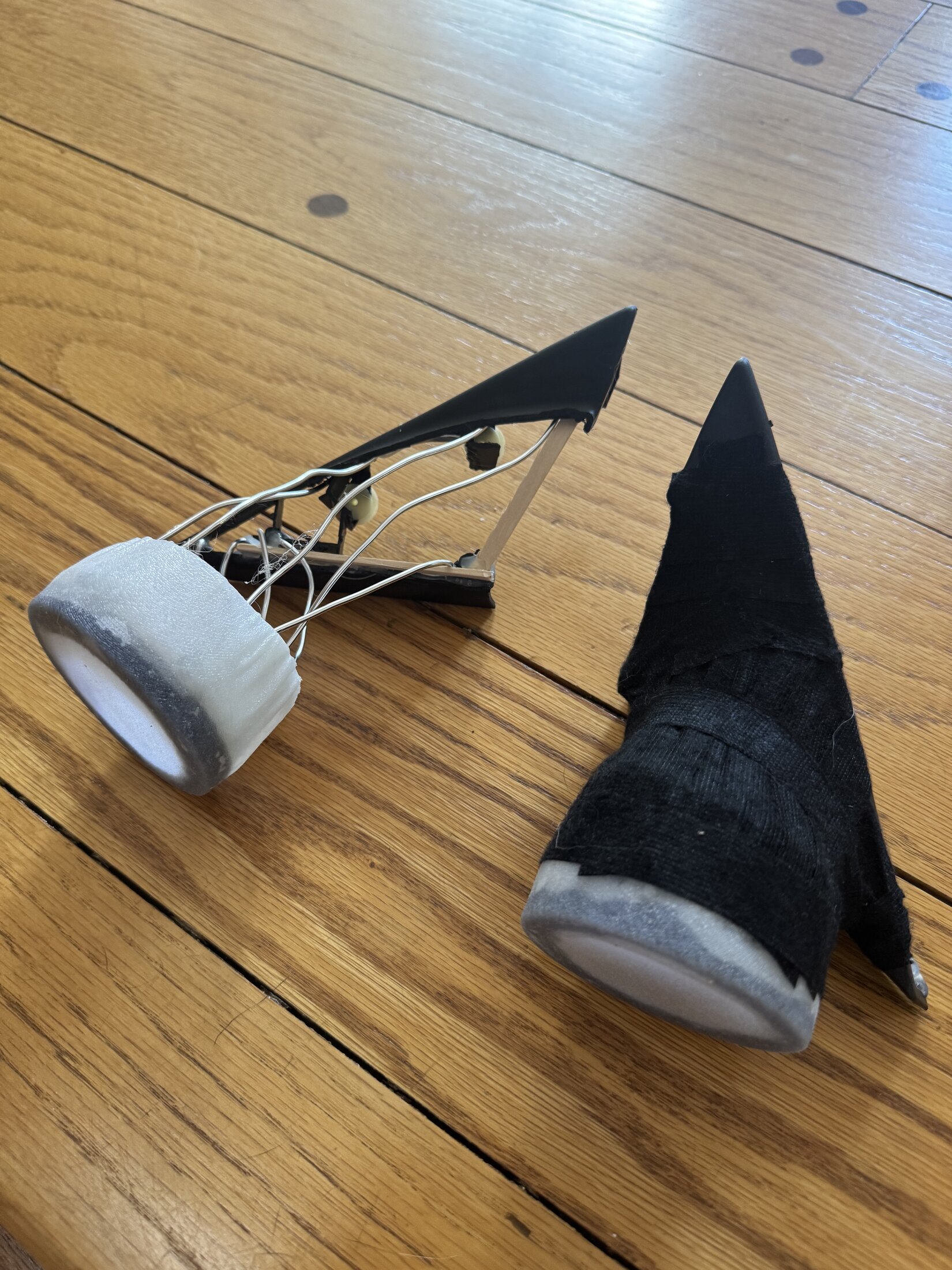

So I printed adaptors for members of this forum in a plain bracket and units with a "hood" on them to prevent speaker getting dripped on if your door seals fail.
I have attempted enclosures, printed several units with success. Fit is great but nobody responded to my call for a picture or explanation of how the rear speakers are wired in. If I release an enclosure into the wild, it will plug n play only. Size of the speaker will have to remain a 5 1/4 or something like Morel Virtus, which have virtually no ass end, would have to be used because the cavity opening is rather slim in the door itself. Tweeter will have to be limited to around 20mm or so.
They also have "baby" variant of their original tweeter, it is 22mm. Cutout is 42mm for them.
Ah - I hadn’t noticed these were now available. They look like they’d fit into a minimally modified stock sail panel pretty cleanly.
Here is the rear passenger speaker with enclosure from my 1999 LX470 with Nakamichi.
View attachment 4027297View attachment 4027298
David, thank you tons for these photos. I am not 100% familiar with 98-2000 setups, so I will ask another question. Is this your setup?
