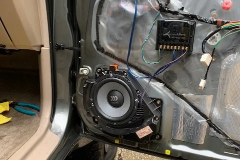

My front speakers came in their own enclosures, which (because of the opening in the door) I had to cut up to fit what you see. Will your 6.5" adapter "work" for this or is my confutation unique? 1998 LX470
I do have a mock up of the rear plate that looks like that, my fronts are a normal triangle shaped contraption. I would take an enclosures over free-air anyday, if the specs are on your side. Those Morel you have, are one of those units that are happy in any enclosure though.
Problem is is that the morels are deeper than the enclosure (and the original Pioneers), so the whole "back" of the enclosure had to be cut out. Only the "face" of the enclosure remains, so the enclosure becomes the free air behind the midbass (the door iteslf).

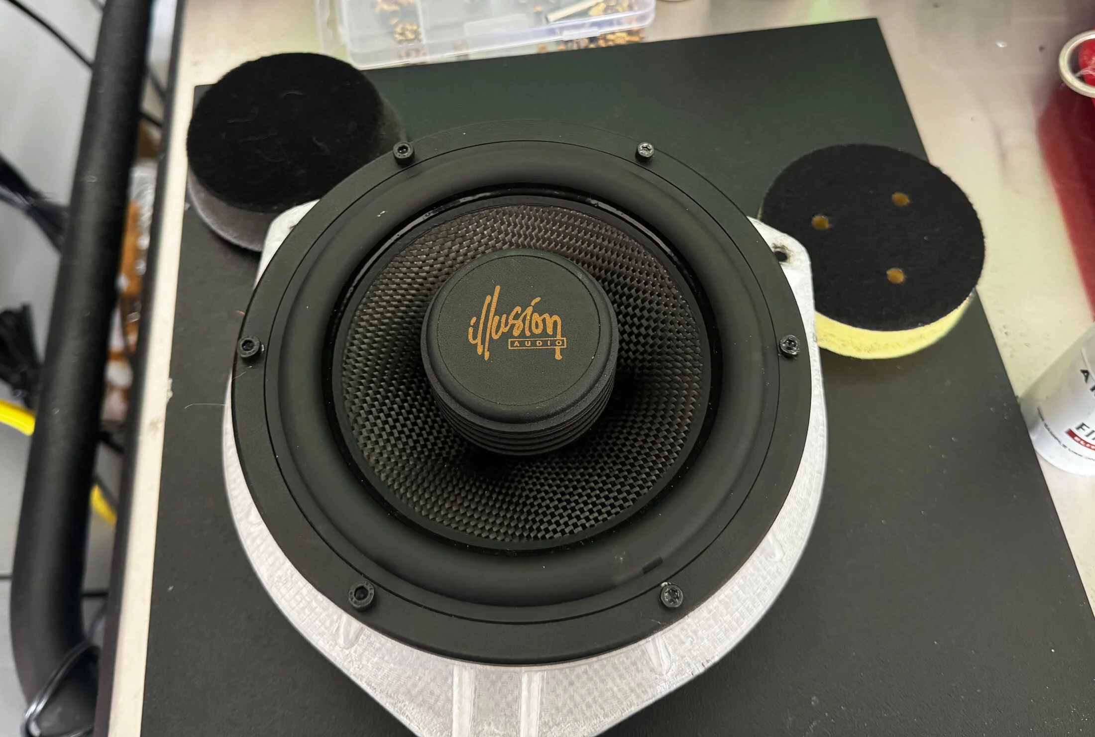

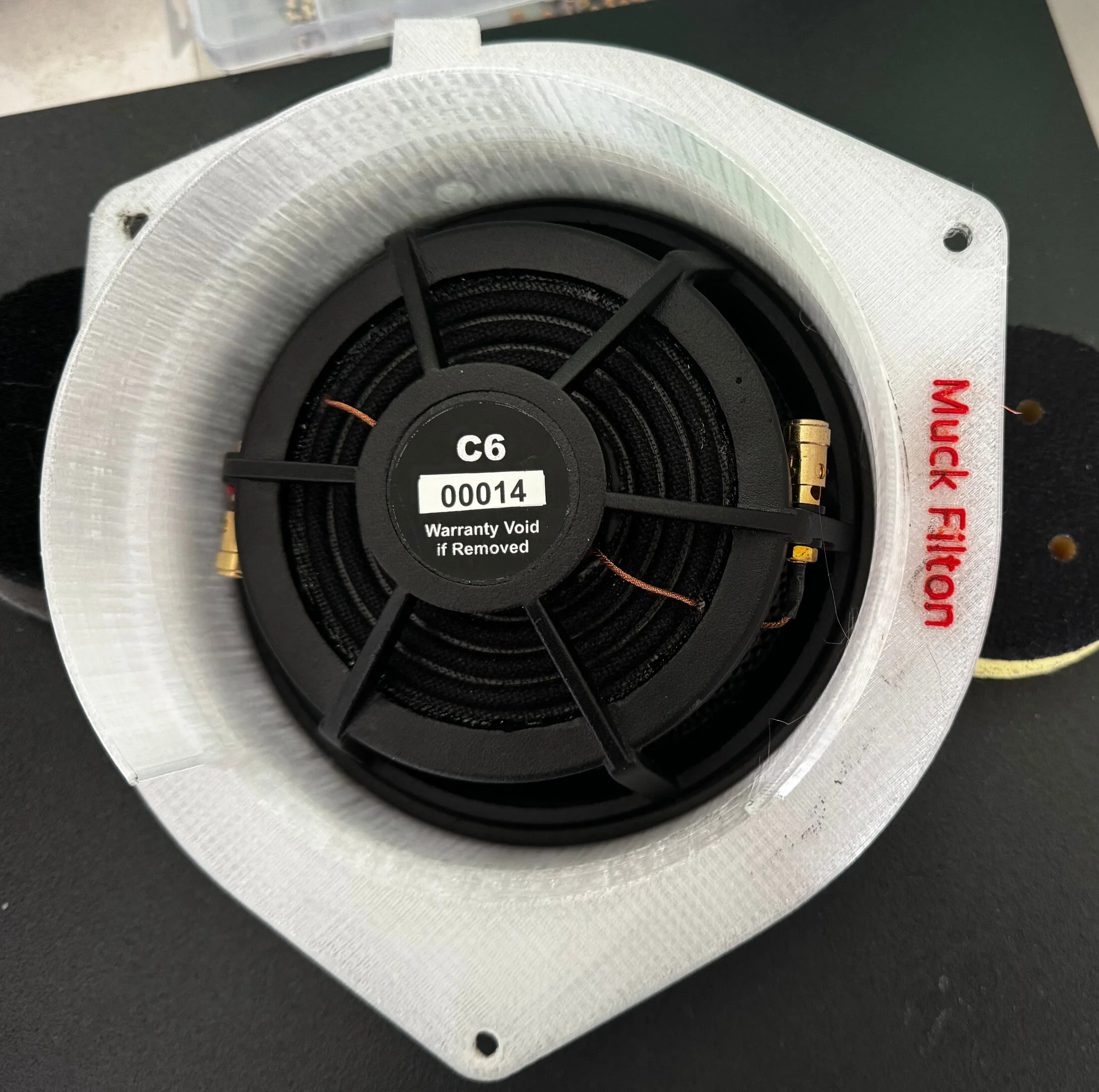

I print front adaptors out of polycarbonate in-house, strong as an ox. Mass produced brackets are normally made via mold injection, quantity over quality for big companies. Not saying that they are trash, just not as good as printed units. This is my demo set so excuse the mismatched bolts, with much love to Hurricane Milton that destroyed most of my neighborhood.

I apologize, got sick once again with some nasty bacteria that had my hands feel like ice for over two months. Yes, Morels are chubby on the back end, all of them. Audison's componets are modest in size and offer all the performance. I am fan of door speakers being in enclosures, Toyota did it right in that sense. If you want to bring it back to it's original self, you can craft a cap out of birch wood and epoxy it on. If you milkshake (epoxy with fiberglass powder) the inside of it, it will become dead as a doornail, much reduced need for sound deadening.

$35 shipped, I can get them out on Thursday. I have a few prints to do today and tomorrow, it takes about 10 hours per pair.

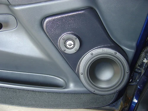

I can bring components forward a hair but that is about it, very little space between the door card and speakers. On the back end, I stick with OEM depth and slim-ish components. The only way to get away from it all, custom mount that will replace stock "grate", like the one in the photo. For first timers, I def recommend something other than Morel for midbass in a stock front location to avoid any headache that they may bring.
