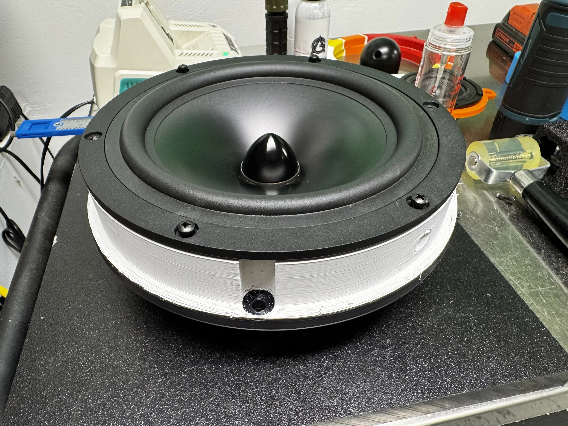

8s are definitely doable. i do my best to keep it as compact as possible. Combo shown in the pic is a standard 8" (insert a Michael Scott joke) kit for Audis, however, it requires for the foundation to be mounted first and then the woofer. This is a deviation from norm because for my customers, I ship out everything pre-mounted for a true plug-n-play product with no requirement for a customer to do anything but mount it and enjoy. Same can be done for our trucks, matter of fact, I am certain that with enough motivation and moderate amount of fabrication to the door card itself, everything from DynAudio MW182 (faux 10 inch units) to Morels of all kinds can be had. However, why go that route? Jarring Morel CAW638 (6") or 538 (5") units can pound the doors off if installed, fed and tuned properly.

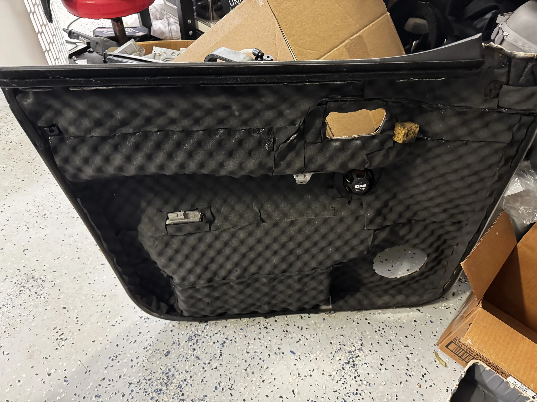

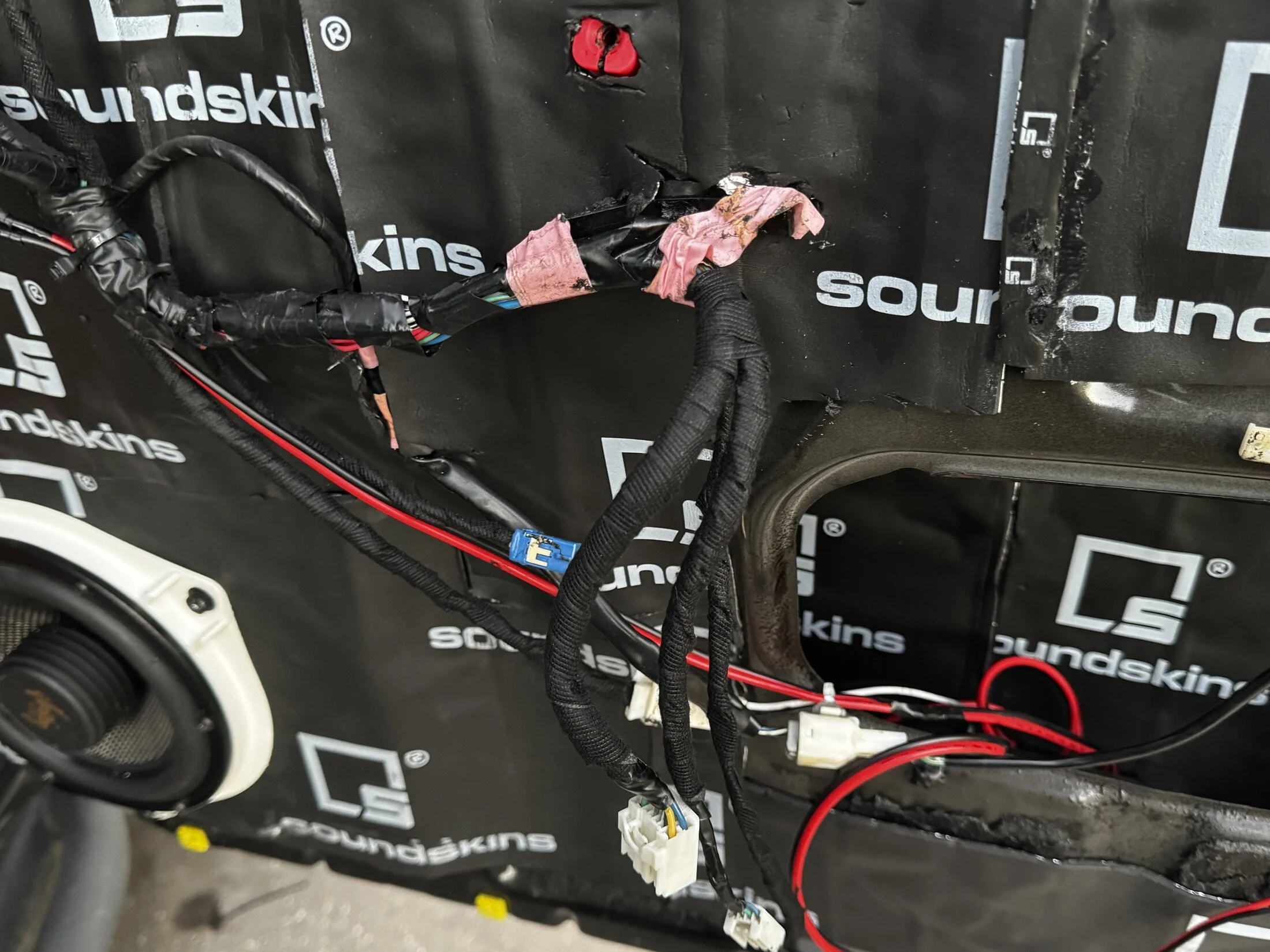

Oh yeah, I am a firm believer that multi-layered approach to sound treatment is the only way to achieve serenity with minimal resonance. I lay down boom mat as my base level, then CLD and decoupler of some sort (fiber or foam). Resonix has a fantastic variety to buy from and few how-to guides. I also prefer "curtain" method but it is not necessary, CLD just needs to be applied in key areas and does not require a 100% coverage. I also tape any and all connectors and re-sheath old wires.

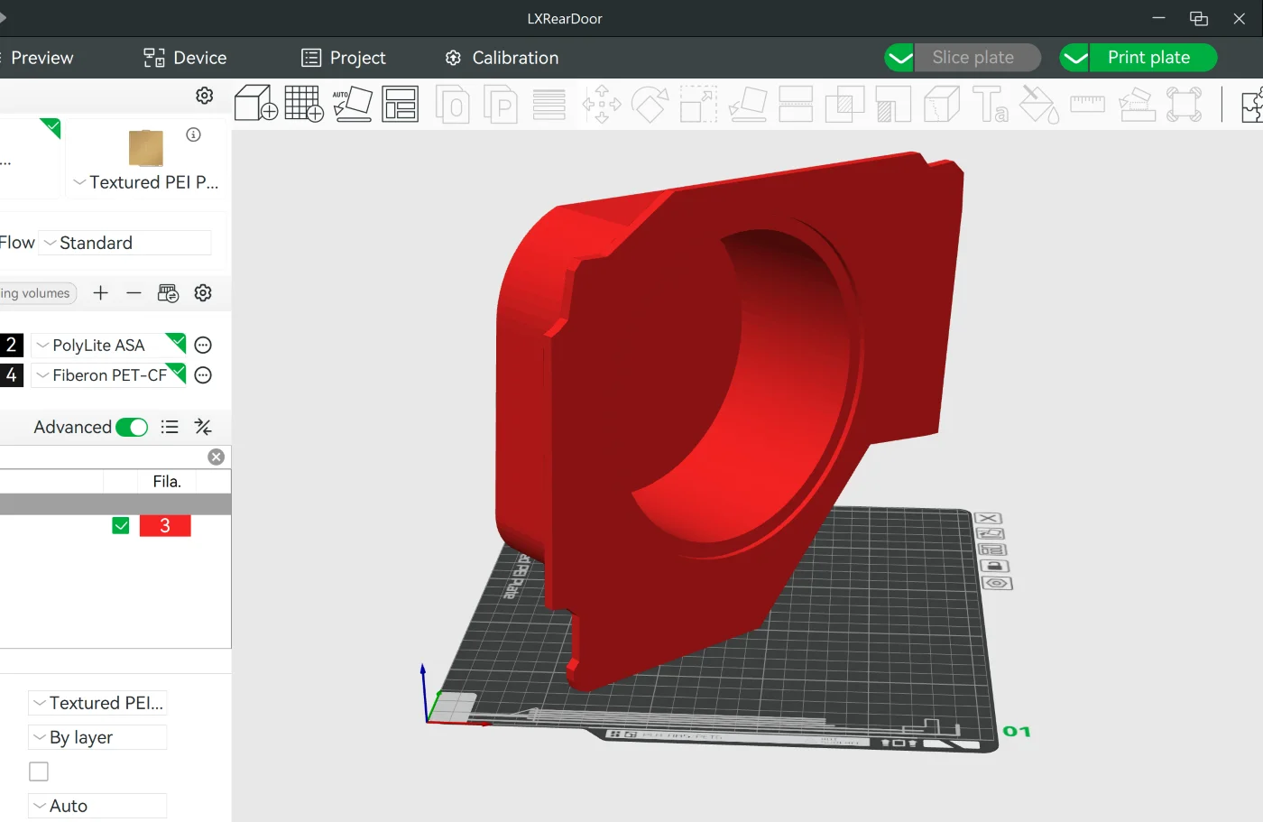

This week's project, to make a viable rear door solution. I am thinking infinite baffle, like the front, or a small sealed enclosure. 5" Ciare (many others will work as well) and tweeter combo (also an example) would work with OEM management and aftermarket. Not needing a large driver for OEM application is a hill I am willing to die on.

I would rather treat my pee pee as a musket and pack it full of glass shards than to do this process again. I have cargo area to redo (removing worthless Siless) and update wiring, this "refresh" started three lifetimes ago. OEM foam sheath was crumbling and it does not come off peacefully, tessa tape and Resonix tape are worthy replacements.

For those that are wanting to run 8s, offsetting the woofer by about 7mm will prevent any chance of it hitting the door card. I read in other threads about people ruining their woofers when it came to running 8s, this is one of the ways to combat that issue. I still do not believe in a need to run a woofer that size in this vehicle at this day and age, good bass and midrange can be had via smaller size units.

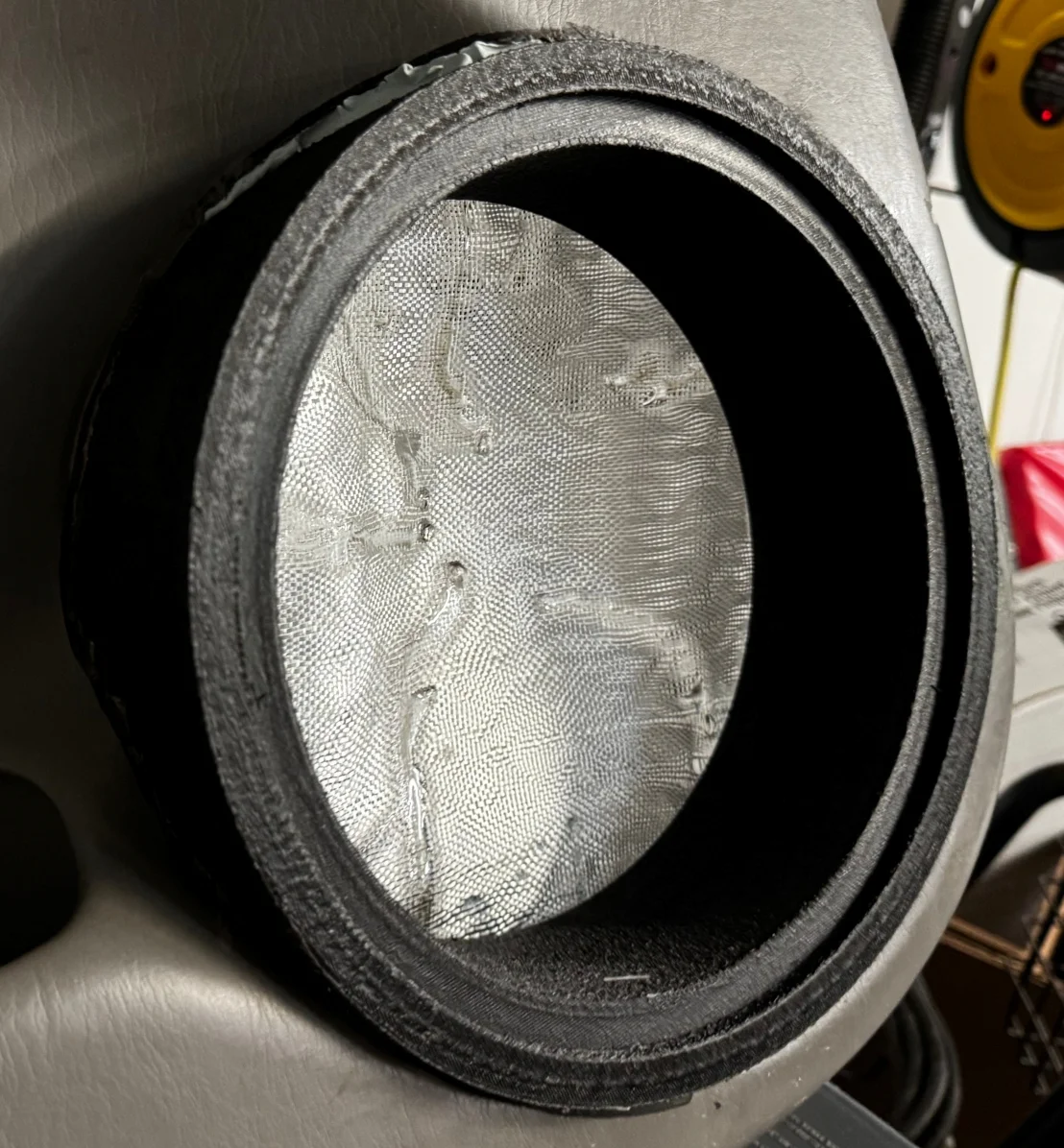

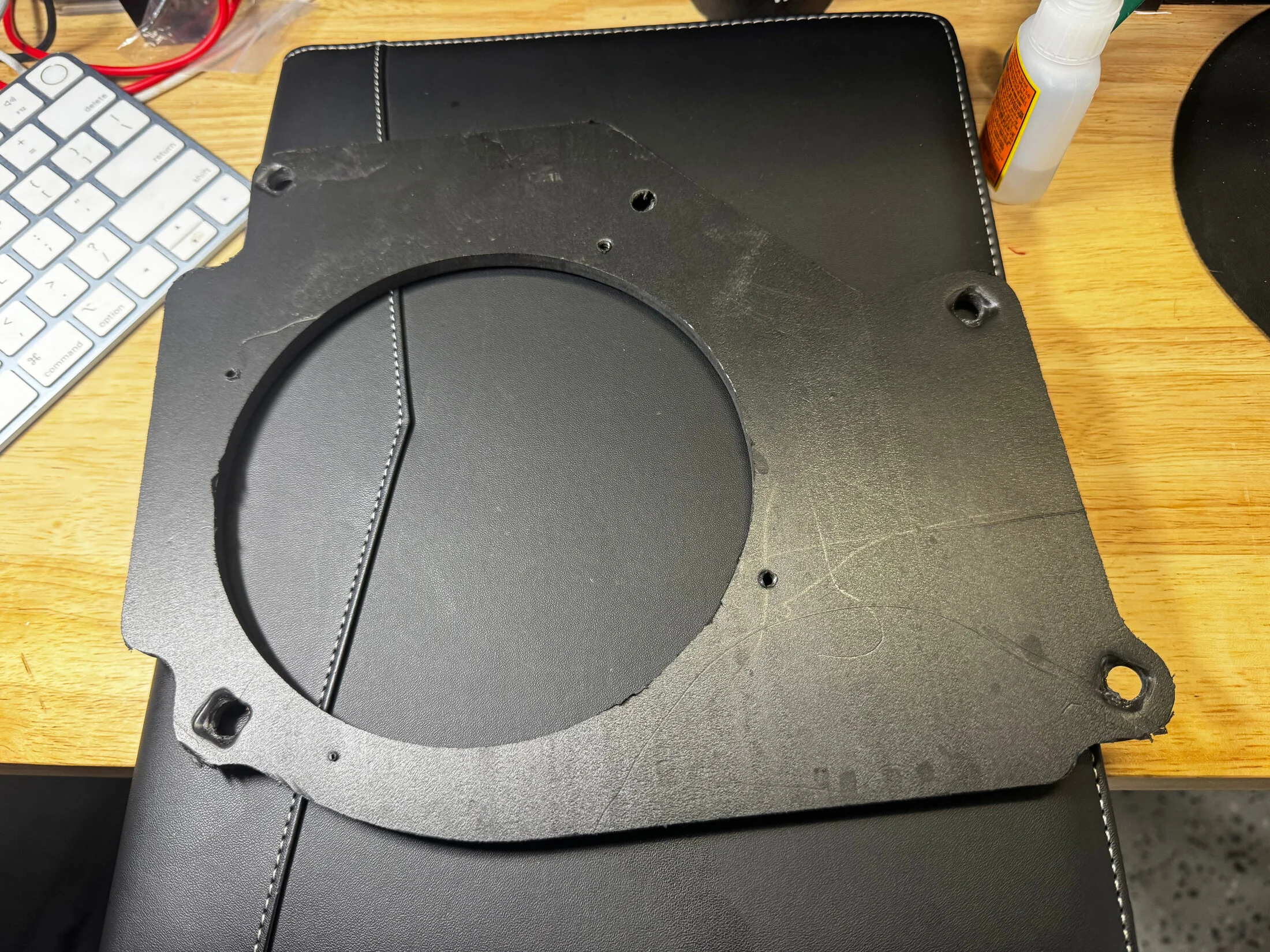

This week has been eventful. Few more days and project "8 inches up Bertha's rear" will be finally finished. I had a vision of an adapter to "rise out of a door card" and sit somewhat flush with that door. I cut the least amount of the door card as I possibly could, thin layer of bondo , followed for the first layer of fiberglass which was applied to the inner door card. FG is mixed with milled glass which will assist with making the door card as acoustically dead as possible. Tomorrow is second layer of FG and prep the face for paint. Adaptor is made out of Polycarbonate.

I did not forget about you., R&D is underway. Also, there is zero information about whether those specific units are happy in enclosures or infinite baffle. If Qts values are high for those speakers, they will quit sounding decent. For the sake of the conversation, lets say they are infinite baffle type of units, you can place them in one of these enclosures that I am baking right now and closed cell foam can be placed on the butt of it to prevent water from coming in.

Hey. Not brave, a caveman who is too stupid to quit is more like it. That silver thing is just a sheet of raw fiberglass, the adapter is extended almost to the door cavity, so the woofer will vent into it. The whole thing is sealed with 4 layers of various sound deadening material. Here is what it looks like mock fitted, next is re-upholstering the door so it won't look like a complete hack job.

No, there is not need for that. I am in polishing phase, making numerous of tweaks daily. My printer hates me.
