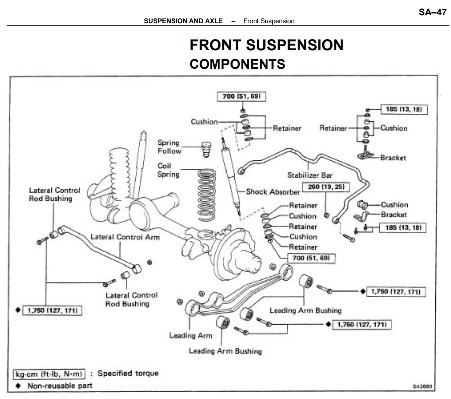

I'm working on doing a full refresh on my suspension and steering bushings. Bought the Trail Tailor tools, Man-a-fre bushing kit, and tie rod ends from Cruiser Teq. Unfortunately I forgot that some hardware isn't reusable... Now I'm wondering how I ensure I get the correct hardware where needed.
I have the full FSM, but all I see are the torque specs in the figures, not the actual part number or identification info for the hardware. I also don't see the information in the appendices.
Can anybody guide me in the right direction to find the right information? Thank you!
You can look on Toyota's site, Partsouq or Amayama for part numbers and ordering all work about the same. Some seem to like Partsouq for a little easier part number lookups.
