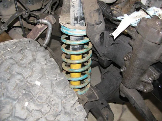

in my "tired and ill" mind, i stuck in the springs and then bounced the front end by hand and was shocked to see the ease in which the engine and frame moved full travel. that was yesterday.
this morning i installed the shocks and that made a HUGE difference.
so, for now, the vertict is still out as to whether i will be happy with this kit or not.
i do recommend that if you are considering this swap to go with the HD front springs, just to be safe.

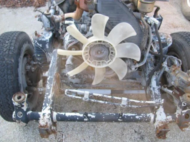

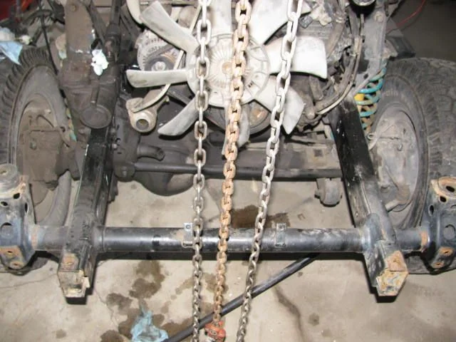

pic of the 79 series front cross member
pic of the 79 series small little strengthening bar to panhard support
pic of 79 series tranny crossmember.
from the firewall back the frames are identical (except for the coil suspension of course) and factory.
also the steering box and suspension are still on the original portion of the frame, not attached to the extended front nose and cross member.

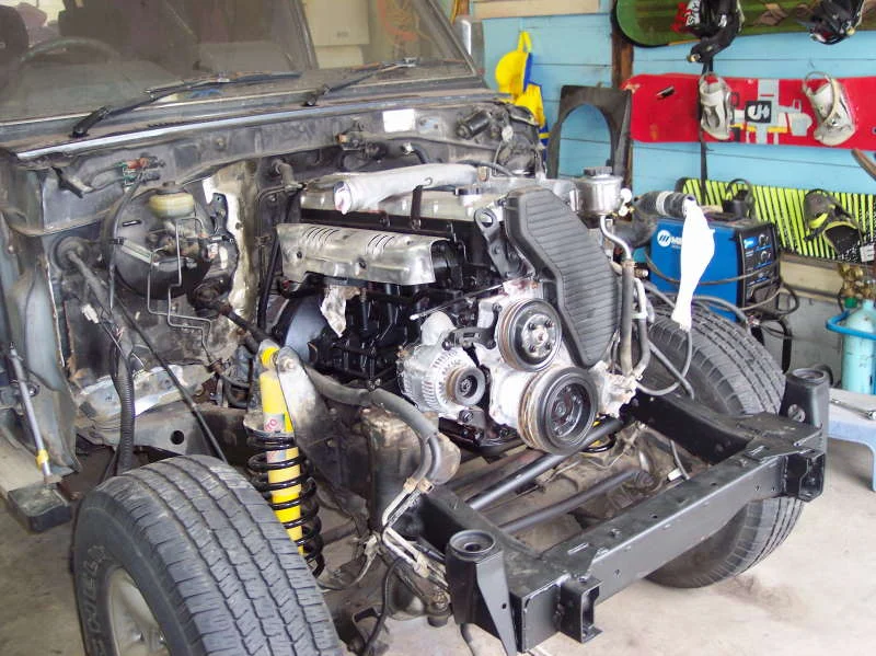

the 79 nose section top
the 78 nose section bottom

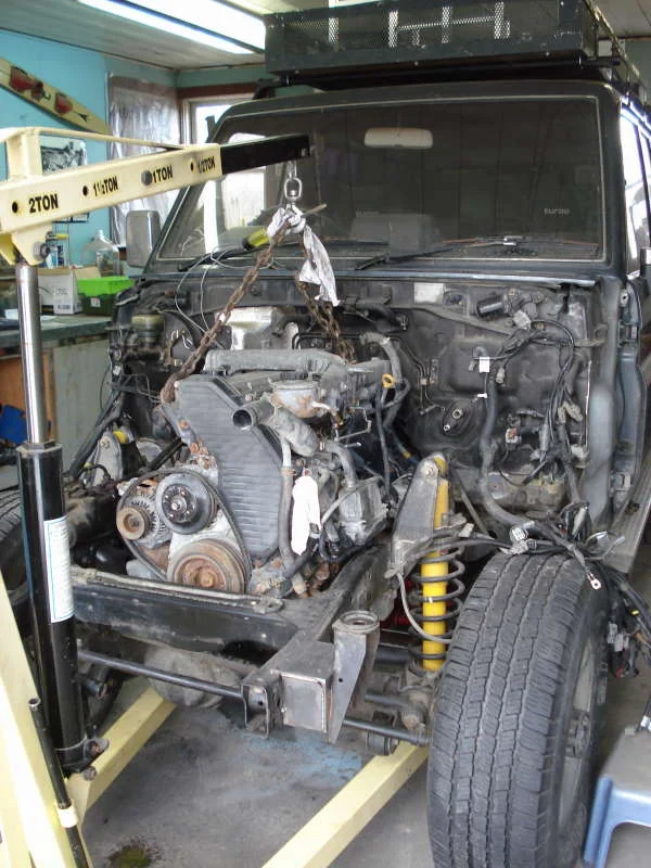

installation of the lift springs and shocks

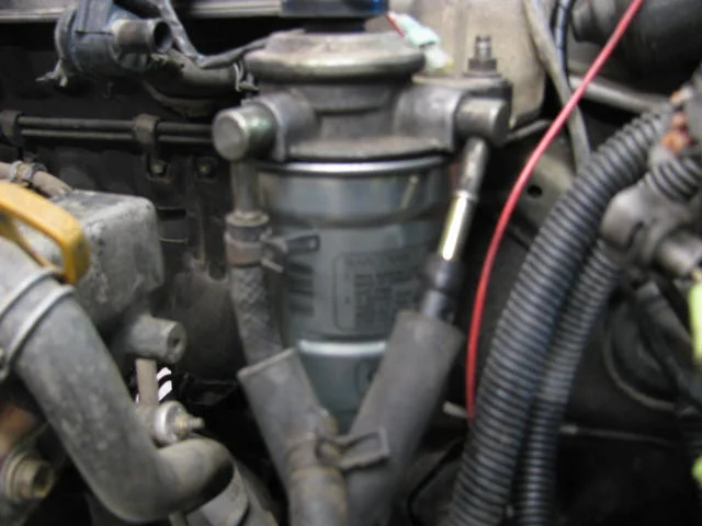

might as well change out the fuel filter and fill it with seafoam

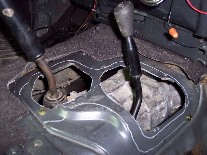

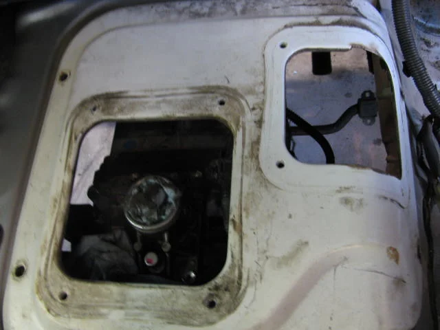

the location of the shift to the stock tranny cover.
tomorrow, install rad, hook up the elec, install small support brace, install pyro, oil pressure and boost gauges... maybe
yesterday and today 6 hours.

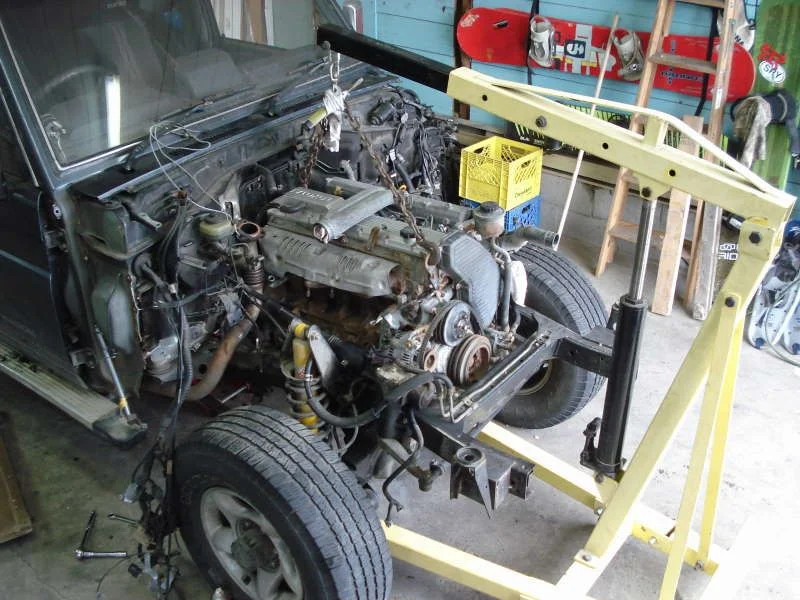

from bieselbub's build thread
Was able to scrape together some time this morn, and dry fit the Hz. I had noticed that the stock front drive shafts of both the lj78 and the hzj79 were the same length, and after taking a few measurments it looked like tranny mounts might not need to be moved :D. After cutting the motor mounts out of the lj and the 79, the Hz slid right into place. I Used the stock placed tranny mount, and then tacked in place the motor mounts ( I'll be able to use both stock drive shafts ). So far it looks like the fan will need some attention, the 18" hz fan just hits the front crossmember, and the smaller 2LT fan clears by about 3/4". Both leave no room for a shroud, I'll have to see what it looks like when the panels are on, thinking if I bring the fan foward about 3" it should be past the crossmember.
