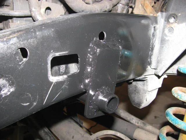

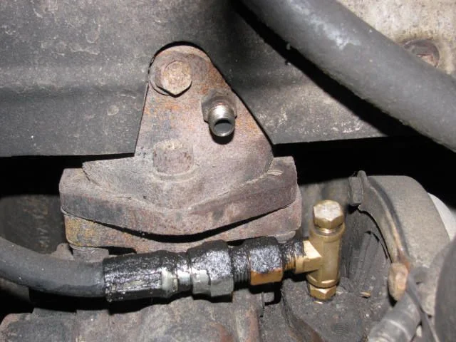

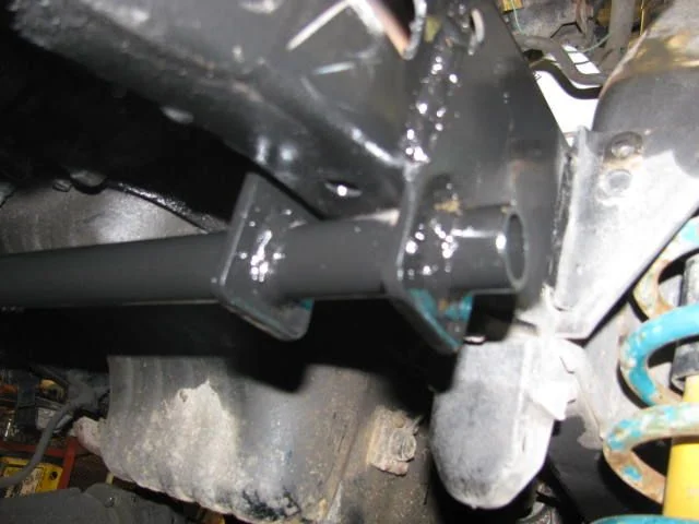

tacking in place
then removed for welding the plates on
in hind sight i should have done this before reinstalling the engine. for some reason i thought i need to check clearences. turns out since both ends are attached to the frame the clearences are not critical.
duh.

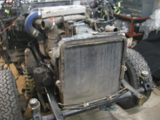

installing the rad and hoses.

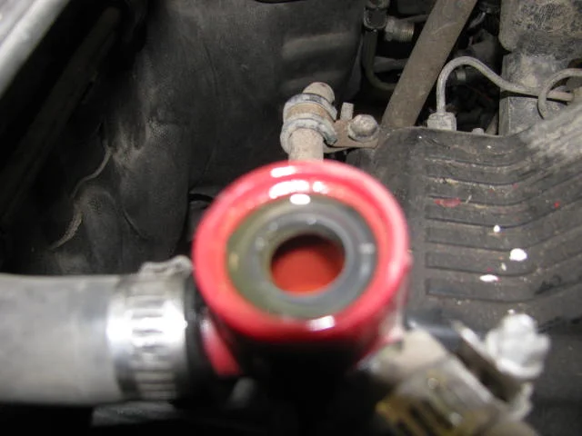

i like to have the "power flush" adapter next to the firewall. it makes getting all the air out of the system so much easier.
as you can see the rad is full but there is nothing at the firewall.
2L later and it finally dribbled out.
now you can also achieve the same results by lifting the front of the truck up till the rad spout is higher than the highest point of the cooling system.

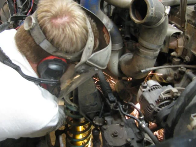

at this point Rusty showed up and he assumed the position... of working under the rig.
(he is younger and skinnier than i am)

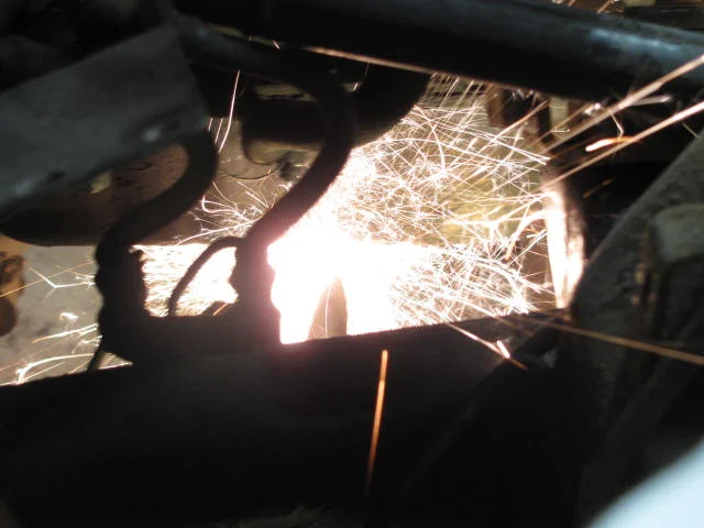

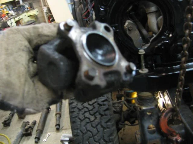

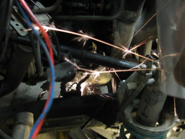

i had a driveshaft that someone had REALLY torqued the nuts on. i had tried and tried to get that bugger off.
Rusty shows up and takes matters into his own hands. a zip disc and the flange is sitting on the floor.
the nuts still sticking through the flange

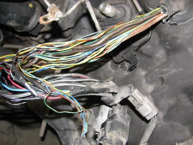

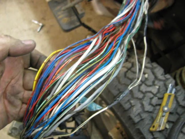

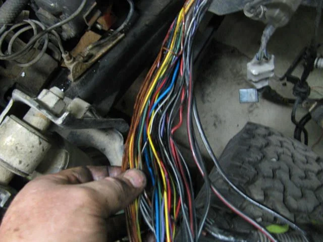

starting on eliminating a bunch of wires and connectors.
wires wires everywhere...
damn there is a LOT or wires not needed in this swap!!

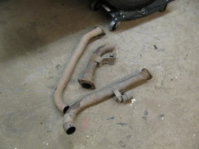

old exhaust gone.

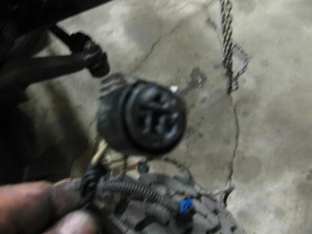

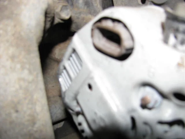

the alternator plugs are different...

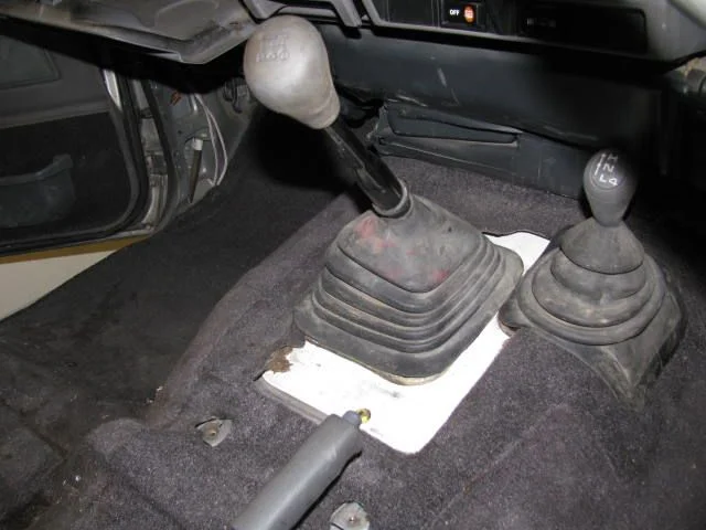

as you could see in an earlier photo i positioned the shifters to be centered in the hole in the floor tranny cover. hence the reason the PZJ70 shaft would fit.

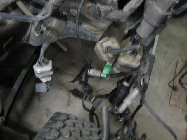

the rear driveshaft went in today to get "stretched". a bunch of the wiring is cleaned up. all the factory senders are attached. i have to go to the local wreckers and get a new plug for the alternator.
LH side wiring is done.

shifters in

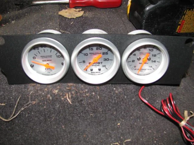

gauge pod ready to be installed.
the new pyro sender installed.
the new elec oil sender installed.

front the first two mess of wires to the last one with 9 wires...
factory oil sender
factory water temp
the wires in their sheath.
it will be a lot more tidy once the fenders are back on.
