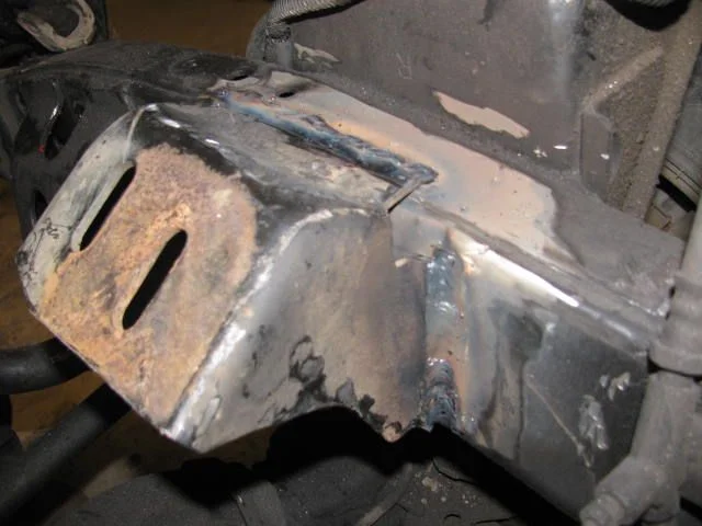

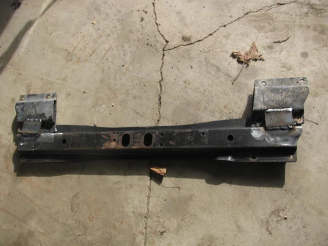

to make a quick tranny mount i took the auto and lined it up with the manual. the inner holes lined up perfectly.
i cut the ends off the auto tranny mount and welded them to the manual with reinforcing 1/4" braces.
it fit perfectly.
simple and effective.
when i go to chop the truck i will make a cleaner looking mount.

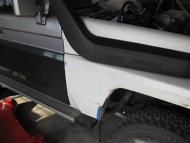

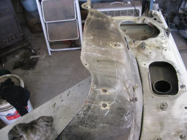

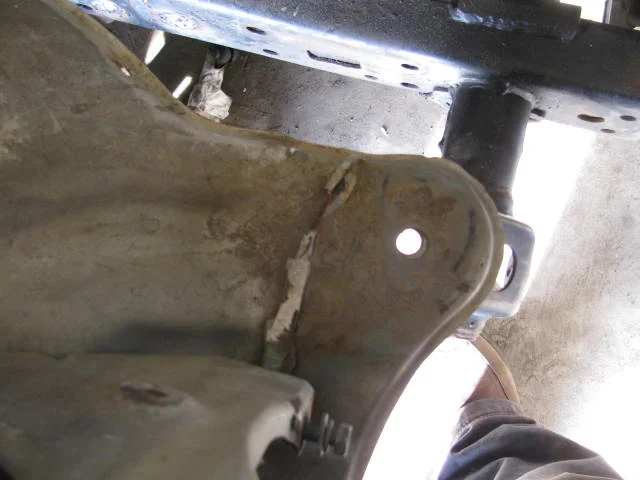

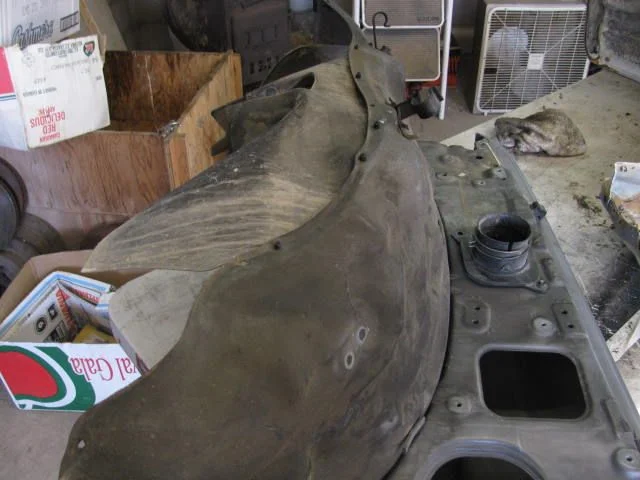

so as was suggested i test fitted the fenders and rad/rad support
the HD fender
the LD fender
the fit after trimming
the fender to door (rough fit, one bolt)
the fender to support at front (pretty darn good)

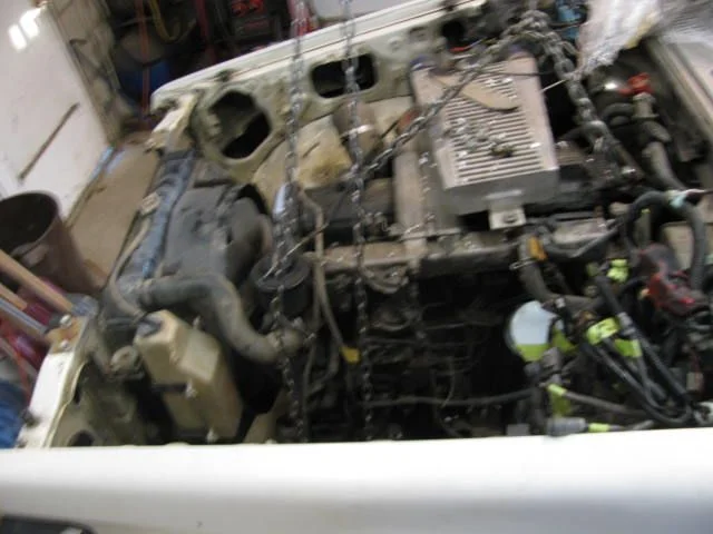

the engine bay

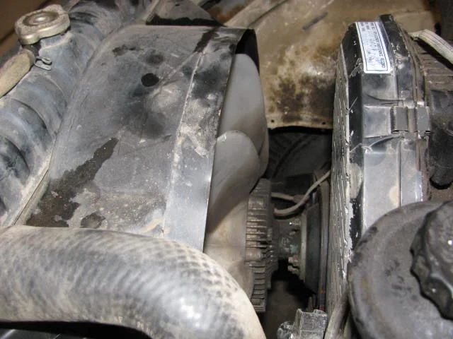

the fan to cowling
so once the fenders were test fitted then they were removed, rad removed and the tranny mount bolted down tight with the tranny attached.
then the engine mounts were located on the frame and marked for welding
then the mounts were removed and the area cleaned of grease and paint
then reinstalled and lowered into place for tacking
then the engine was unbloted from the mounts and the tranny mount was removed.
the engine was hosted back out of the bay
the engine mounts were welded in place and left to cool for cleaning on thursday.
