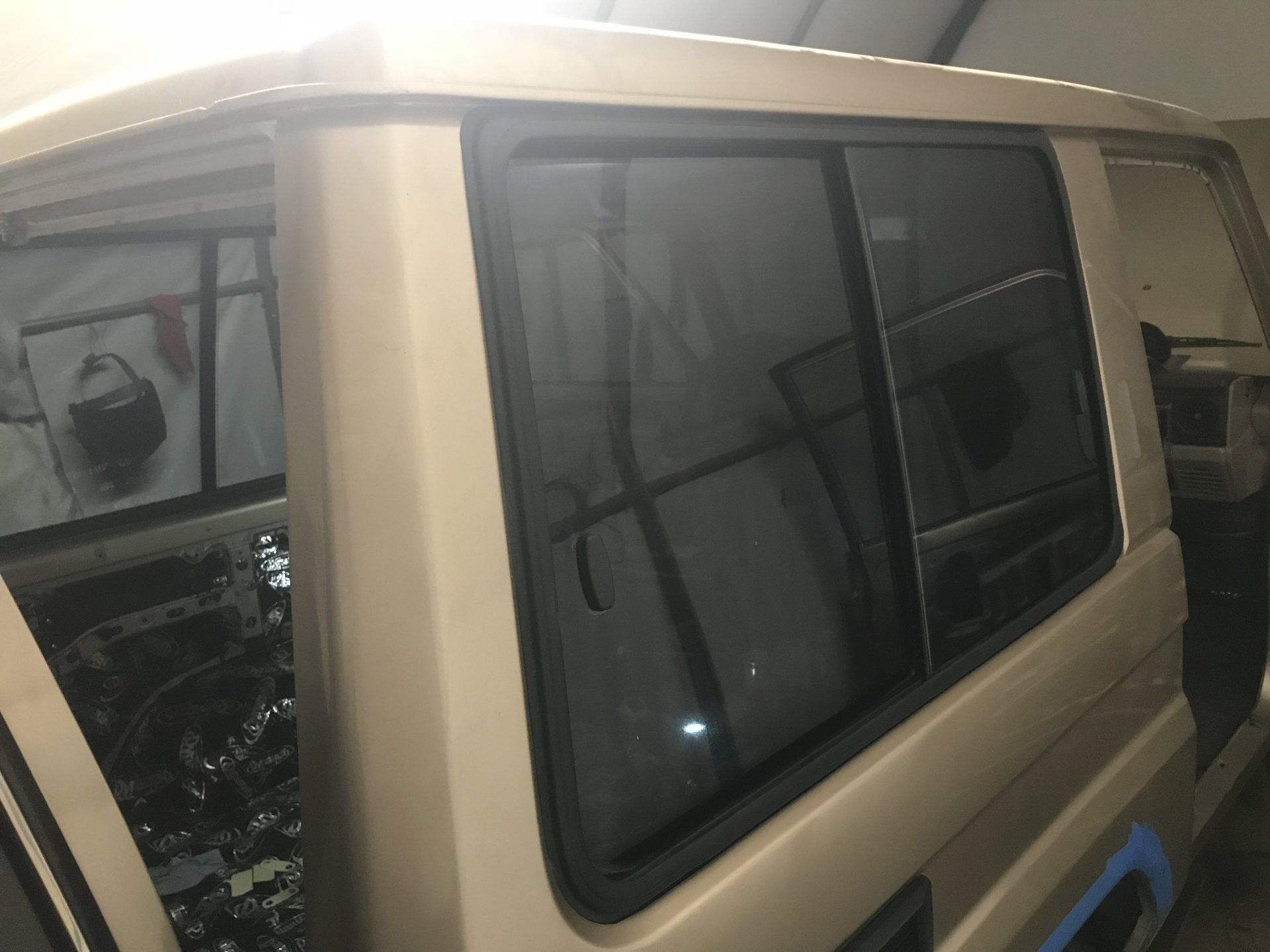

Side windows with all new gaskets and hardware installed.
It seems the 70 is the only one that doesn’t use butyl tape on these gaskets. So as per the FSM, I just put them in. Didn’t use the rope method either and I did it myself.
No leaks and the drains work well.
Cheers

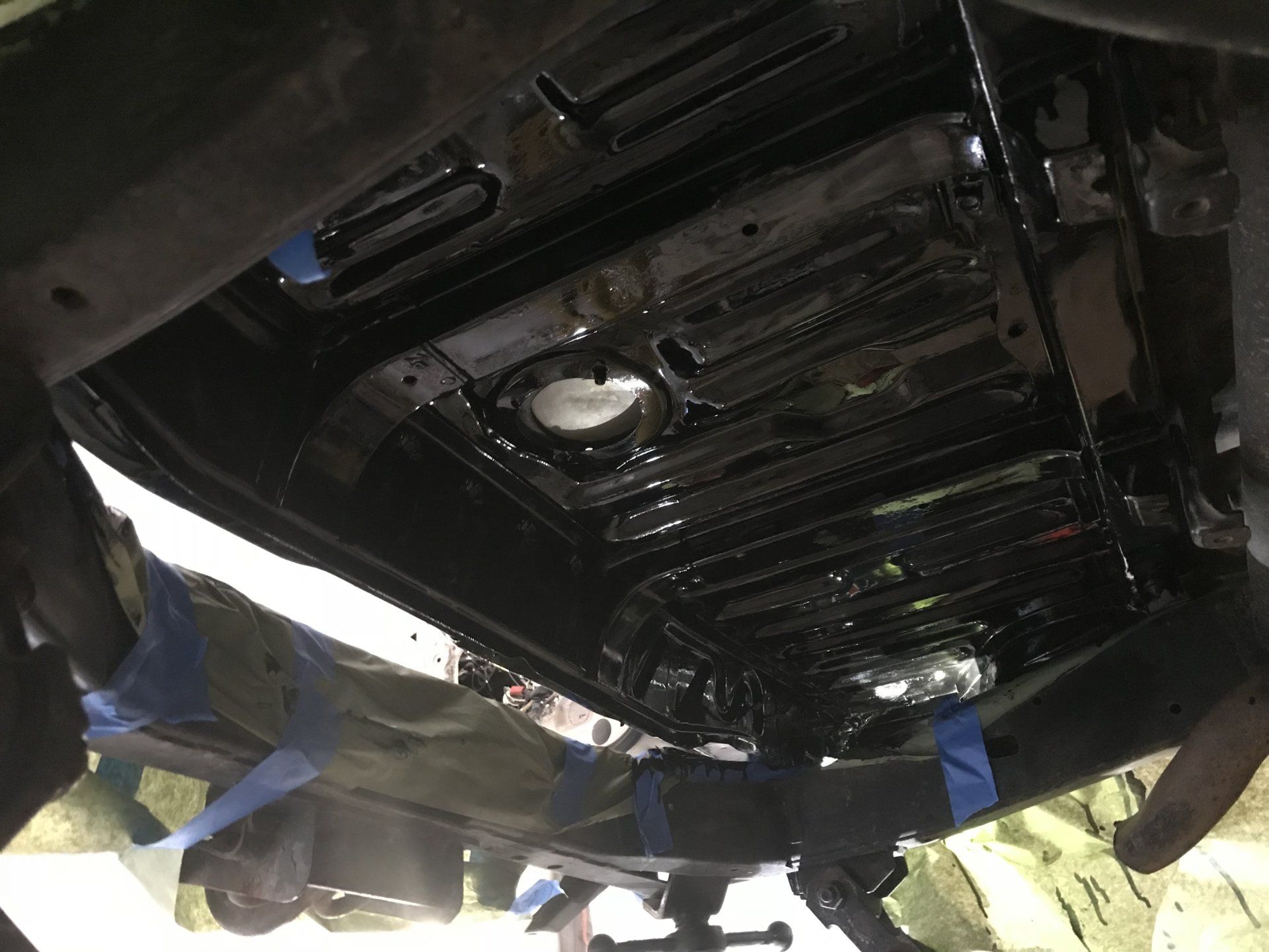

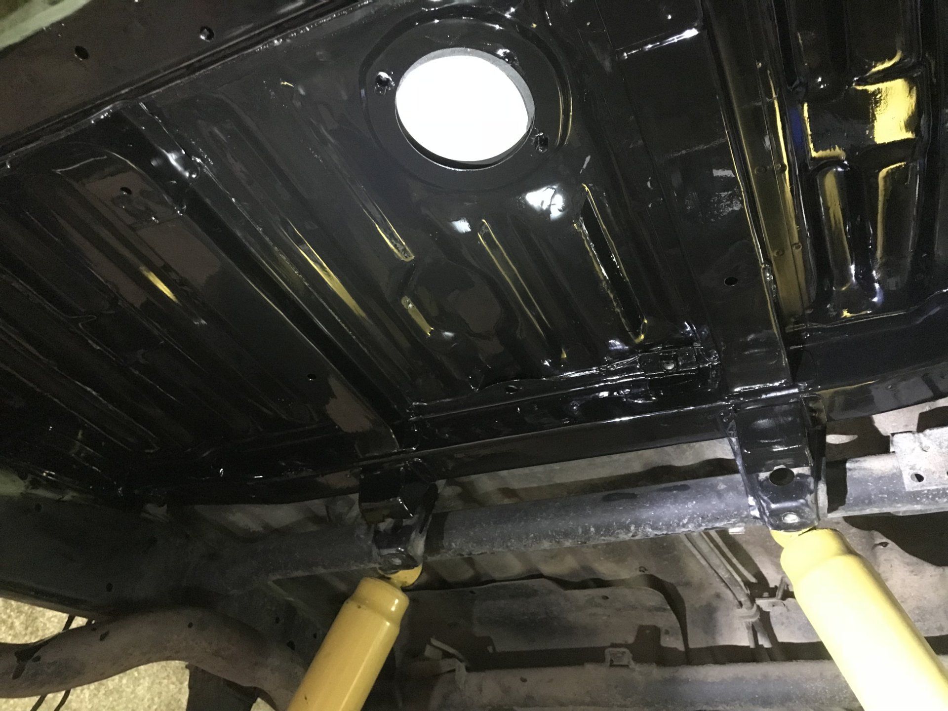

Dropped fuel tank, found a pin hole, exploring options.

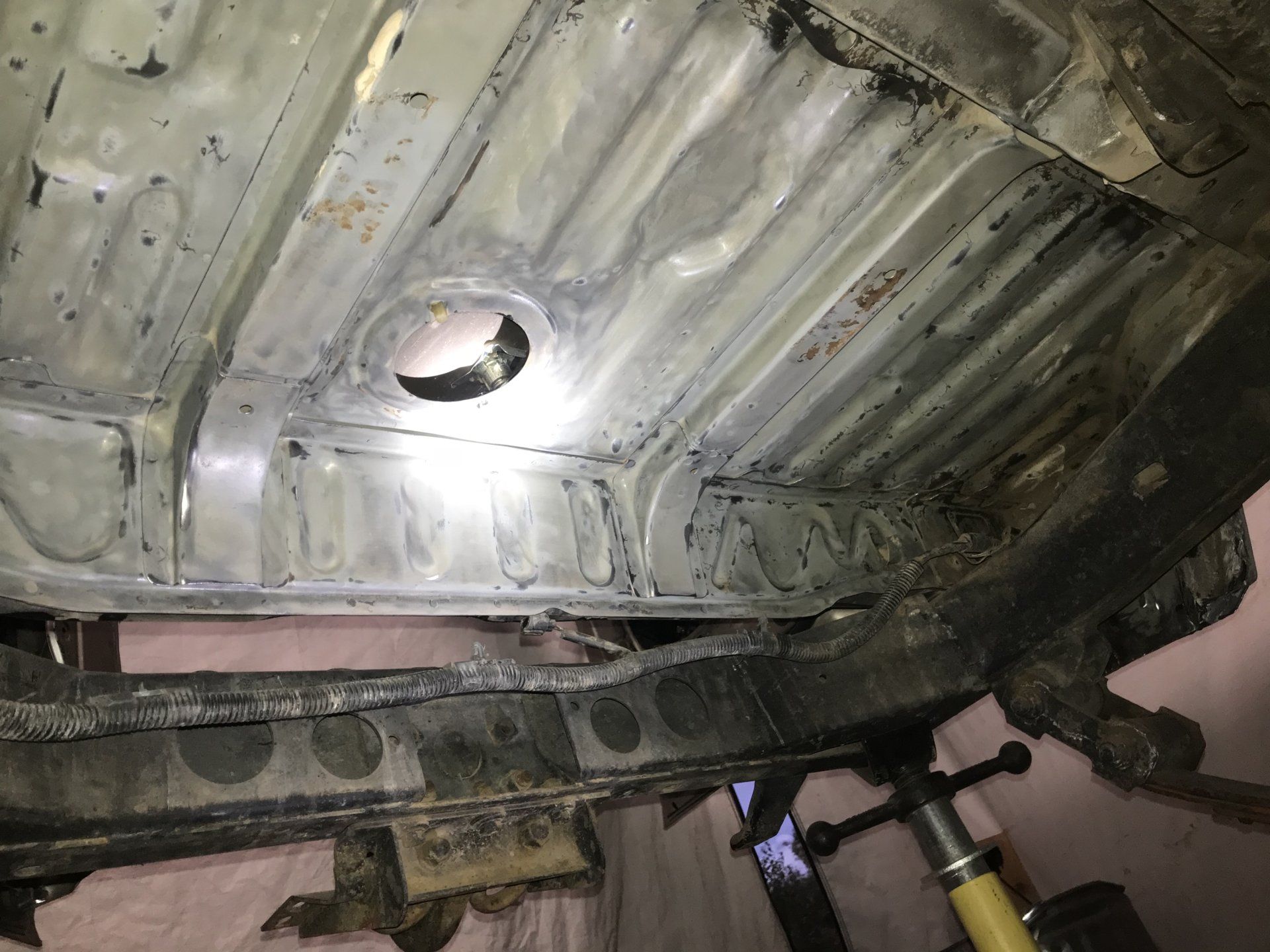

Decided to seal up under side of rear floor while it’s out with POR15. Prep...

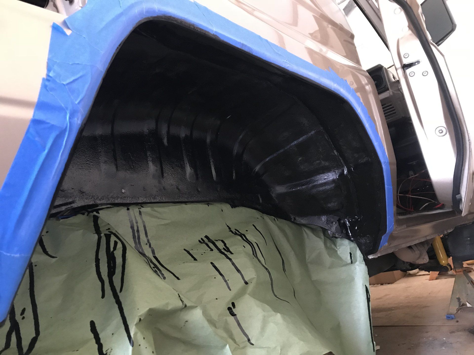

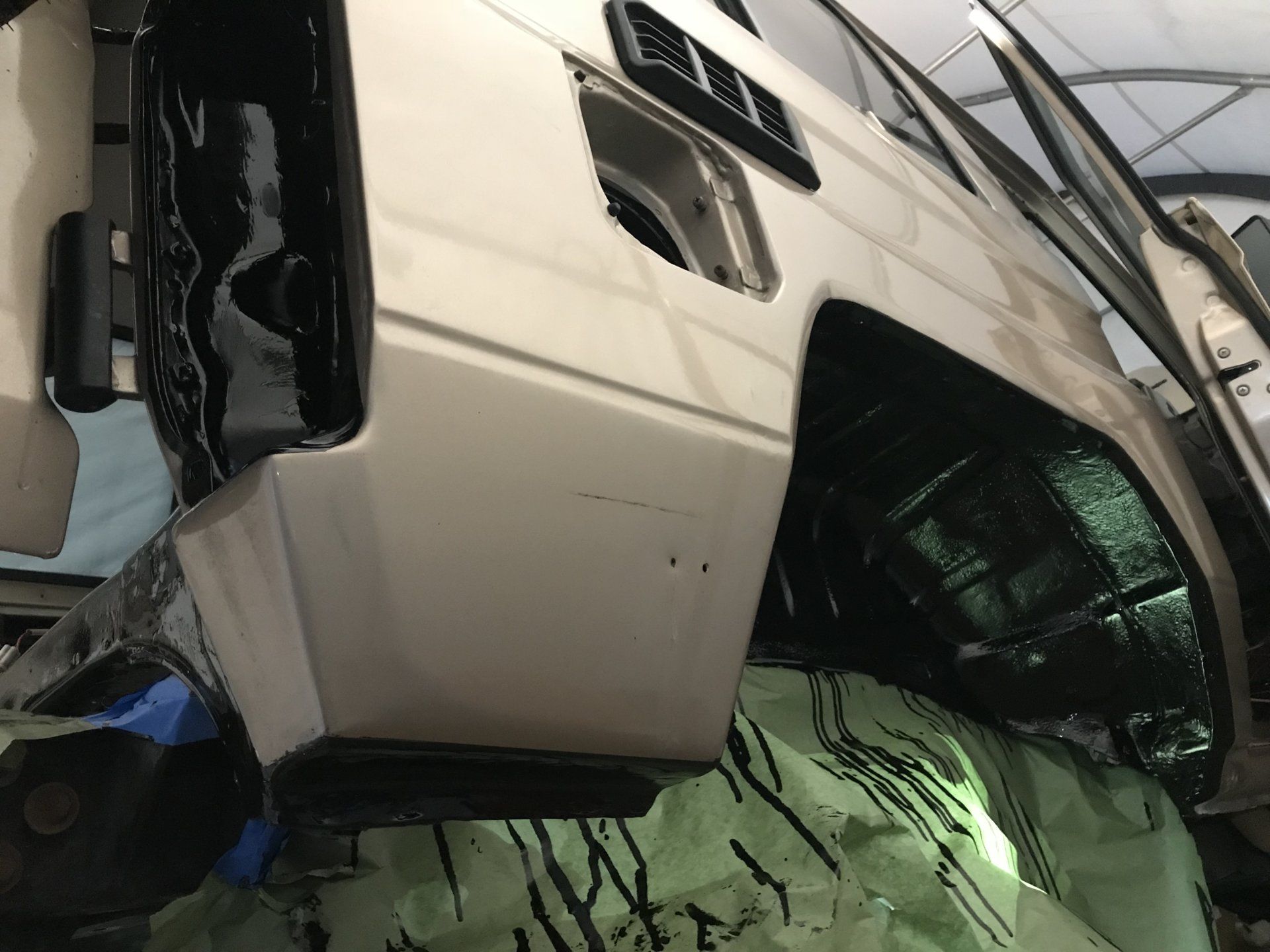

I have got a coat of POR15 down on the back of the trucks wheel wells and under the floor. Oh ya I also sealed up the taillight housings.
Going back in for the second coat in a hot minute.
Cheers

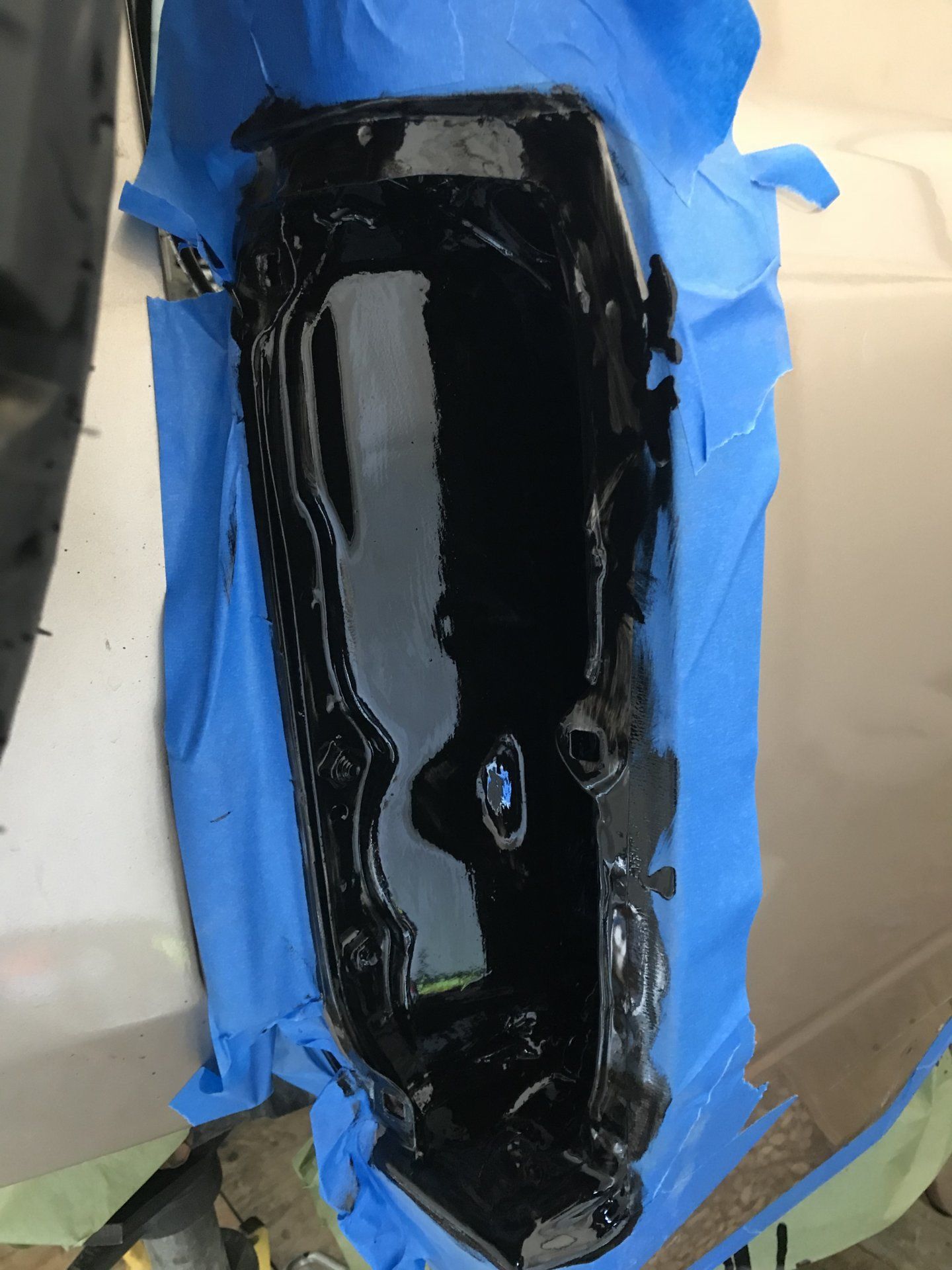

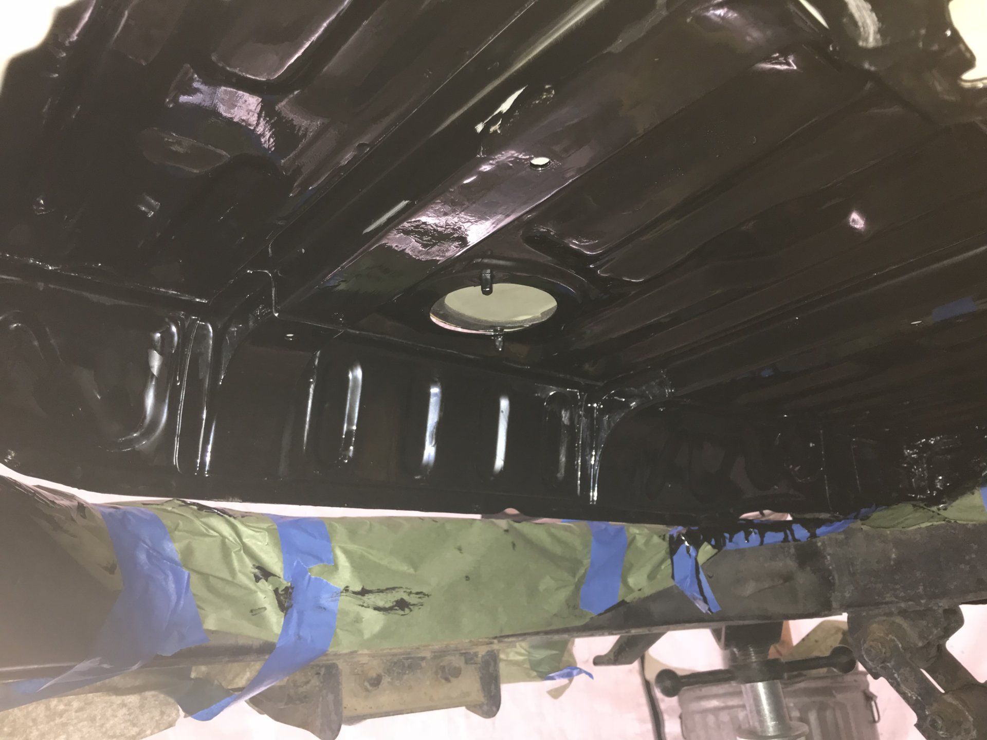

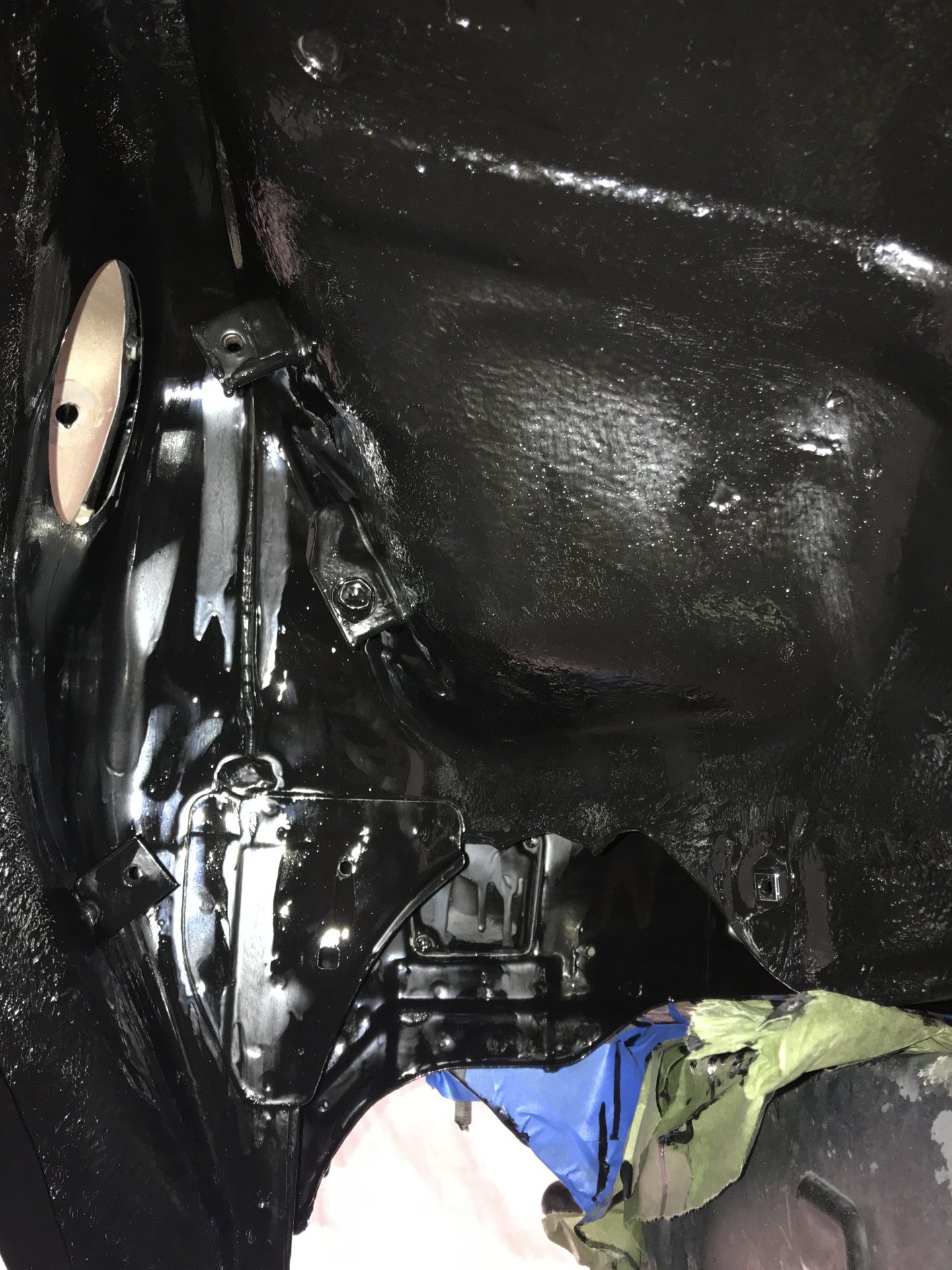

All done with the POR15 back here.
This is where I patched the back of the rocker on the LHS.
I still have some more POR15 I am going to do on the rockers and front wheel wells. I am also spraying some 3M rubberized undercoating in the wheel wells and laying down a very small amount of Raptorliner in high wear areas.
Cheers
Do you worry about any of the threaded holes? Or do you just chase them afterwards with a tap?
I deal with them a variety of ways. One I will leave a bolt in the hole. Two I be careful if I can not to goop up the holes. And yes three, chase them with a tap if needed.
Also I use star washers on all my grounds so after paint I still get a good bite on those bolts.
