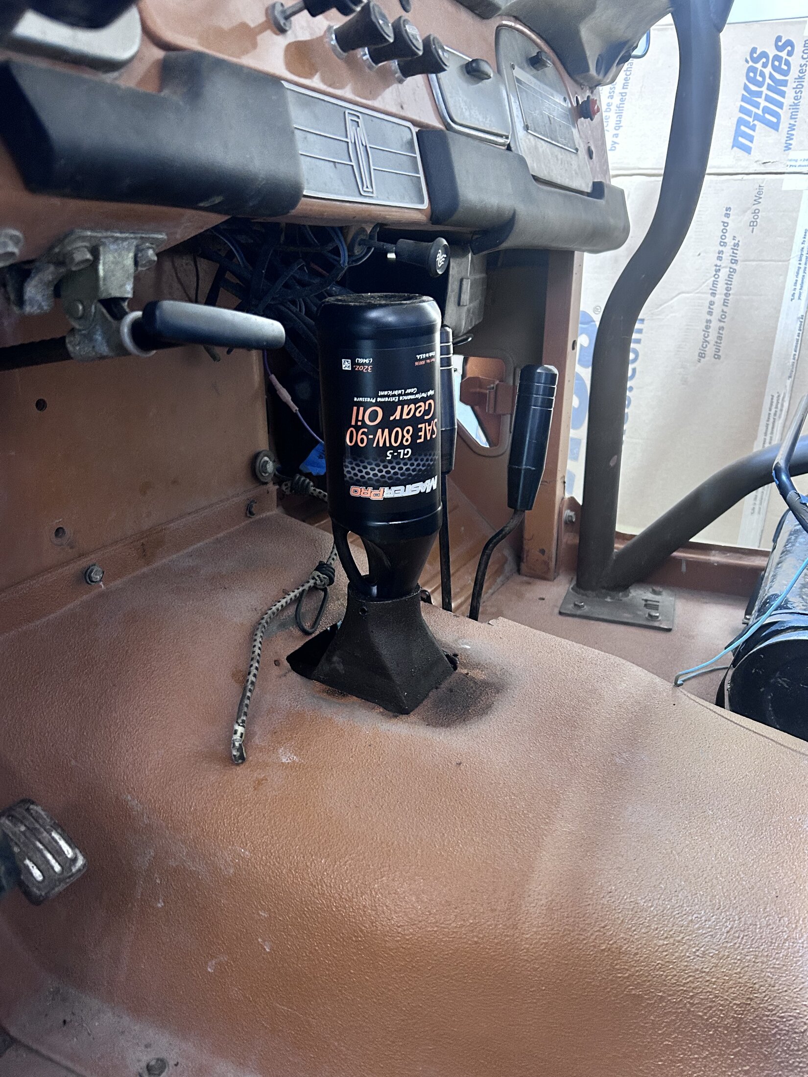

Popped the shifter cane out and dumped in the juice. This is by far the best way to fill this transmission. Years ago, I had read about this trick. Trouble was I would only remember after I had made a total mess trying to access the fill hole. No mess. No cursing.

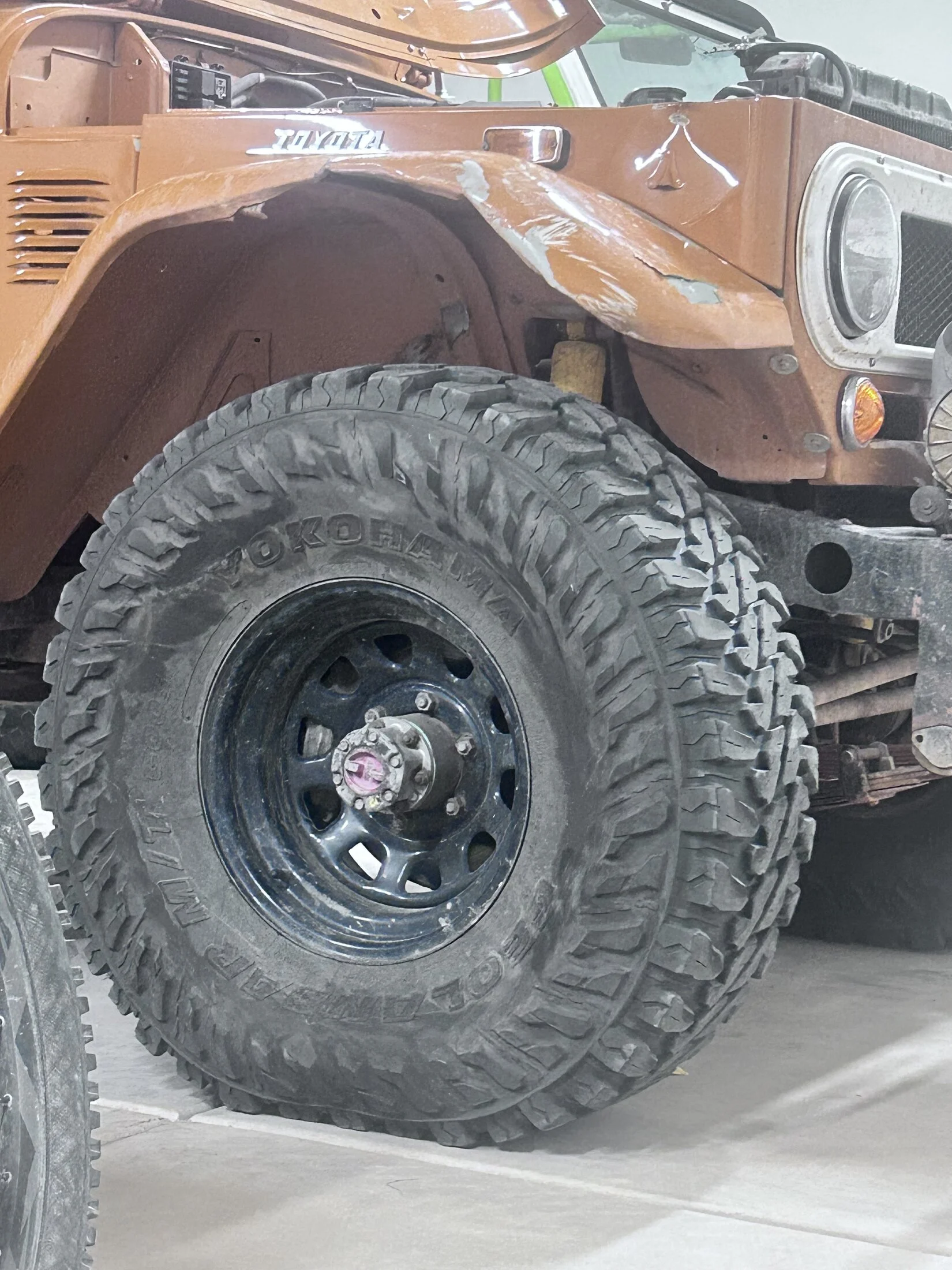

So I know this is hard to judge with the truck sitting still on level ground, but how do we feel about this amount of bulge
This at 10-11psi. I can’t say I was getting a ton of sidewalk flex yesterday, but I was behind the wheel and it’s hard to tell. Traction felt ok, but struggled more than I expected.
The tires are great on the highway, so I’m not complaining. My wife drives it as well and she doesn’t need poor performance. Overall I’m happy with them; they just have more trouble offroad than I expected.

To my uneducated eye that looks good to me. Maybe try like 8psi today and see what happens. 40s aren’t that heavy.
I run 18psi in my front for daily driving on 35s.
You know your way around a set of tires for sure. Are you getting nice even wear at 18psi.
I like 25-28 on the street. Seems to get good performance and softer ride. My buddy showed up with 35 psi in his 37’s; they were crowning pretty good.
8psi- I might try it, but I’m scared…
Bead locks in your future? :smokin:
Got some with 37’s ready to go on, but I’m not sure I want to commit to what it needs to fit- unless I stick to mall crawlin. Or maybe find some cheap 35x17’s…

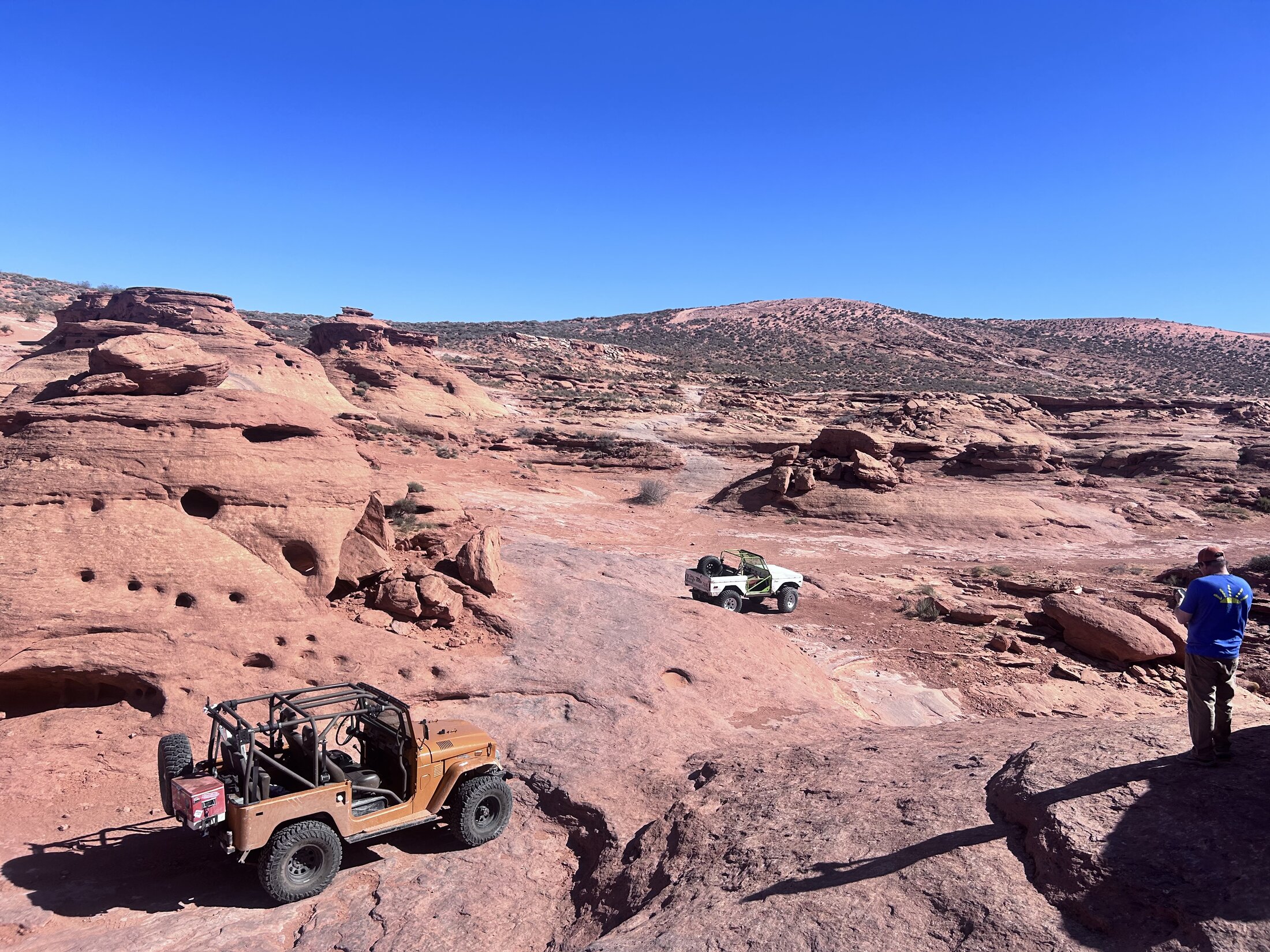

As far as wheeling goes, time was a little more precious, so it was more limited this year then past trips. On top of this, we squandered a bunch of time just wandering around. Which was fun to, just not efficient. We did poke around in the Maze and did what we were comfortable with. Didn’t try The Drop or any of the buggy lines, but we had fun.

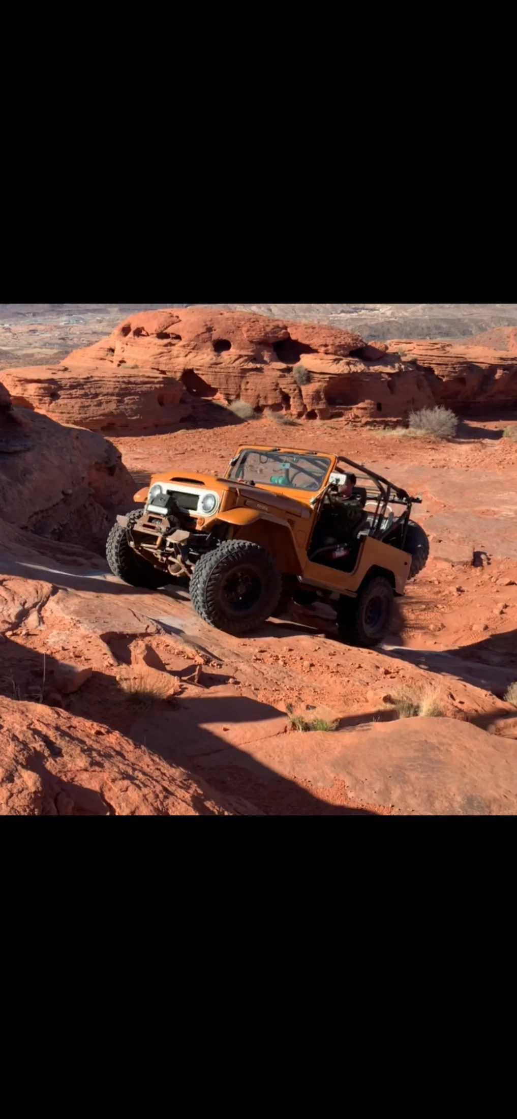

I did get a bit of a scare- I was doing a quick steep climb with a small ledge at the top. I was about to the top when my transfer case popped into neutral. When this happened I pumped the brakes. This made my frontend rise up. Felt like I was tipping back. Having felt this sensation before, I released the brake and let gravity take the cruiser back to flat ground. After taking a second to make sure I didn’t poop myself, I tied the lever into the low position and let the cruiser walk on up at idle. No more drama, just jangled nerves.
After that I was hesitant, but after a couple roller type obstacles we were back on track.
Overall, it was a good trip. No major upsets. No major damage or breakdowns. I did loose the ground for my cooling fan due to all the bouncing around, but once I identified the problem it was a simple fix. The Tcase only popped out of gear the one time and I had just put it in gear, so I’m hoping it was just operator error.
The United By Bronco Rally was going on our last two days. Weird mix of shiny new Broncos and single use crawler EB’s. On one of the taller dunes they had a hill climb drag set up. We had a beater EB in our group so they wanted to see the cruiser against the EB. I was confident I’d make it to the top, but unsure of if I’d beat him.
The EB is one hell if a crawler. It’s got a efi 5.0 and mean growl. But the 5.3 loves sing. I threw it in high range 1st gear and and put my foot down. Went up like it was nothing. I let up on the gas at the top for fear of launching off the top. Kinda makes up for not being able to keep up when crawling. Kinda.
