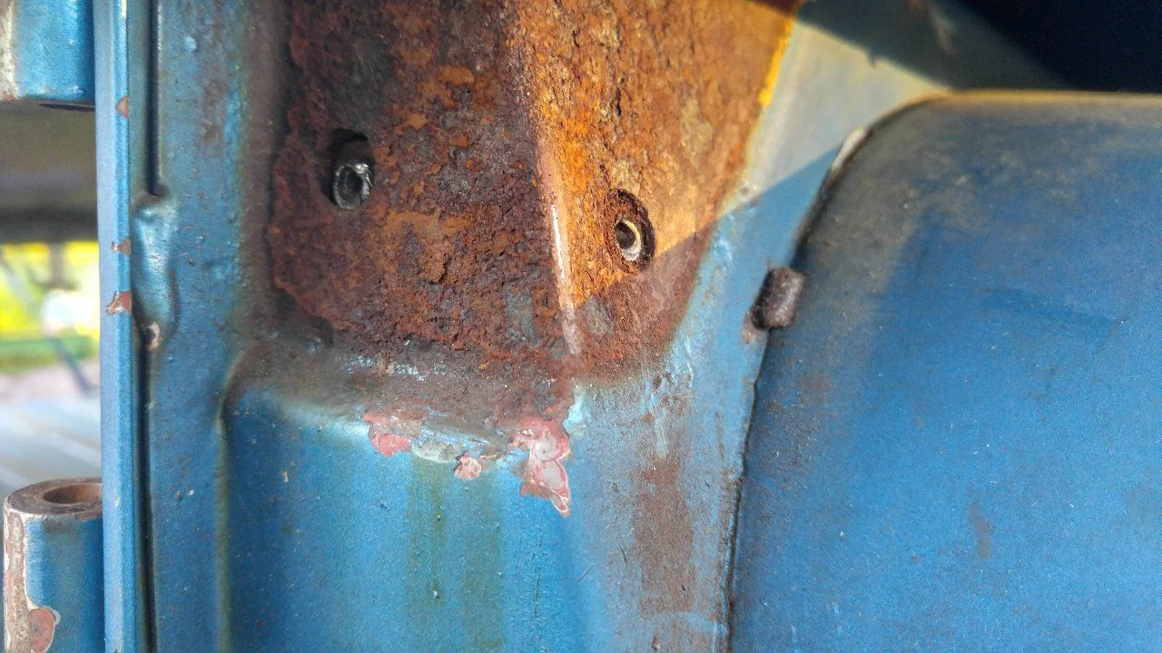

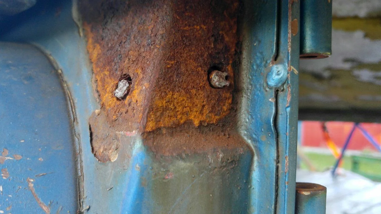

Well I did a little studying on my project this afternoon. Working out location of tub storage for the interim, but while doing a little closer inspection of the body I found some things that I believe will make full reassembly tedious at best.
Exhibit A. Both sides where windshield hinges attach...

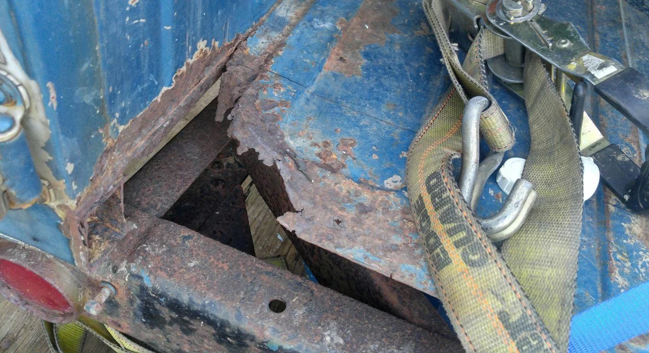

Exhibit B - rear door hinge mount

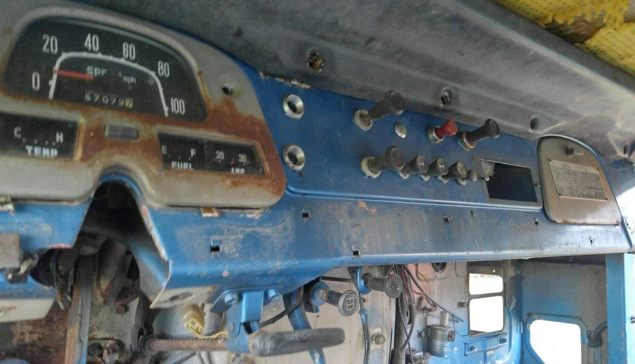

And in addition to that it appears That most of the wiring and or cabling was just cut out to facilitate parts removal.
So it would appear that when the body work starts I'm going to be sourcing a lot of little parts. The biggest pain is the pull cables. The blend door cables, heater control cables, pretty much all of them were cut to pull pieces out.
Also going to need a few patch panels, rear sill being on the top of the list.

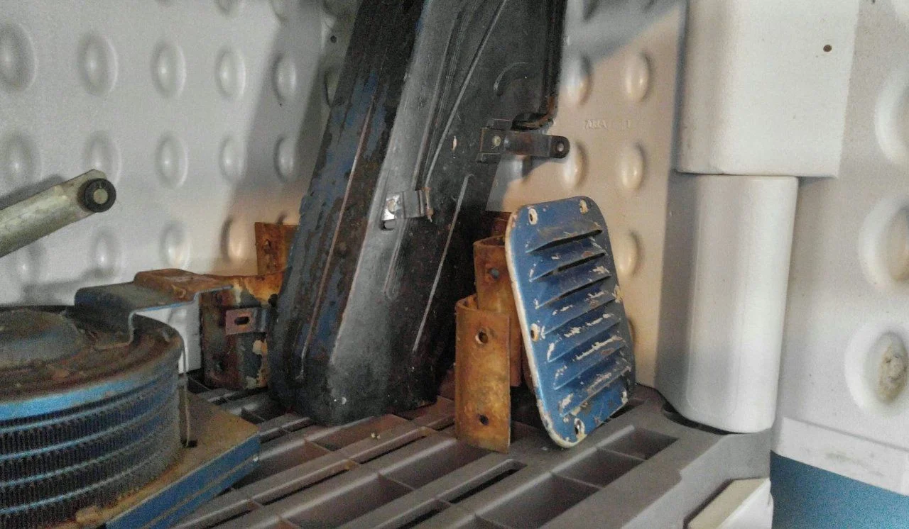

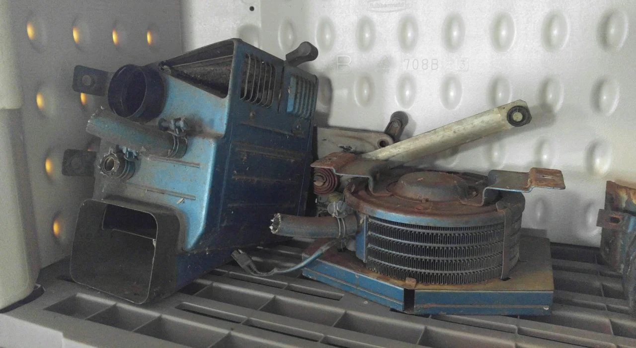

After looking over all that stuff I went into the totes to see what I could find. Most of it is parts from the F. Intake/exhaust manifold, starter, dizy, old waterpump, t-stat housing, etc. All parts that will most likely not be reused.
The heater box and Most of the various blower parts look to be there, but I honestly have no idea what I may be missing until I actually don't have it.
It also appears that all of the knobs and such are still in the dash.
I still have a good bit to go thru, but my general survey of things is that most all of the big pieces are most likely here, but there will be a good bit of cleaning and tapping and rethreading to do and a lot of small parts to come up with.
Its gonna be a long slow process, but I think in the end the juice will be worth the squeeze. Only bad thing is if I end up having to cup up and replace bits like the sill, fenders and windshield mounts, the body won't be far from just spraying the whole thing... Time will tell.
Oh and other than the rear sill, this looks to be the worst spot on the body.
