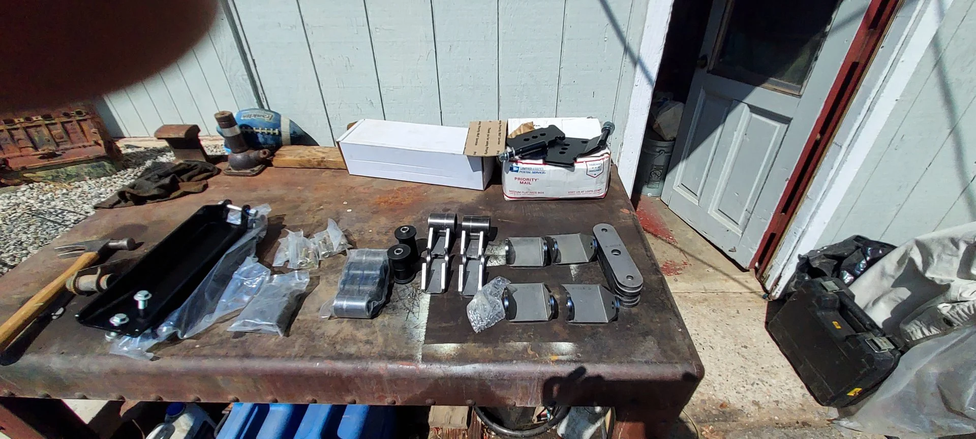

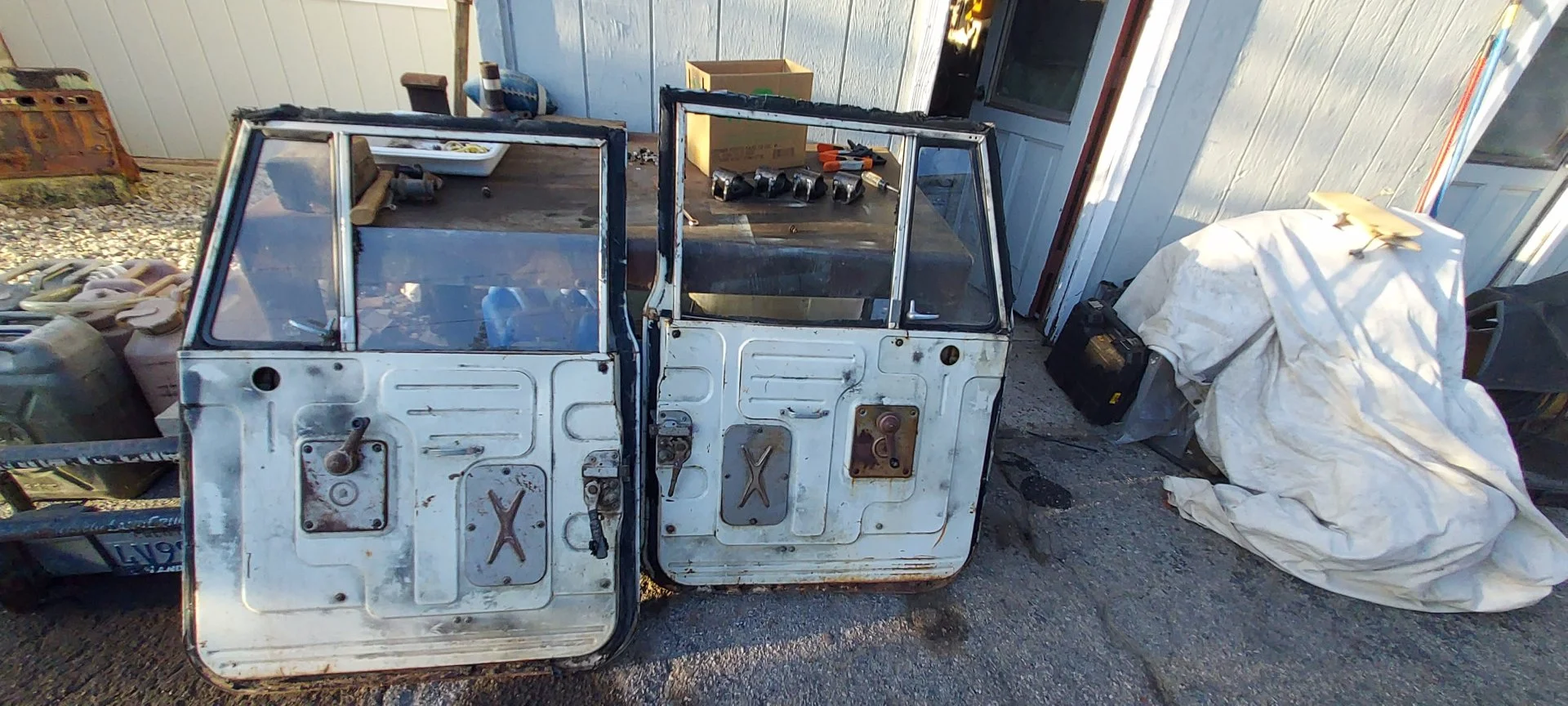

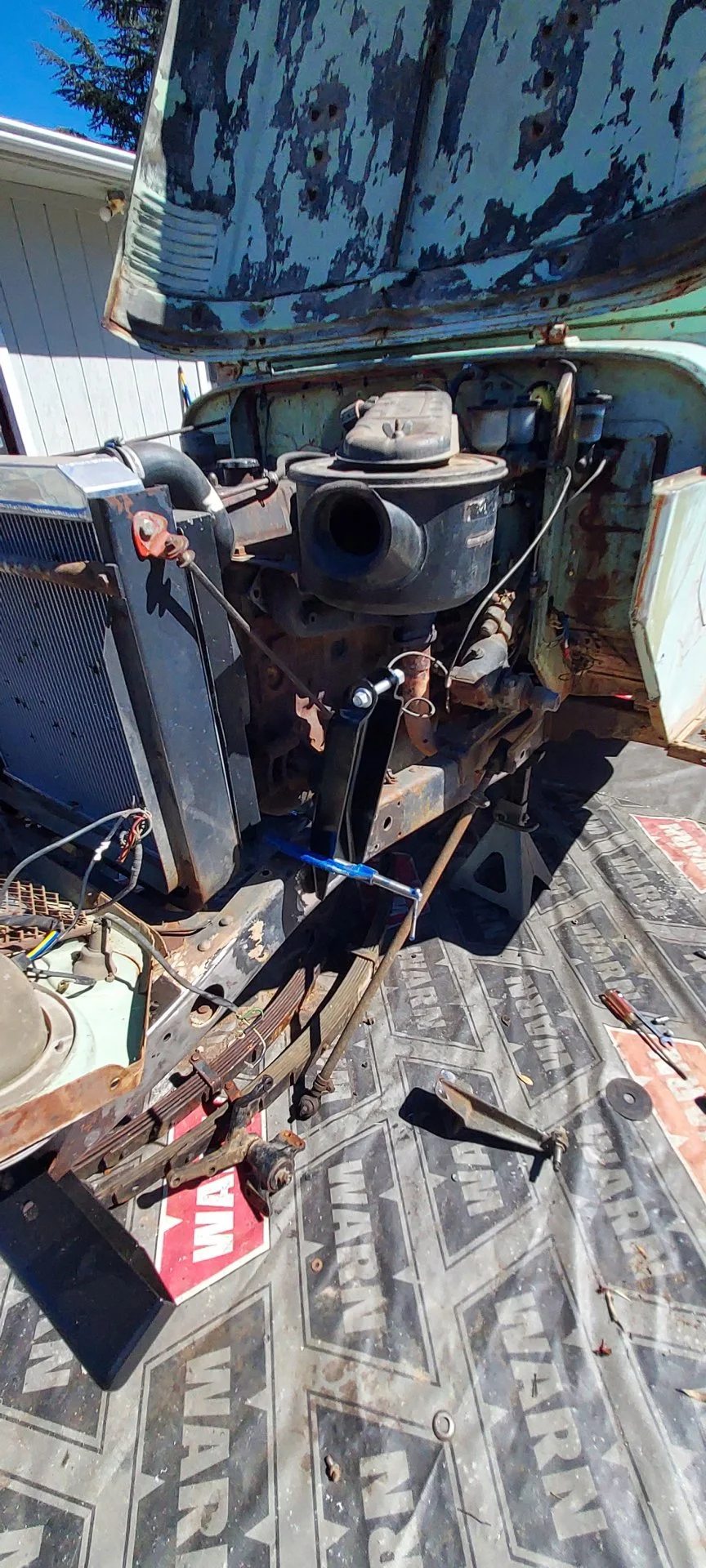

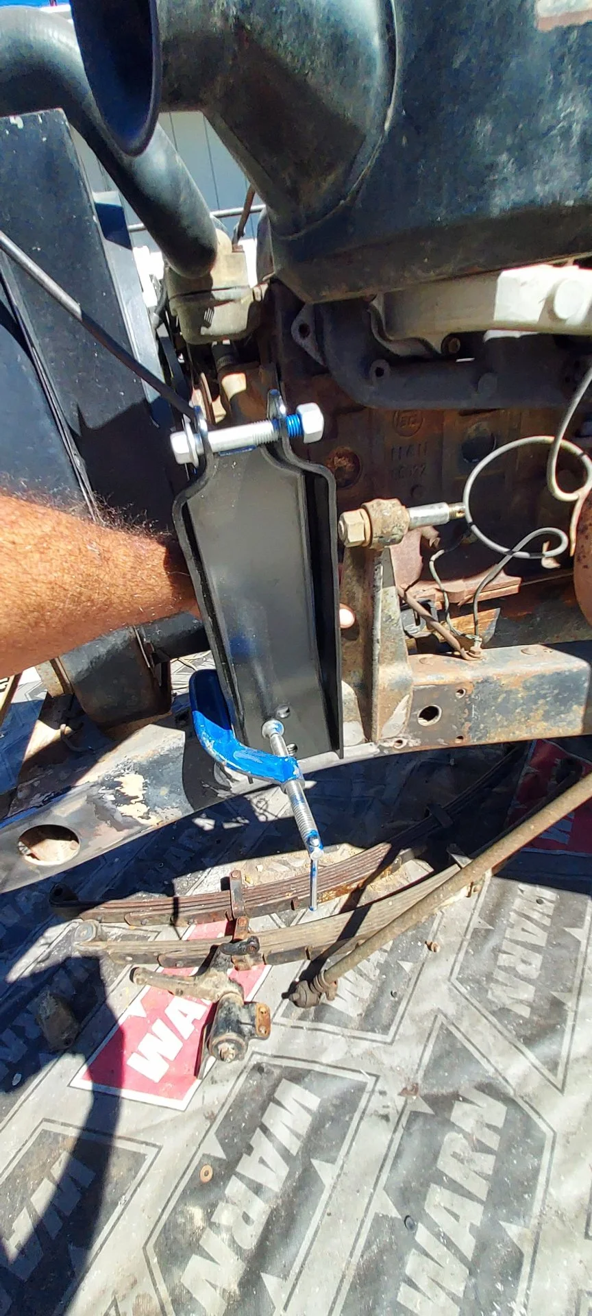

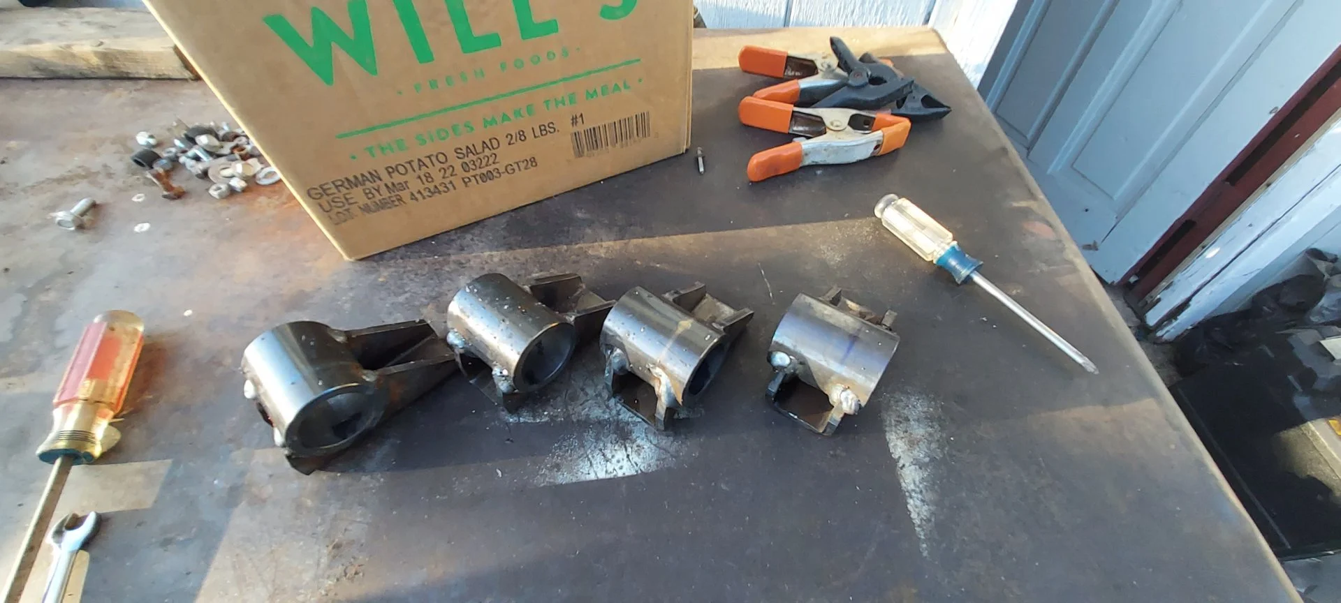

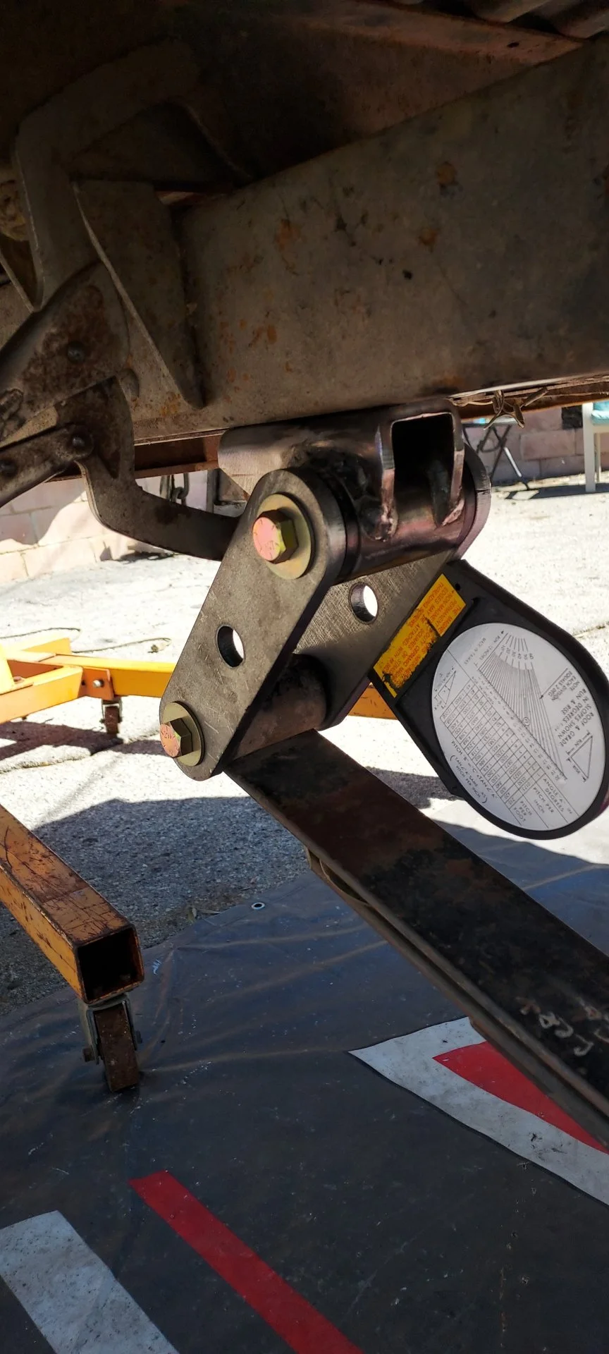

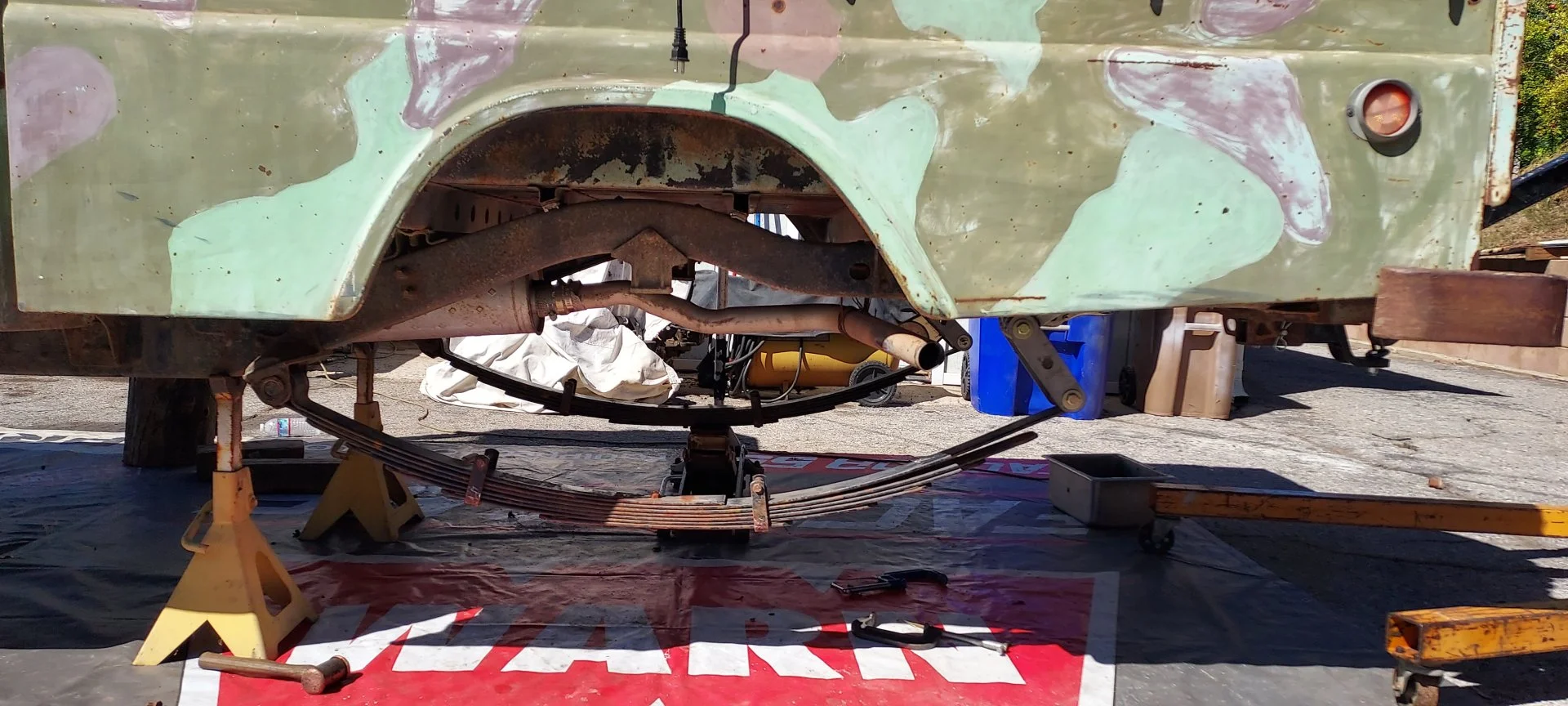

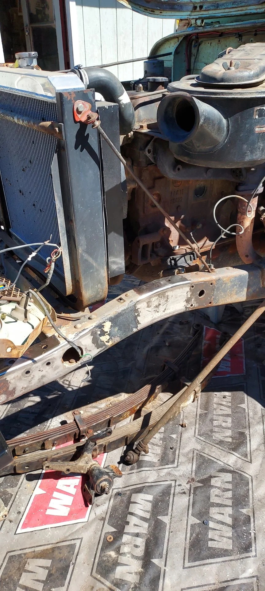

Purist step away. You all know I love my FJ45 and more than that Life and Adventure. So after receiving confirmation from the Race and Tech Directors. As long as all Safety and rules are followed we will be Racing my 1967 FJ45 in the mini/mid Stock class in the MINT 400. March 2023. 200 mile desert race. As you can see I have already started working on suspension upgrades, I want to Thank TLCA my family, friends and Rusty Nail racing for all the support. Its going to be Epic

Wow Rob, that is so cool! Are we going full long travel desert truck suspension! Need a chase truck!!! Cant wait to see this happen!
Justin gave me a set of Sky's springs the same ones he runs on the 4619. Looking for Raptor 3.0 shocks. Lots of surprises coming up for this build. @orangefj45 Valley Hybrids and Cruiser Brothers are really coming through with parts. The community has been awesome. It's going to be Epic

Dan and his crew have helped tremendously over the years and still are in this project. I've spent a lot of time going over our game plan. It's all about the suspennsion that's why its all over kill. Sky's Off road design springs, Ford Raptor 3.0 shocks, Dimond front axle housing, FJ60 knuckles, fj60 tie rods and ends, later 1974 steering center arm, FJ62 4:10 3rd members, full safety Mint tech and 22 gallon Jazz fuel cell. Full cage and bed hoop plated and welded to the frame. That's the short list LOL
