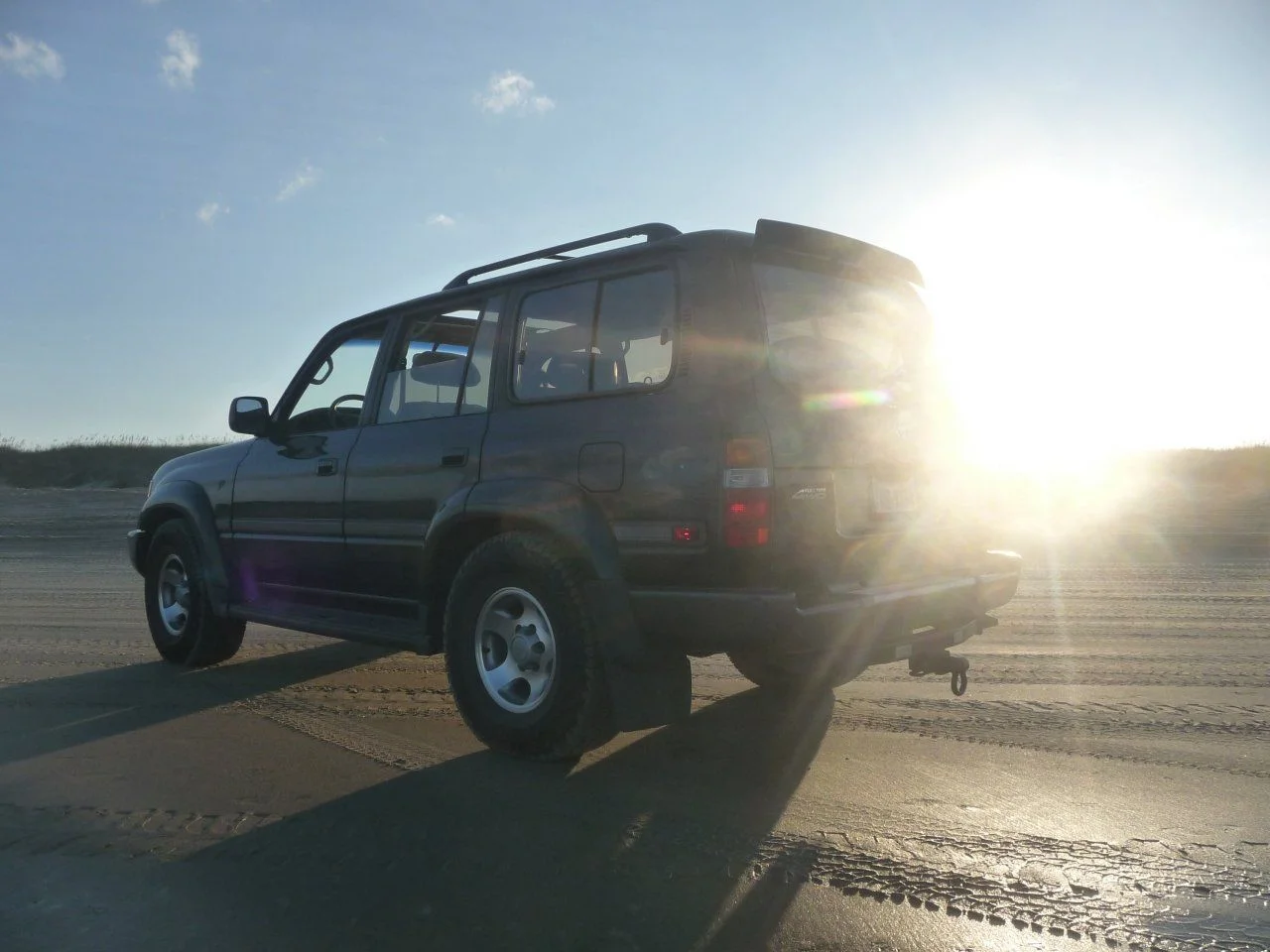

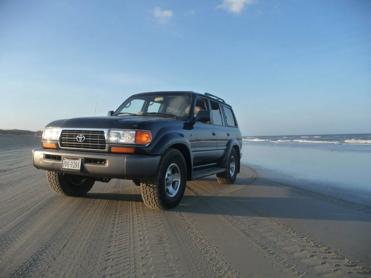

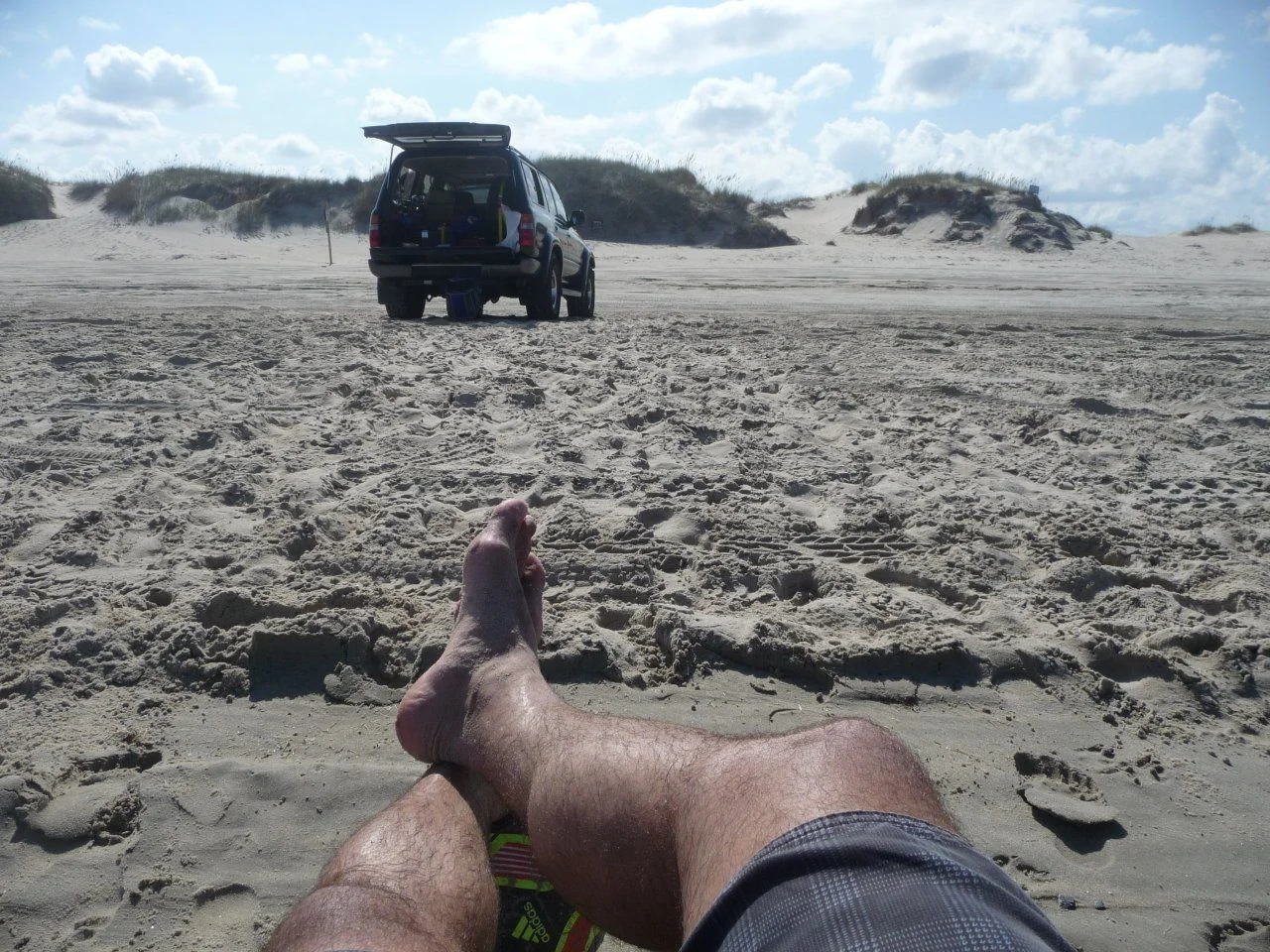

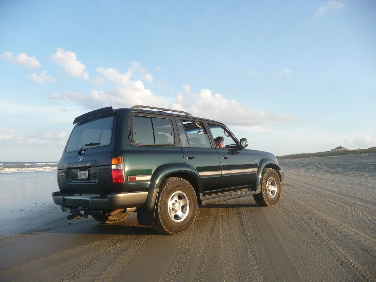

First "Poser Pics" of my truck since I purchaed in November 2013:
