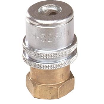

http://www.gemplers.com/product/G27273/Clip-on-Air-Chuck
It has a ring that slides up and down to push in three sets of teeth that grab the valve stem threads securely.
I replaced the poor quality locking chuck on the inflation gauge with the above one.

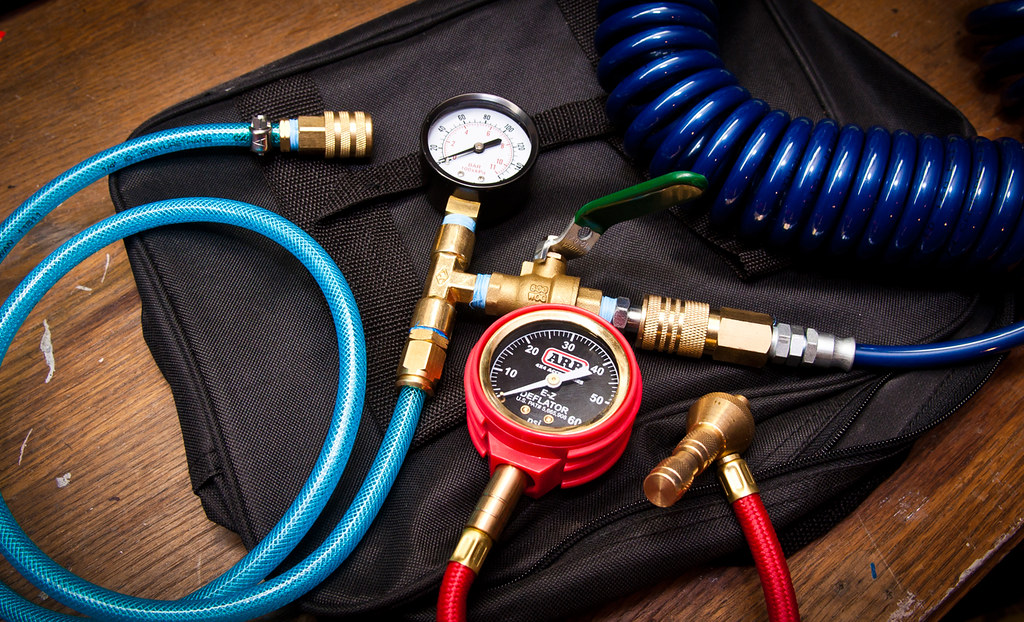

If I ever have to replace it, I'll just put a T with a dial gauge between a ball valve and that locking chuck.
Thanks! I bought a similar inflator at Home Depot. I'll see how the screw-on chuck works. I did consider making my own using a tee, a valve and a pressure gauge. If the screw-on chuck works well, I'll return the inflator to Home Depot and build my own.
