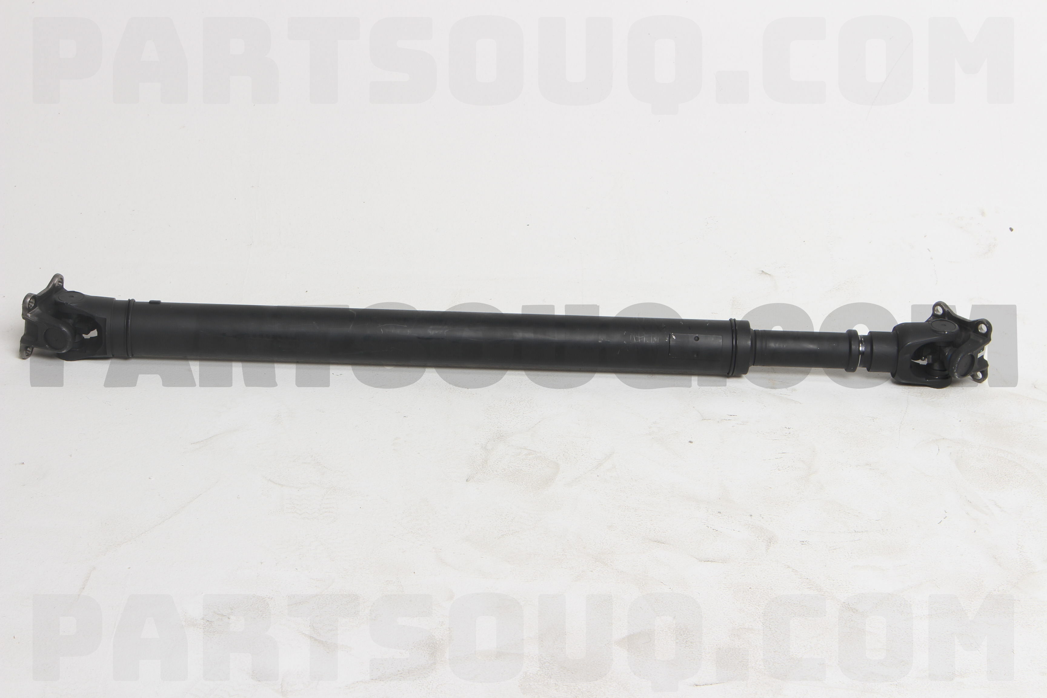

So now I'm a bit confused. I tried to find some other pictures of brand new shafts to see their orientation.

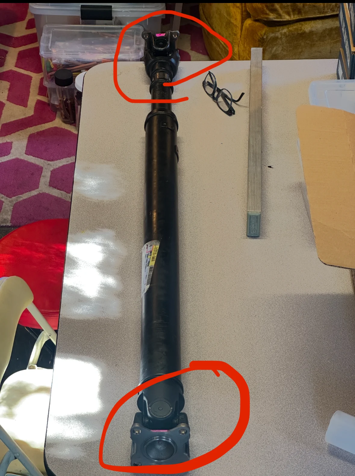

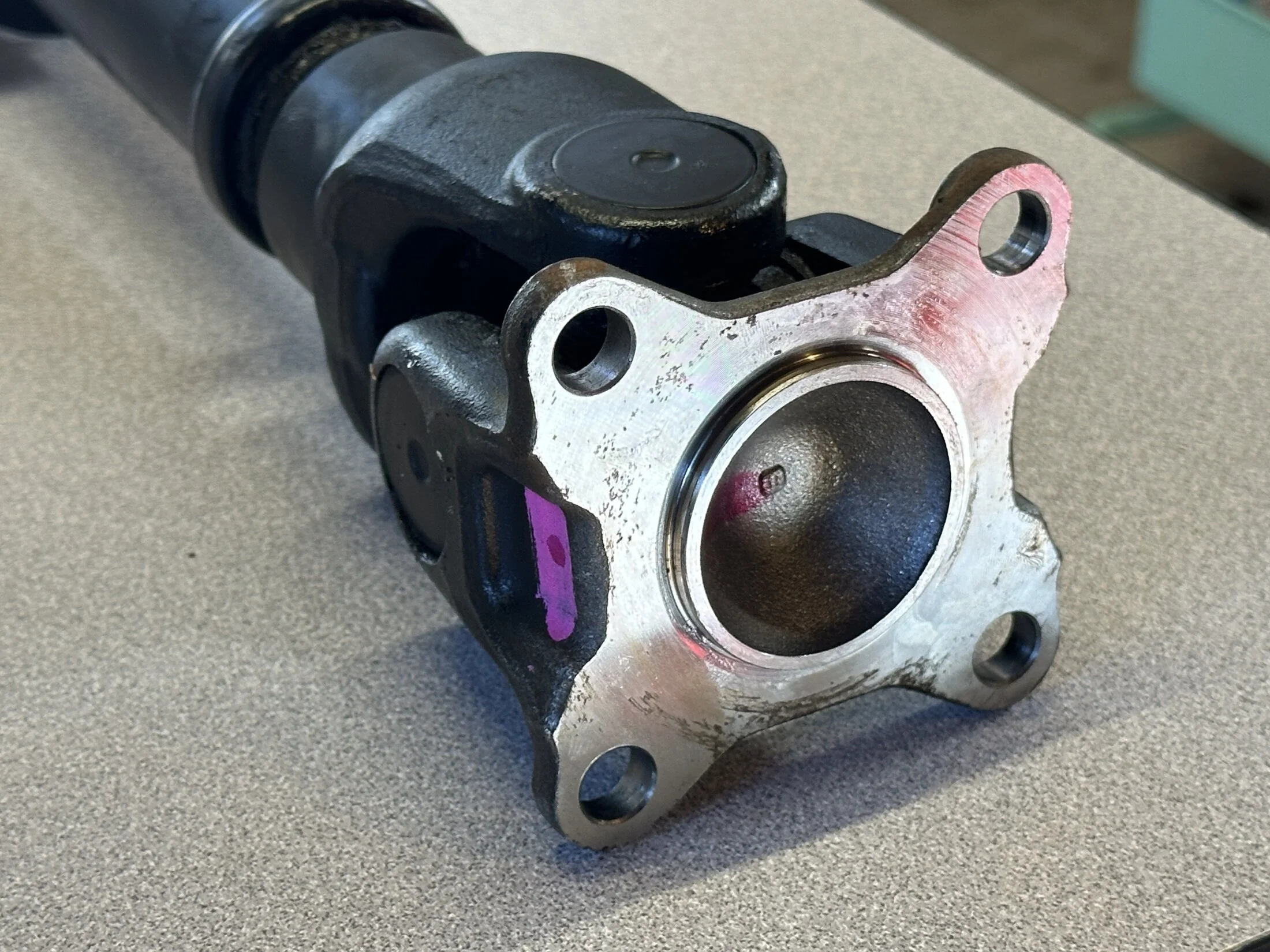

Curious if anyone here has any advice on alignment here? Did your new shaft come with paint marks indicating an in phase or out of phase alignment?
Pink marks very similar to the white ones on my old shaft. Just out of phase:
This is .... weird. I know, very clearly, that unless you have a driveshaft with ZERO angle between the front and rear yokes, you MUST have the u-joints installed in complementary angles because the u-joints are not CV joints, and therefore, change speed as they rotate. This manifests as a vibration, and the larger the angle the shaft is at, the more drastic the speed change/vibration. The complementary angles ensure that as one joint speeds up, the other joint slows down by an identical amount.
I've seen the u-joint thread from the 80 series in the past and I truly can't wrap my mind around why it would be different for their chassis. On the 100, the angle between the transfer-case and the front diff is minimal or non-existent, so it seems likely that screwing this up would have minimal effect on the front (I have not tested this!).
I know there's a big belief that "Mr. T" is always right, but this sure looks like a major screw up. I know this isn't really what you want to hear, but your path to quickly determining whether this shaft itself is the issue is probably to just buy another shaft, or find a local shop that can balance the driveshaft you have now.

This is .... weird.
Weird indeed! Yeah, I think my next steps would be to bite the bullet and just take it to a driveline shop. But I've also read that new parts have a 12 month warranty? I ordered this shaft from Serra Decatur during one of their mega-sales. I know many dealers don't want to ship driveshafts due to damage, but they seemed to have packed this shaft well. I looked over it in detail this weekend and there wasn't any dings or areas where missing weights had been ripped off.
So yeah... weird....

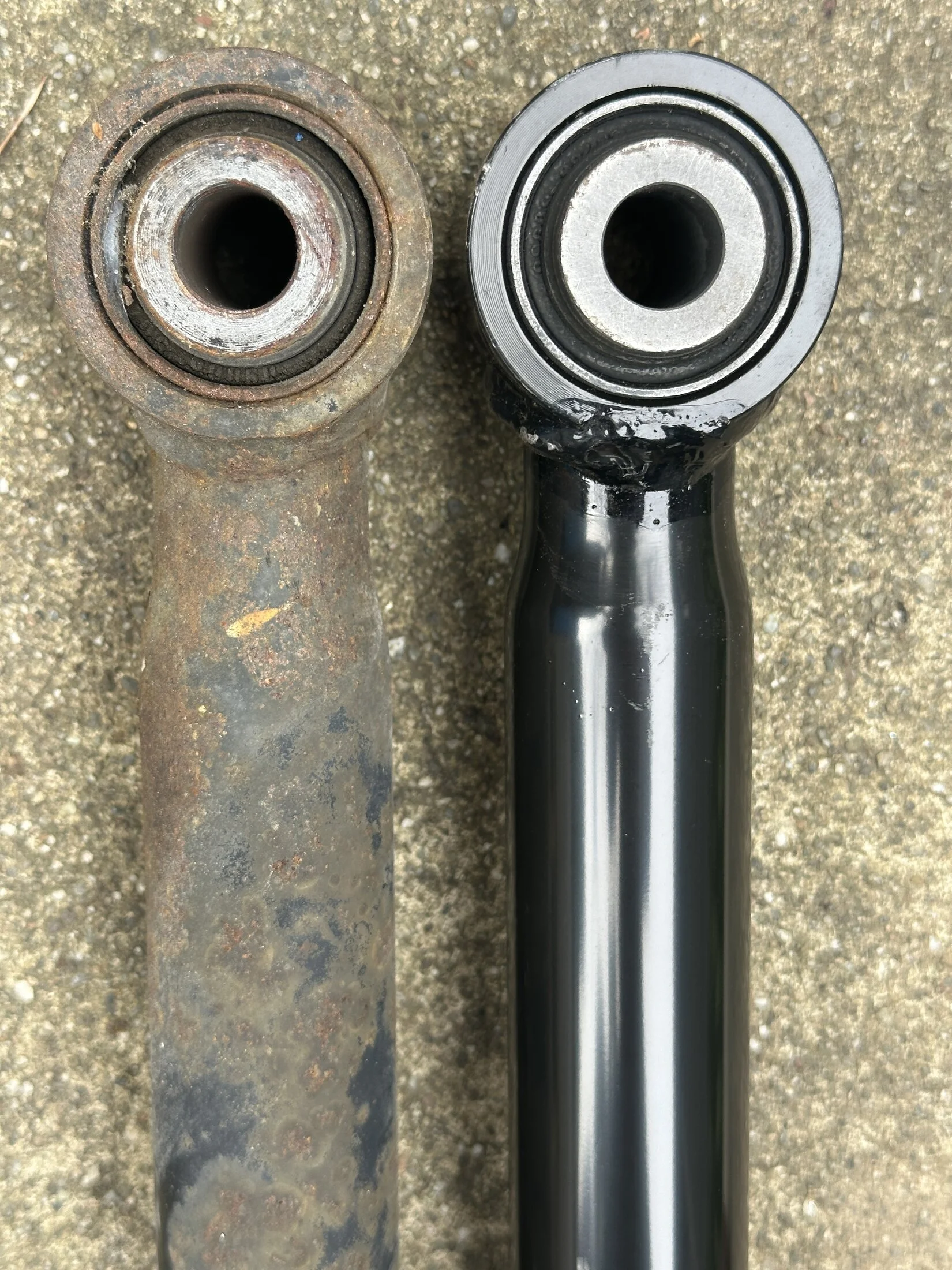

I'm still finding this hard to believe, but I swapped out my rear sus upper control arms and it appears to have made a major difference! I also put the shaft back in phase (even though the pink marks indicate otherwise), and with the new rear arms in, I'd say the overall vibration and noise was cut down about 60-70%. Which is blowing my mind.
Could just two new arms do so much? I've had really good results replacing other hard rubber parts in the front with new motor/trans/diff mounts, but I'm still surprised by this. I'm guessing it won't do as much, but I still went ahead and ordered the remaining lower arms and panhard rod arm from Impex. Will take a few weeks to get here, but I gotta try it now.

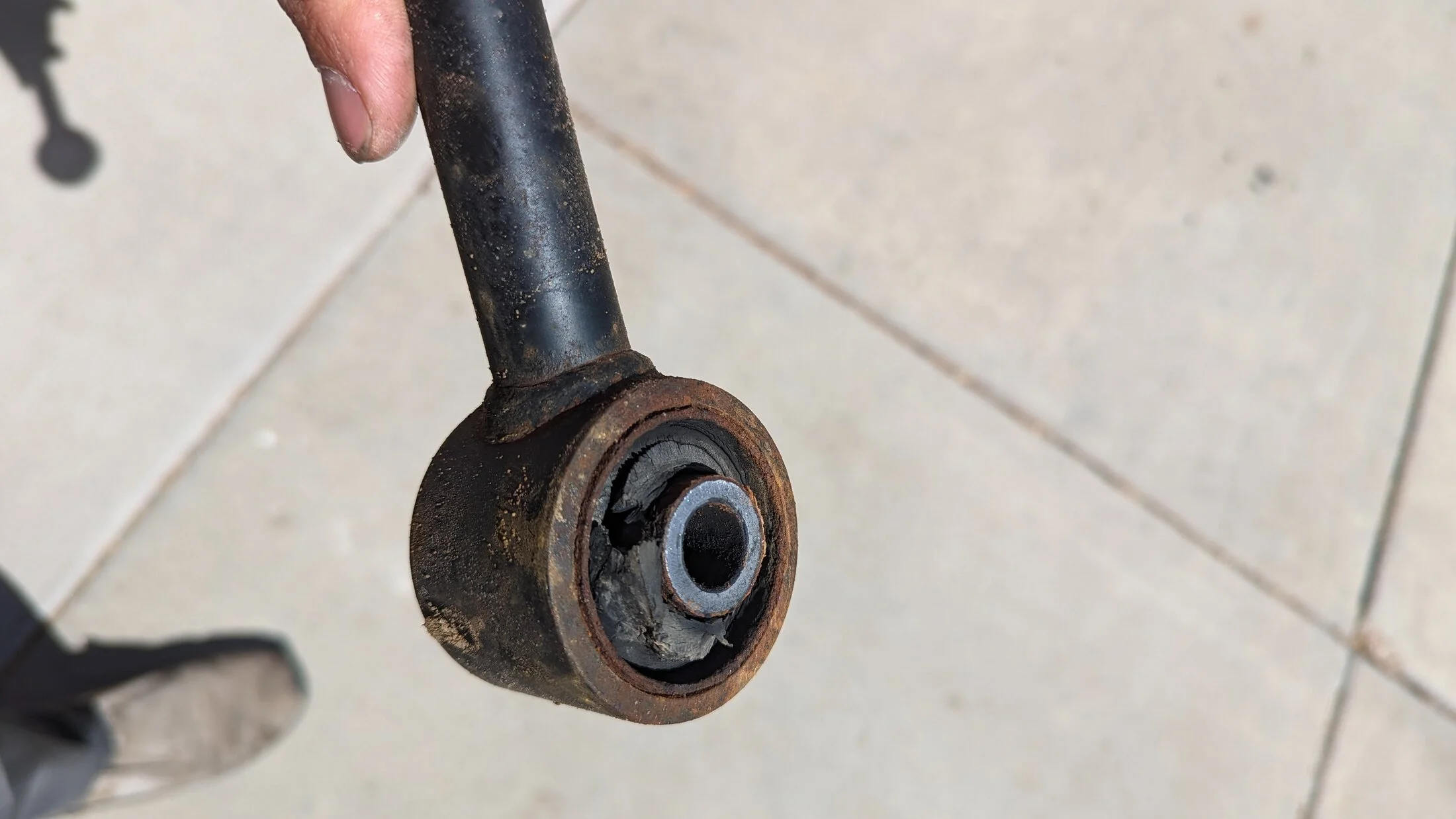

Even though the old ones didn't have any tearing, the rubber was of course hard as a rock:
New and shiny!

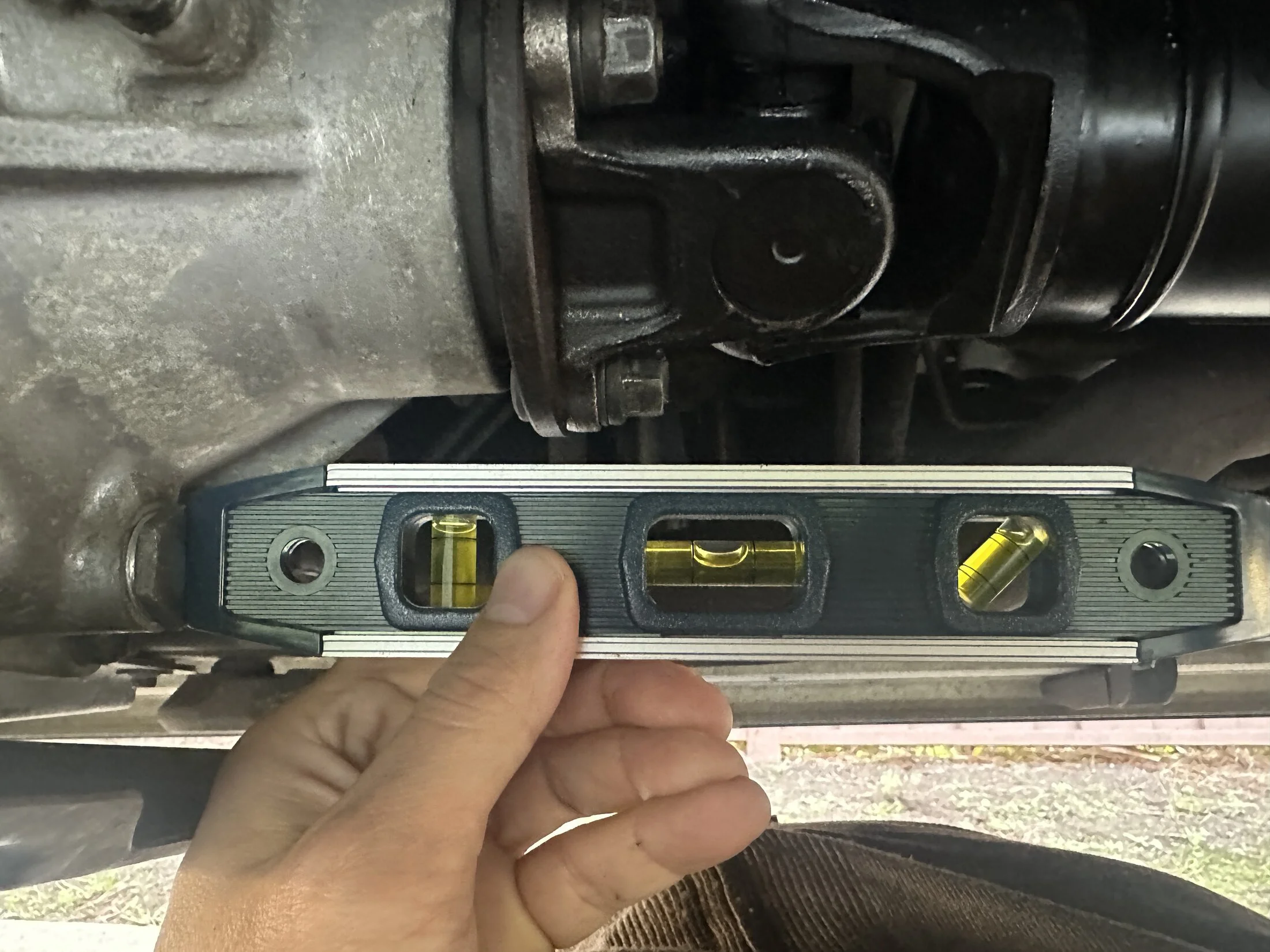

Good news! Can you do me a favor, and take some pictures showing the driveshaft angle at the transfer case and rear diff?
I tried my best here, but not sure if these are helpful or not. :oops: Hard to get the camera angle just right here. In general it seemed like both the diff and transfer case are pretty darn close to 0 deg. The rear diff might be angled up just a tad, and the transfer case might be angled DOWN just a tad. From what I've read you actually want them to both be angled up or down?
Just for reference this is with new motor and trans mounts installed about 5k miles ago. And of course the new rear upper arms this week.

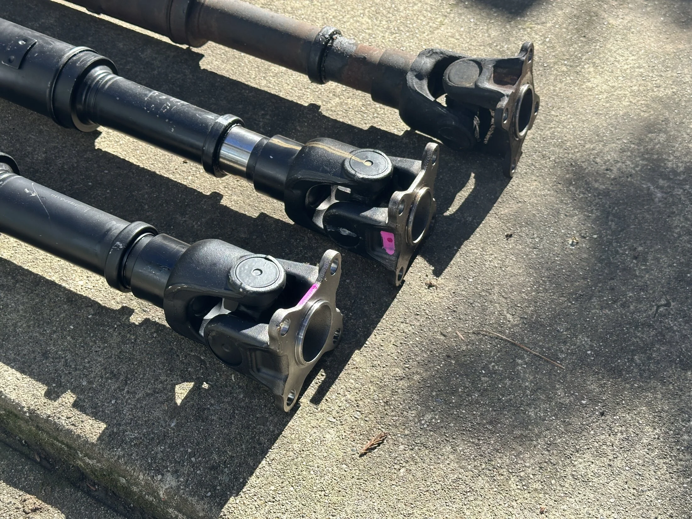

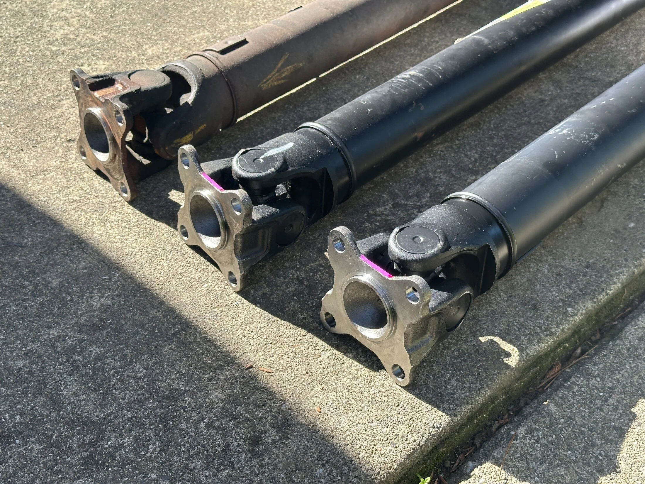

Three driveshaft walk into a bar...
Two appear to have been balanced in phase, while one does not!

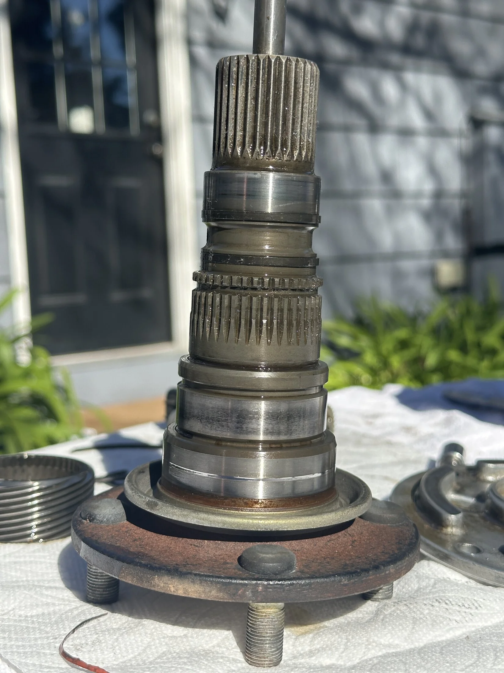

Transfer Case Rear Bearing: No Change
I was convinced it was going to be the transfer case rear bearing just like @LJE had. Took it all apart and once again sad trombone. The bearing was fine. Maybe a teeny tiny bit worse than the brand new bearing I put in, but nothing like what @LJE had. Was really surprised. I put the new bearing (and seal) in anyway, and took it out for a drive. No change.
I read in the 80 series forums that folks there have had this bearing go bad as well. But for the 100 series folks it seems like just one person so far.

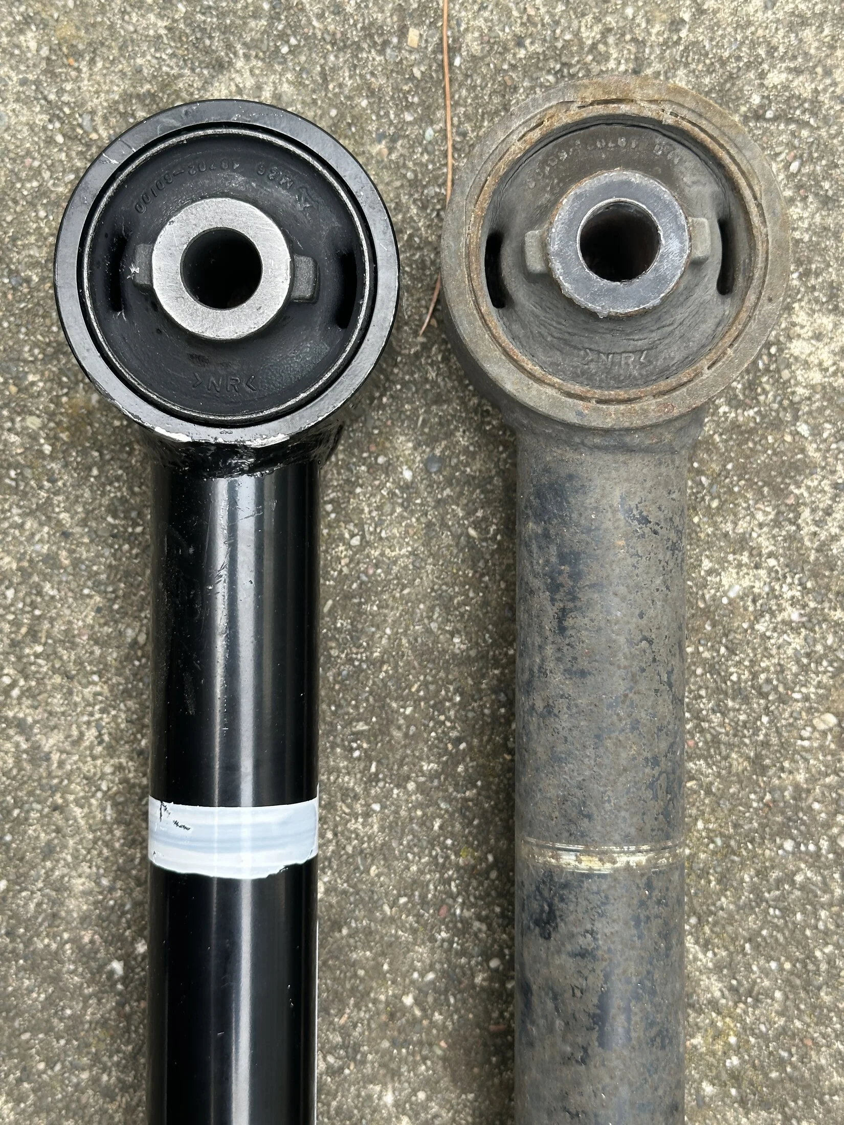

New Rear LCA and Panhard Bar: Tiny Improvement
After I had felt some small improvement with the rear UCAs I went ahead and ordered new rear LCAs and Panhard bar from Impex. Shipping was fast with DHL once Impex got them in stock, but that took a few weeks. In any case, they finally came in and I quickly installed them. Once again sad trombone. The rubber in the old ones were as hard as a rock, but still in solid shape. It seemed to mute the vibrations a touch (just like the rear UCAs had done) but there was still basically the same drone and vibration.
At least one side benefit is the ride is indeed a touch smoother and the final bit of idle vibration that I had is nearly gone. (Changing the engine mounts also helped greatly for idle vibes)

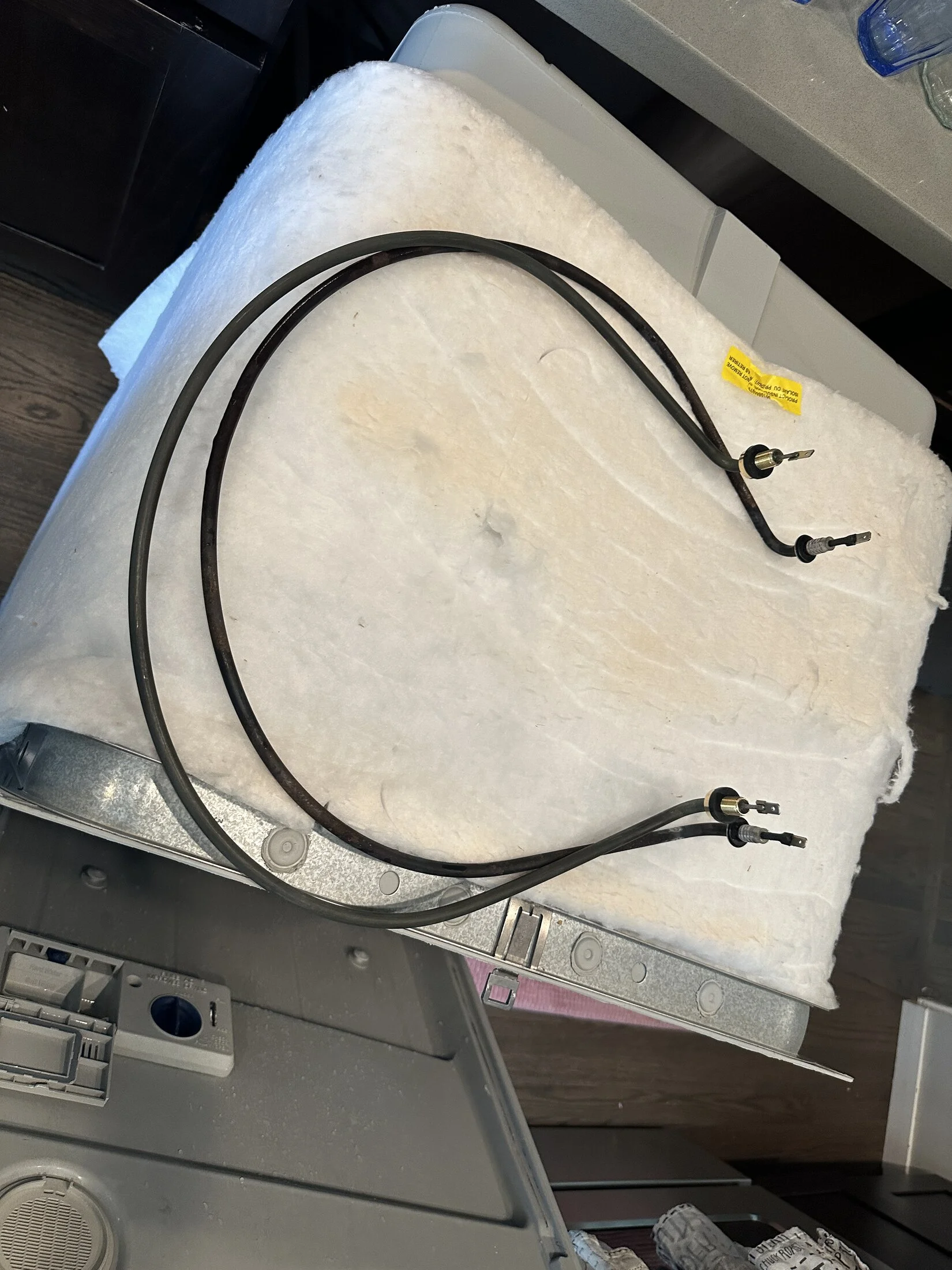

FINALLY SOME GOOD NEWS! At least I was able to fix our dishwasher during this time. Changing out the heating element wasn't too bad and now our dishes dry!

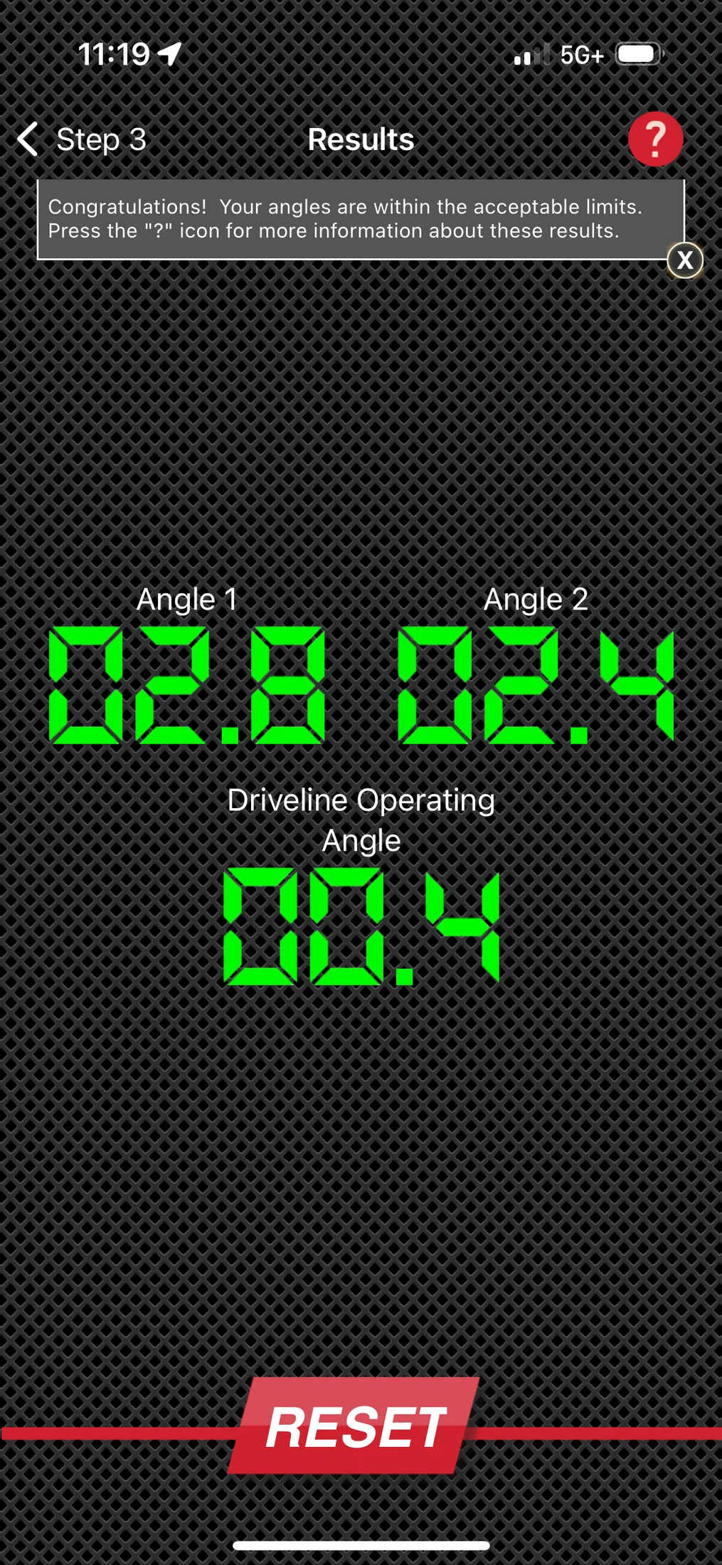

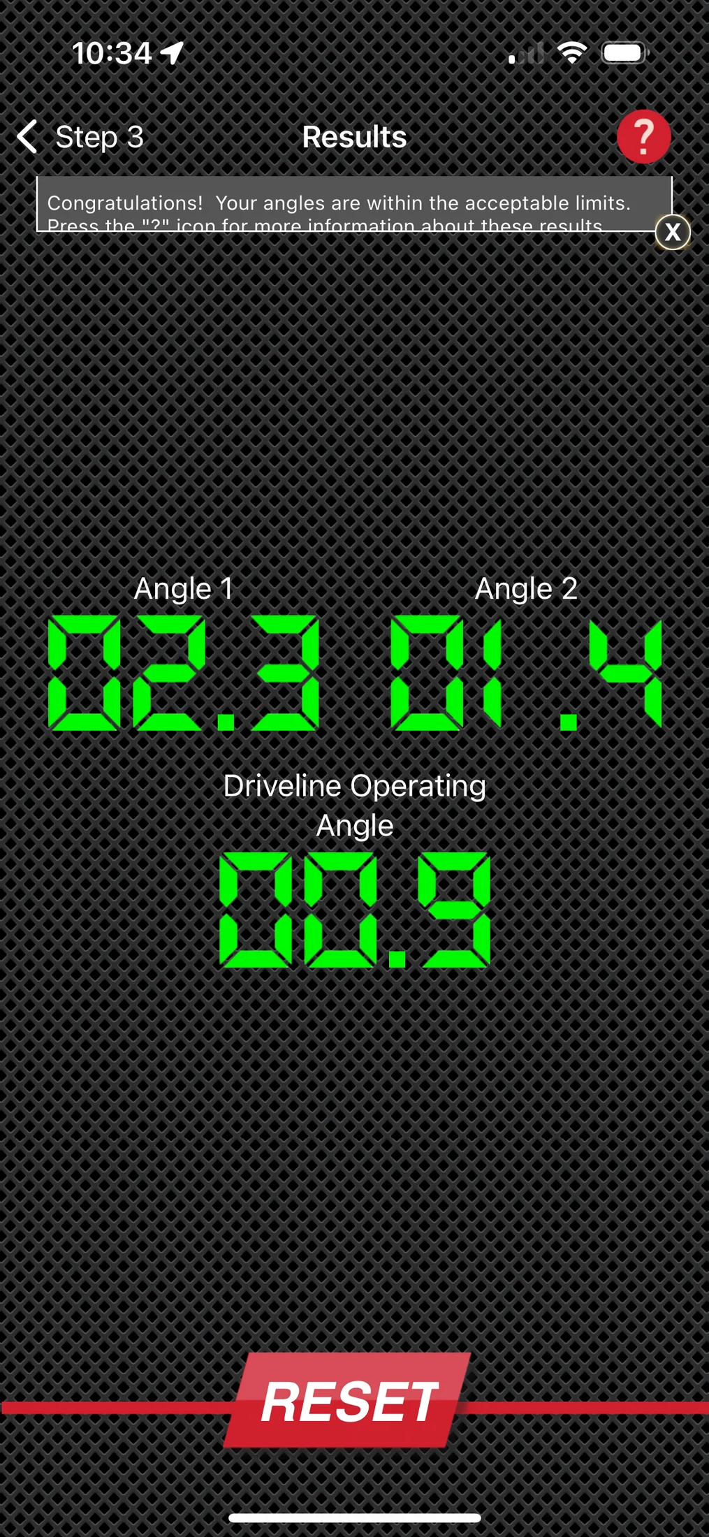

Here is some slightly more accurate data. I used the Tremec app (its free) to get these. I ran it a few times, and most of the times it was close to these numbers.
In these cases "Angle 1" is the TC and Angle 2 is the Diff angle.
So it seems like both of them are pointing slightly up? Less than 1 deg diff so should be okay?
Edit: See the post below for what these actually mean
Yeah - those angles sound pretty ideal. I need to do this with mine yet again. Adjustable links can be a real pain in the ... backend. Everything I've read (and checked on my truck) has said that the tail end of the t-case should have a very slight up angle. I think that means the pinion flange should have a very slight down angle to match.
So I was getting confused with the Tremec App and while it was giving me "green" numbers I couldn't figure out what they meant by "Angle 1 and 2"
Then I figured out the app is trying to look at not not 1, but 2 things.
1. Is your TC and Diff pointing in equal and opposite directions. They should ideally be parallel
2. It is also looking at the angle between the driveshaft and the TC (aka Angle 1) and the angle between the driveshaft and the diff (aka Angle 2). According to the app you ALSO don't want these angles to be big.
In other words, you could have you TC pointing at 0 deg and your diff point at 0 deg (which is parallel) but if there is a large vertical difference between them, the driveshaft angle will have to be large. (aka lifted truck) So this is also something you don't want according to Tremec and they suggested it should be no more than 3 deg.

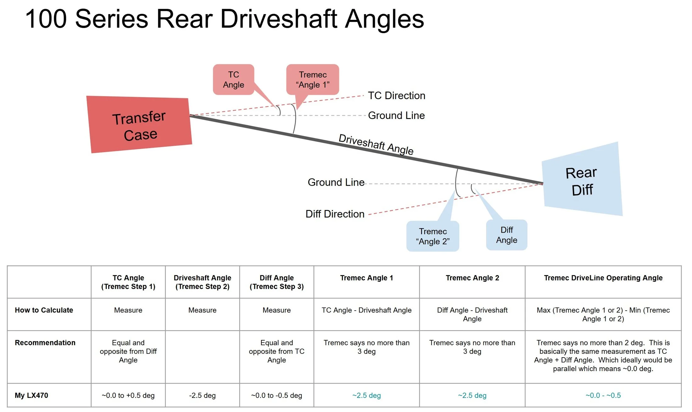

After measuring some more today I made this chart to help me understand it more.
A few things I noticed:
  • The Tremec app will show you the TC Angle, Diff Angle, and Driveshaft angle when you are measuring them, but they they aren't included in the "final results" So just write it down while you are doing the measurements.
  • The good news is my TC and Diff seem to be pretty parallel. It is hard to get exact numbers here, but they both seem to be close to 0 deg. The TC might be pointed a touch up, and the diff might be pointed a touch down, but they are close.
  • That being said, with both of them at zero-ish, that actually puts the "Angle 1 and 2" at close to the 3 deg recommendation from Tremec. And this is in a bone stock truck. And in this bone stock mode, the driveshaft is at a -2.5% angle. So in other words, it might almost be worth trying to point the TC down a touch, and having the diff point up a touch.
  • For those that want to dive in more, this site helped me today understand it better: How To Properly Measure Driveline Alignment with the TREMEC Smart Phone App - https://inthegaragemedia.com/blueprint-your-driveline/
As far as how this relates to my vibration, I have no idea. Even though the TC and diff appear to be properly set parallel, I do wonder if the new motor mounts and trans mounts I put in changed the TC angle in a major way. But then when I changed all the rear sus arms, it should have moved all that back to stock angles as well. I wonder if there is a way to monkey with the TC mount to get it to point down a touch more? Anyone ever played around with this? Instead, it seems like most people get adjustable rear lower sus arms and try and point the diff up?
