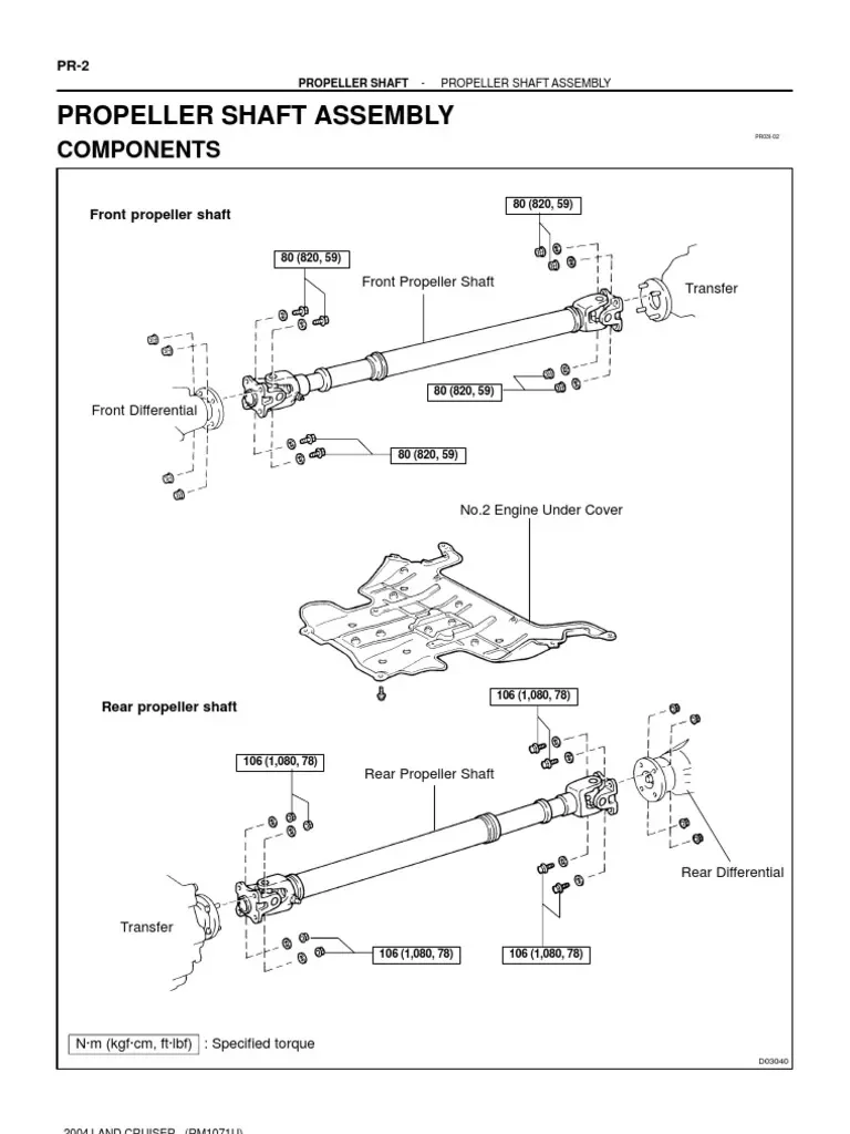

FWIW, what worked for me was re-indexing the front drive shaft (prop shaft) by 1 spline. I find that this drivetrain is super finicky when it comes to vibrations. I also made sure to properly lube the prop shaft splines by hand, when I had them on the workbench -- even though they were brand-new. Not sure if the spline index was indeed off by 1 spline, or somehow this slight adjustment satisfied some natural imbalance my truck had. For the past 2 years, I've been replacing every drivetrain and suspension component: UCA's, LCA's, Steering Rack, Outer Tie Rods, CV Axles + flanges, Prop Shafts, Front wheel hub bearings. ALL of the rear control arm & panhard bushings w/ the SuperPro poly set, front/rear stabilizers, pretty much everything outside of the big heavy stuff.
That is a good data point. To confirm, the drive shaft you re-indexed was a brand new, unused unit from Toyota? I find it hard to believe (but not impossible I suppose) that my brand new shafts are somehow out of balance. Thanks!
Correct, OEM shafts from Toyota, brand-new. I was experimenting with the orientation of the driveshafts and how they affected that vibration at highway speeds that I was trying to get rid of -- I knew it was speed dependent and had nothing to do with any specific gear that I was in -- neutral also vibrated at 70+mph. I found that my vibes quieted down when I had both shafts in a specific orientation. Just by rotating the shaft 180deg so that end that was previously attached to the Transfer Case was now at the Front Diff flange made a difference. So it might be good to see if slight position changes make a difference for your truck. Also, not sure if you have AHC, I do, and adjusting the height sensors and effectively the height of the vehicle, affected the driveshaft angles and vibes. So yeah, before you separate the two halves of your driveshaft and try re-indexing, you could experiment with removing one shaft, rotating it 180deg and seeing if there's any change. Just be sure to mark the orientation of everything.
Some good nuggets in here, thank you for the assistance. I wanted to update that I pulled the rear driveshaft (which is also brand new) and the noise I was hearing at 75mph is completely gone. I think the rest of what I'm hearing are some very perished 250k mile bushings in the rear arms, but we'll save that for another day.
I'm going to rotate the driveshaft 180 degrees to see if that changes things. Also, I noticed my slip yoke is closest to the transfer case and not the rear diff, unlike your diagram. Did that change for later years? Does the orientation truly matter?
I don't think that driveshaft orientation changed across the 100 Series. I believe the 80 Series had different phasing, but orientation of the slip yoke shouldn't matter -- but for me I have it like the diagram and that helped eliminate the intensity / frequency of some of my highway vibes. The slight re-indexing took care of the rest. I have to add that I had severe vibrations prior to installing new OEM CV's + front wheel bearings & hub flanges. The remaining high speed vibes were fixed by messing around with the drive shafts. Replacing the bushings made my cornering feel more solid, especially on windy roads with changing grades. It tightened up the handling, but I don't think it would affect high speed vibrations.
Tried the new OE driveshaft in a different orientation and no dice. Put my original that I suspect has worn u-joints and it's quieter and doesn't have that vibration at 75mph. HUH?!
Could this new driveshaft be out of balance? Going to attempt to return/warranty it. Wish me luck.
