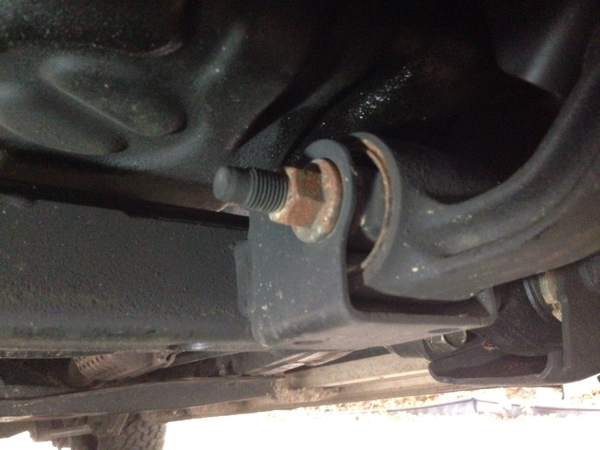

Anybody tried fixing driveline vibes by replacing the front differential control arm that attaches to the cross member?
The bushing inside mine looks worn so that the diff sits at a different angle than it would be with a new bushing. Maybe they all sit like this new? Thinking of replacing to see if it helps cure my driveline vibration that starts at 60-65 under low loads and disappears under hard acceleration.

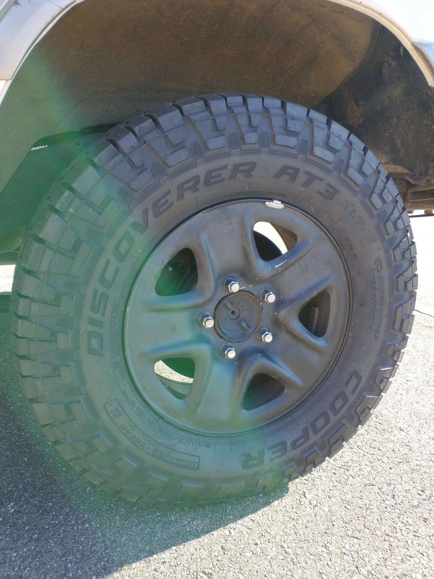

So...vibs gone...with new tires!! Crazy. Lesson learned...even if your tires have been balanced and have decent tread left doesn't mean they are okay internally. I think the 6 year age and 65k miles were enough to start feeling flaws in the tire due to age.
Abuck99 was spot on.
Went with Cooper Discoverer AT3s...super happy

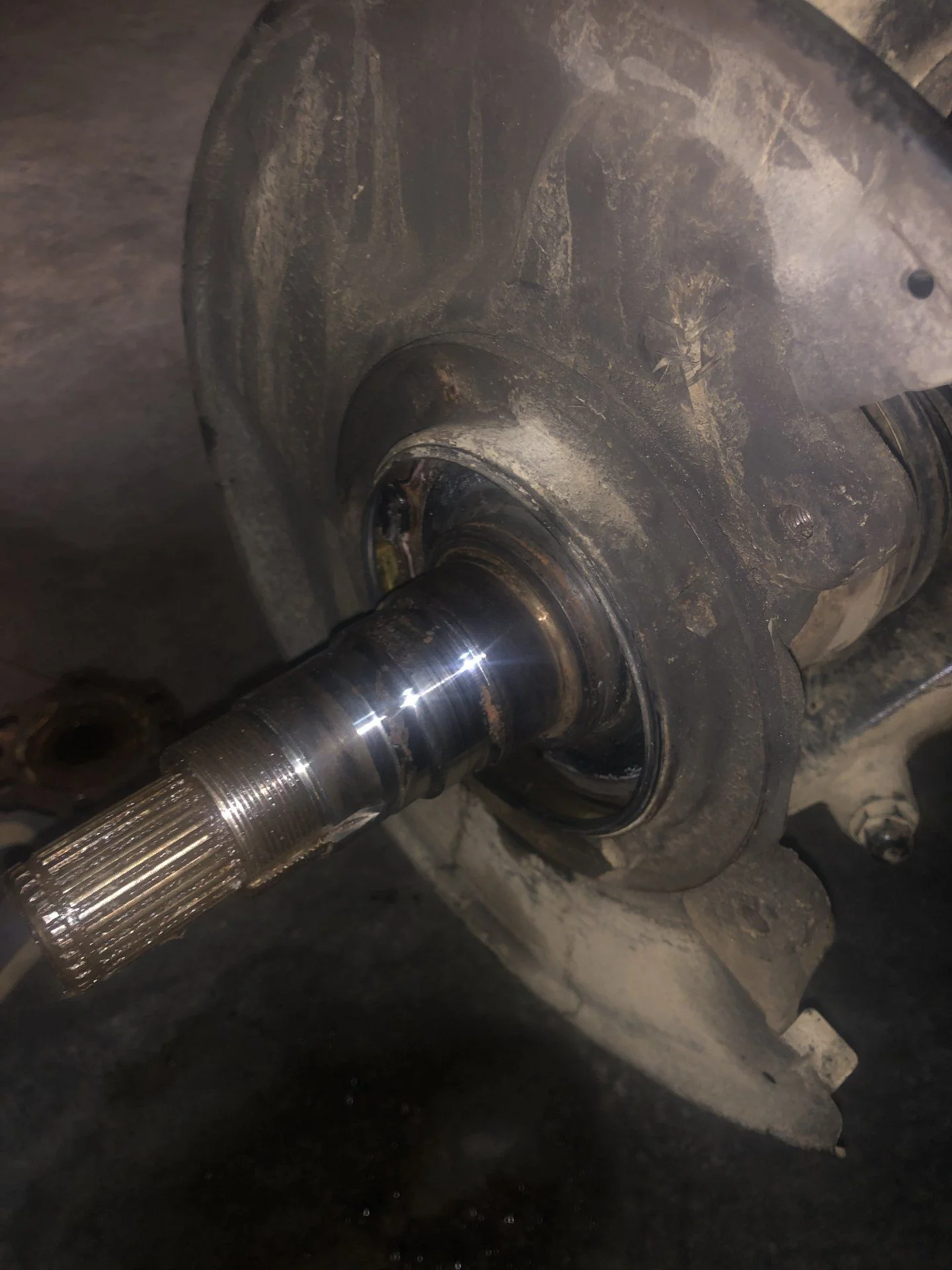

Alright, last night I took apart the drivers side and theyre admittedly...not great, but I cleaned everything out, packed them with grease, greased the needle bearing really good....and the noise sounds exactly the same, like no different. Drivers I assumed would not be great because this is the side that the axle slip out this summer and you can see some damage on the spindle surface. But even if the bearings are not great I would have thought repacking would do something to the noise. It could still be the passenger side and it could be I guess that the needle bearing is just shredded and I need to replace that. So I ordered 2 needle bearings, 2 needle brass bushing, 2 seals and 2 sets of races, wheel bearings, and seals.
Wheel bearings items come today, but spindle-needle bearing kit doesnt come till Friday...however I kinda need the car. So the bearings are packed with grease, the spindles greased, the breakaway is right, its the smoothest spin but nothing crazy, and again there was no play in the bearing so they weren't loose. So I'm debating if I can drive to work 25 miles x2 a day Friday and replace the spindle bearing and see if that takes care of the noise.
Welp, guess I should probably do the responsible thing and drive 2 hrs to fredericksburg to get a used kunckle/spindle assembly for $80. Car it came off had 230K...wondering if I should grab the passenger one while I'm there with my luck....
Here's the spindle 🤦‍♂️, might have undersold the damage...obviously seal failed and water got in, plus some pretty good heat and gouging of the surface mostly from axle slipping a while back...guess its hard to know what is ongoing damage and what was from a one time event. Pic does kinda make it look worse...but its also pretty bad...
Welp, at least you know what needs to be fixed!
Hopefully, I'm going to fall to ground crying if I do this and the noise is still there. Or if my spindle bearing is anything other than destroyed. I ordered some parts from CruiserTeq some from Mcgeorge Toyota and some from Rockauto so now its just trying to figure when its all coming in...and how to get to work until then.
