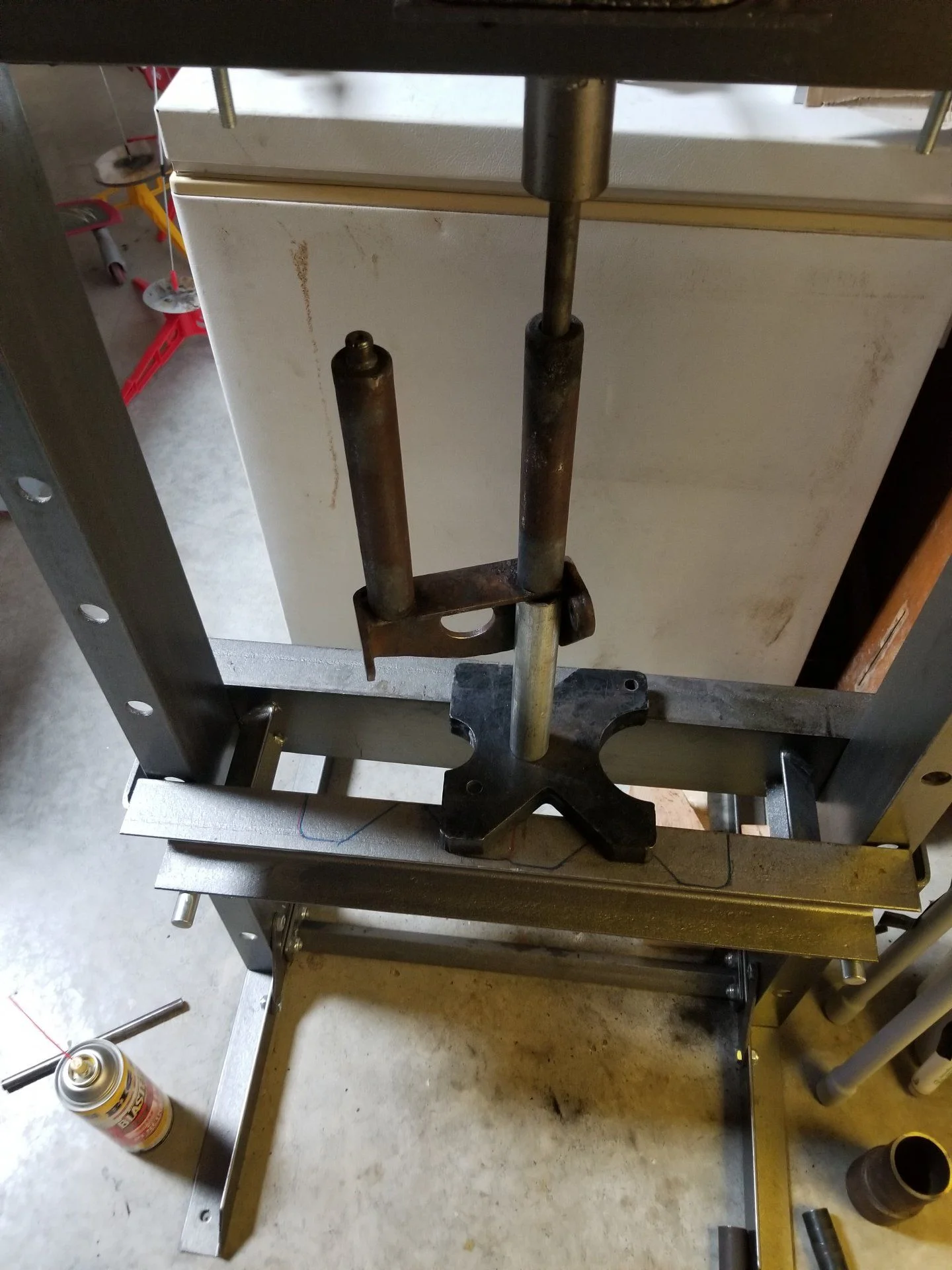

If you are disassembling the rollers for the fairlead you will need to use a torch and a shop press.
The long rollers have bushings on either end that are about 50mm long. You will not need to heat the entire roller, just each end. I used a 19mm impact socket to support the fairlead frame while I got the exposed end of the bolt pressed down into the roller. After that, a length of thick walled steel pipe for support. Use a steel bar to press once the bolt is inside the roller. It helps to add some lubricant into the roller once you get some space in there, its acts as a reservoir throughout the job.

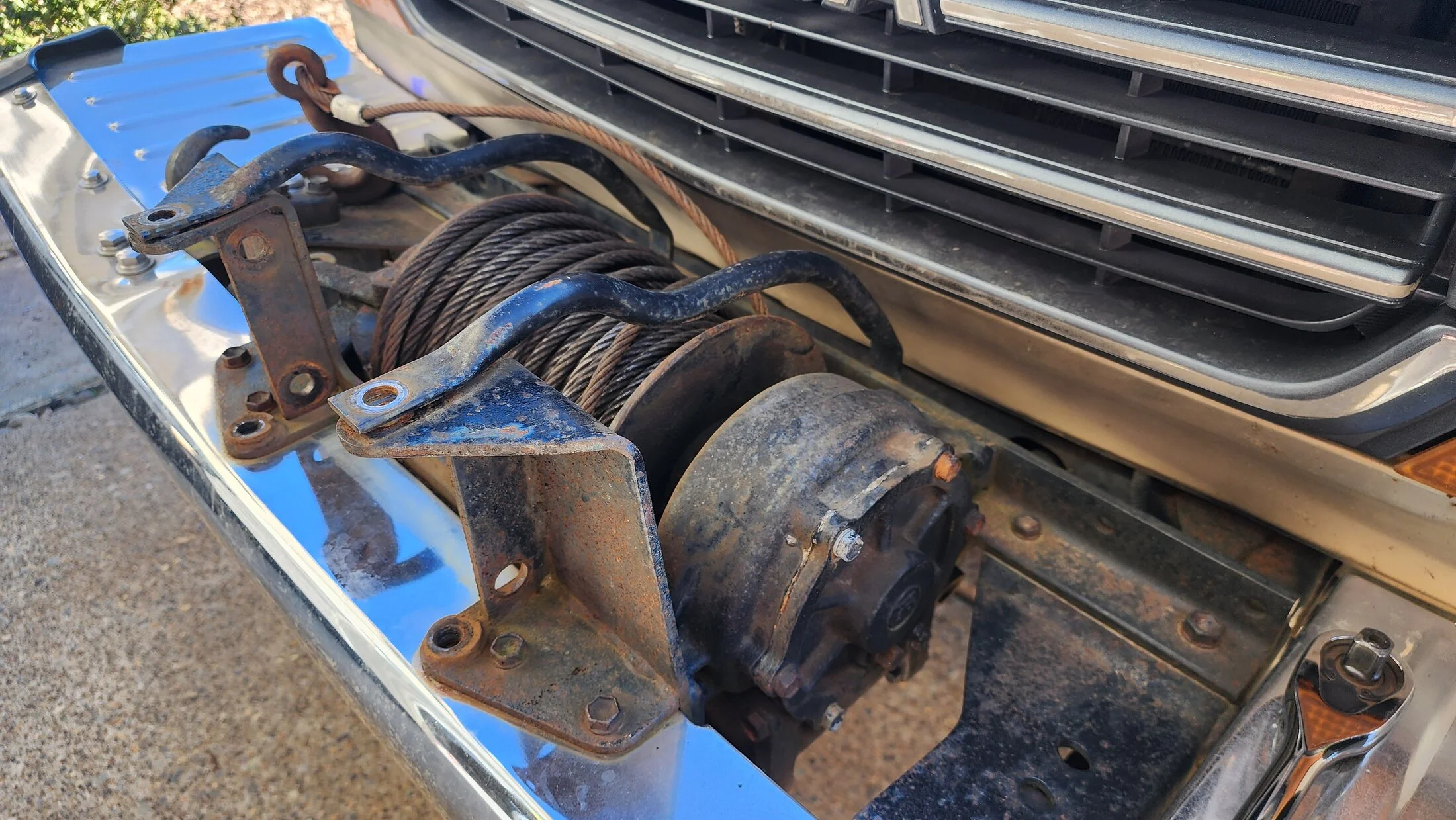

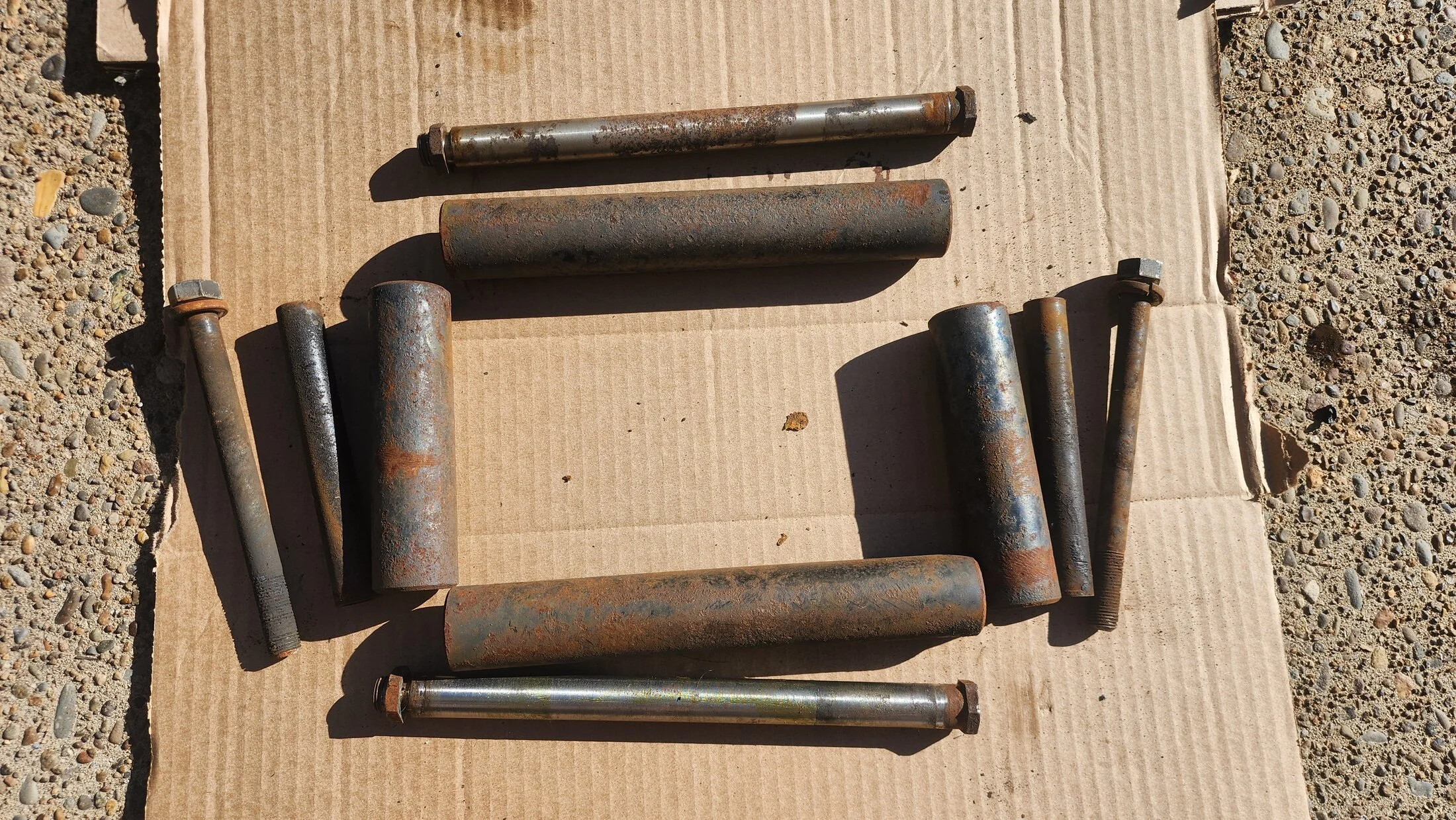

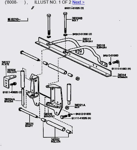

Well, I was able to remove them in the driveway....luckily. I definitely found why the side rollers have so much movement. Can any tell me if looks looks factory? Based on how easy it was to remove the rollers I think someone has had them taken apart before.
The top and bottom roller fit perfect over the roller bolt leaving no space for a bushing. The sides have a "bushing/spacer" that is way to small but runs the entire length of the roller.
It's on an 1988 HJ61

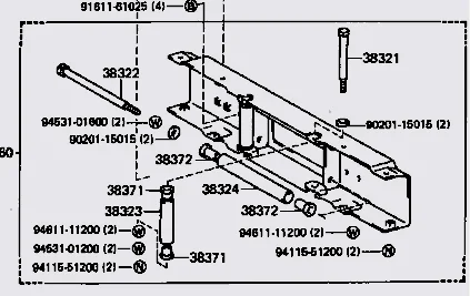

Screenshot 2025-02-11 at 14-40-56 38-02 WINCH diagram 1987 TOYOTA LAND CRUISER.webp

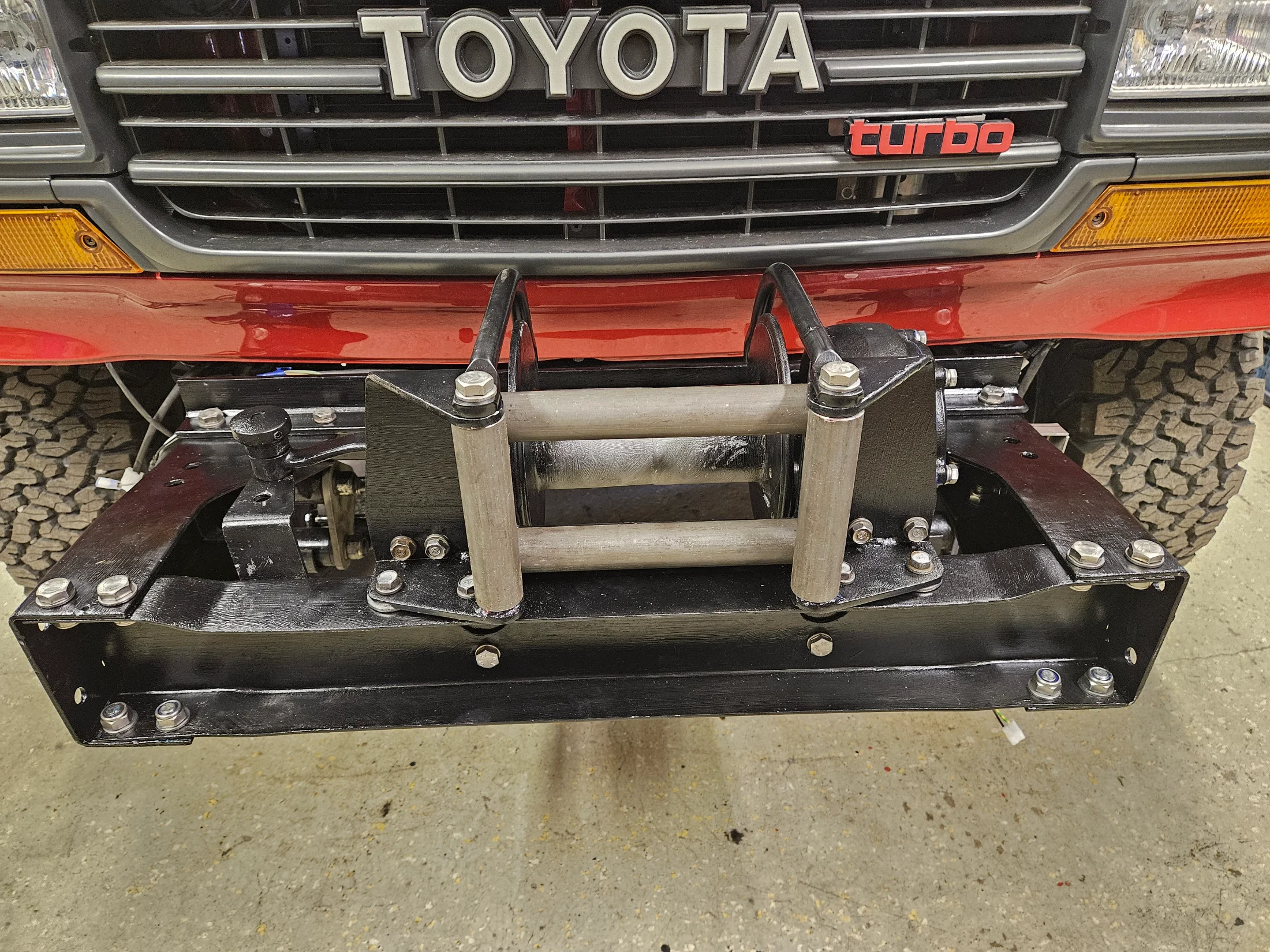

Just finished installing one on a HJ61 -'88

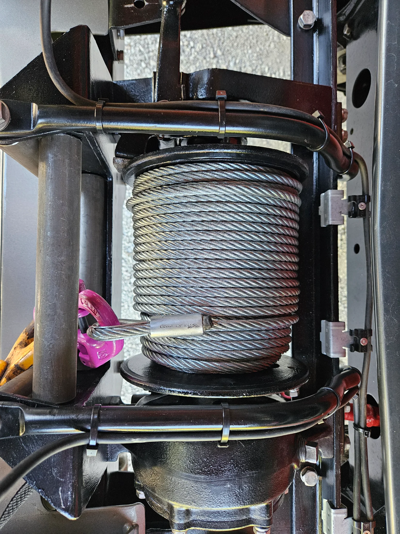

It is a HJ60 winch so now i have 5 gears out and 1 gear in :) . Wonder if it possible to just order the internal wormgears of a late model and replace them so it will be 5 in and 1out ??

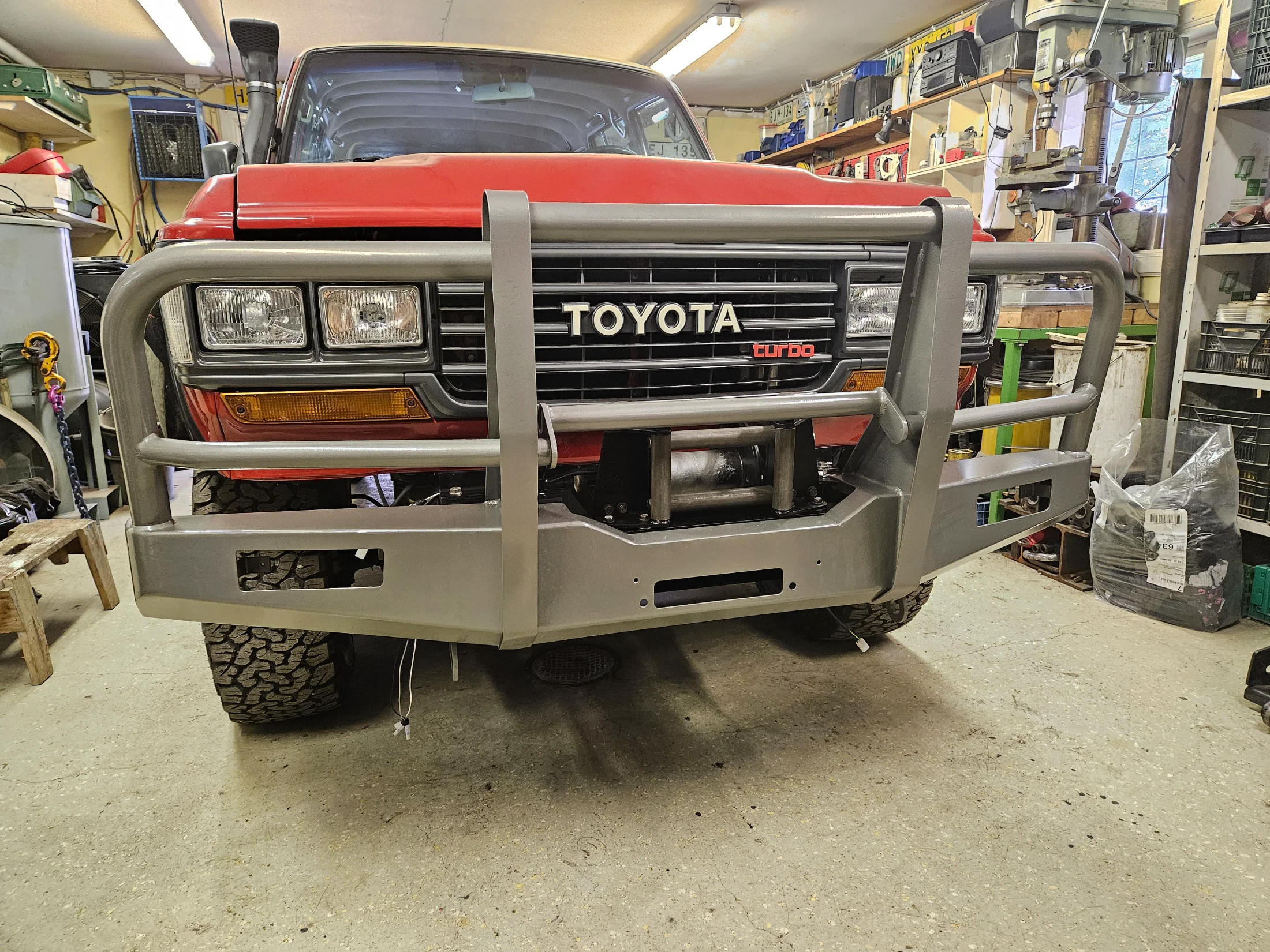

Rebuild an old TJM bar so it will fit arounf the winch
60M steel 8mm cable.
That was also my first thought .
Problem is the center of the drum is not centered between the 2 horizontal rollers.
It sits lower so it will give you a very steep angle upwards and the cable will strive the roller cradle. Not good offcourse.
By replacing the 2 wormgears with the later version I could solve the problem.
The tread on these gears is reversed directed.
You can actually see the difference in the EPC in the drawings of the parts diagram.
On to 87 left thread.
88 onward right thread.
