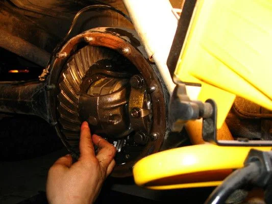

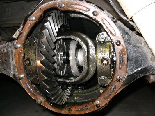

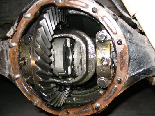

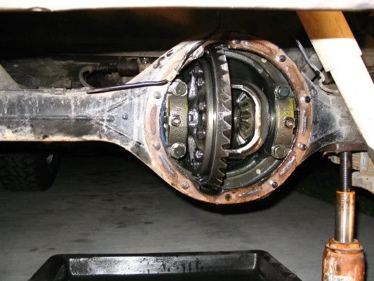

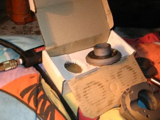

well provocruiser came down and we installed an aussie locker in his newly purchased fj 40
if you have thought about installing one but was worried about it being to hard. just ask provocruiser how easy it was,
just follow the intructions and its hard to go wrong
a few of these pics are not in order.

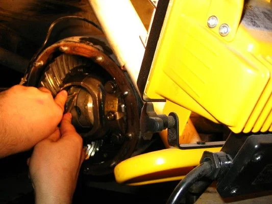

a few action shots while dan was putting it together
i think geting those damn little spring in their is the hardest part.
So you don't have to take the carrier out to do the swap?? If so, That's easy!
X2. And how many times did you have to fish out the right C-clip because it didn't hit the end of the axle shaft just right? I installed an Aussie yesterday, just as easy as doing a Lockright, but I think uninstallation will be easieir than with a LR because of the spring slots.
