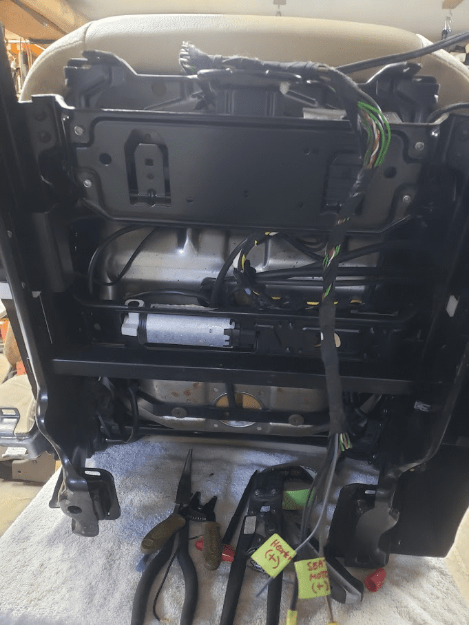

Installed a pair of seats from a 2006 Land Rover LR3. Ver1.0 tested out and worked well and ver 2.0 will finalize the design then I'll paint the mounting brackets. These seats offer uber lumbar and upper back support while providing bun warmers, which I'll hook up sometime later. The latest trip to AZBDR proved out the seats quite well, no back pain or discomfort whatsoever. LR seats has dozen wires while the 80 has only two so it took a while to sort all this out! I'll do a complete write up in the 80 section some day.
These seats are a tad tall for a low roof line like a 4runner. LR3s have tall roofs so if you're 6'+, these might not work for you unless you lay the back down a tad. These seats move WAY further back the 80 seats.
View attachment 2355764 View attachment 2355765 View attachment 2355766 View attachment 2355767
Installed a pair of seats from a 2006 Land Rover LR3. Ver1.0 tested out and worked well and ver 2.0 will finalize the design then I'll paint the mounting brackets. These seats offer uber lumbar and upper back support while providing bun warmers, which I'll hook up sometime later. The latest trip to AZBDR proved out the seats quite well, no back pain or discomfort whatsoever. LR seats has dozen wires while the 80 has only two so it took a while to sort all this out.
