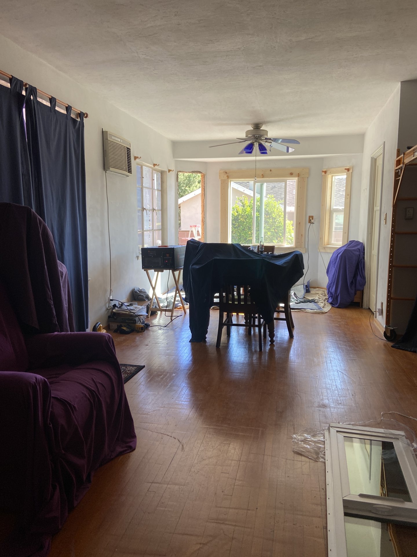

And I got to upgrade the 75 year old windows in our dining room:

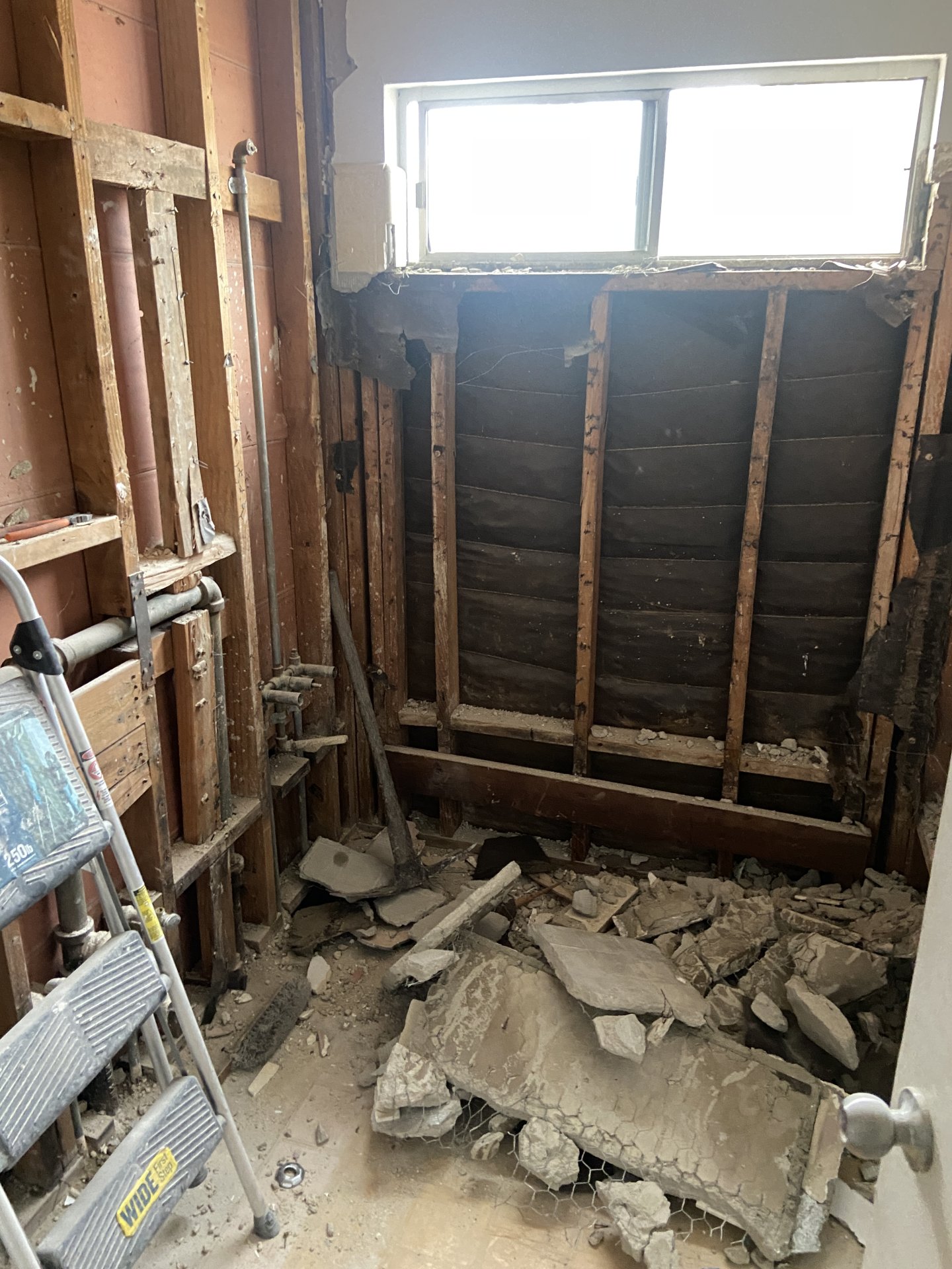

And the other bathroom

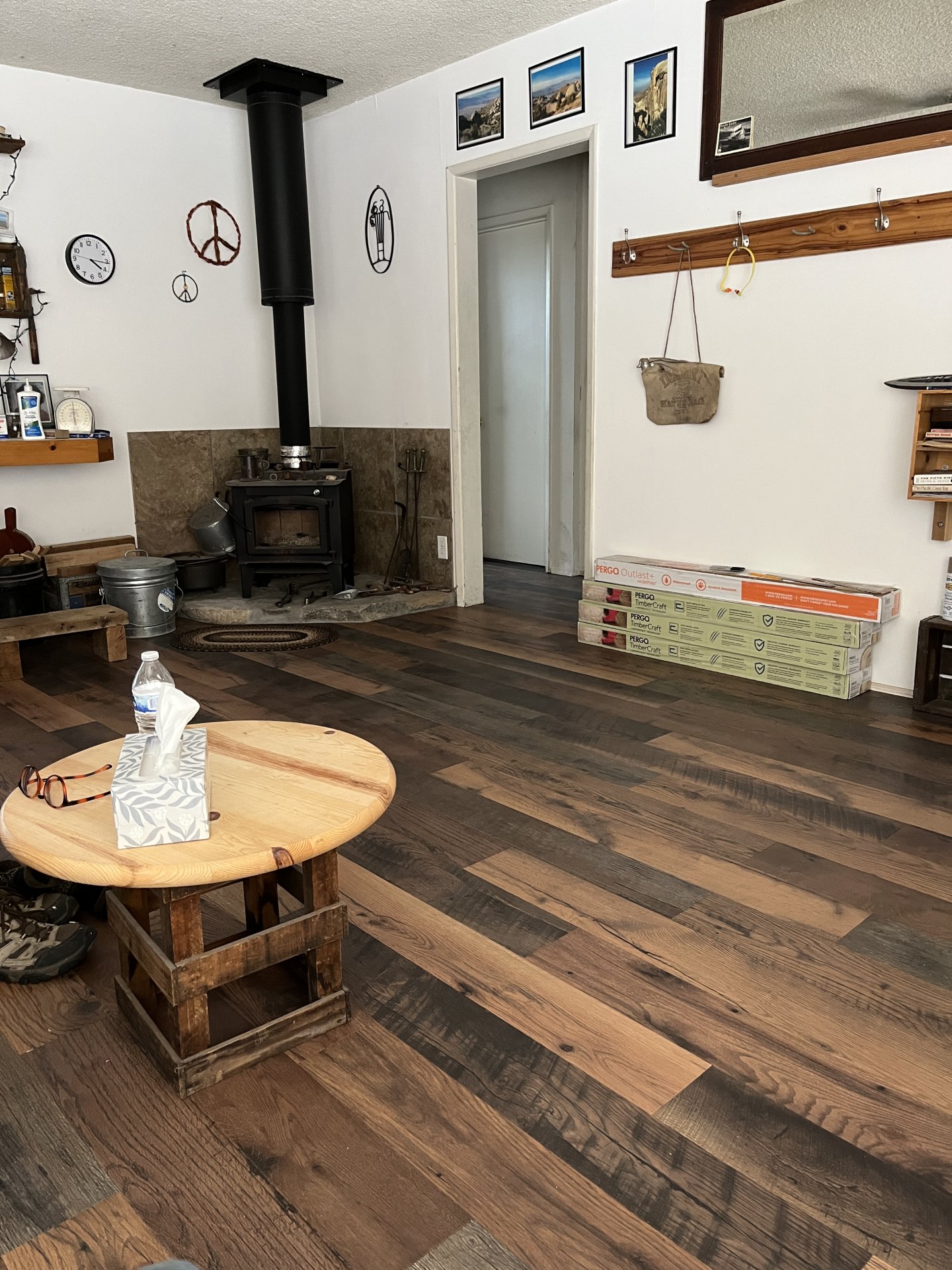

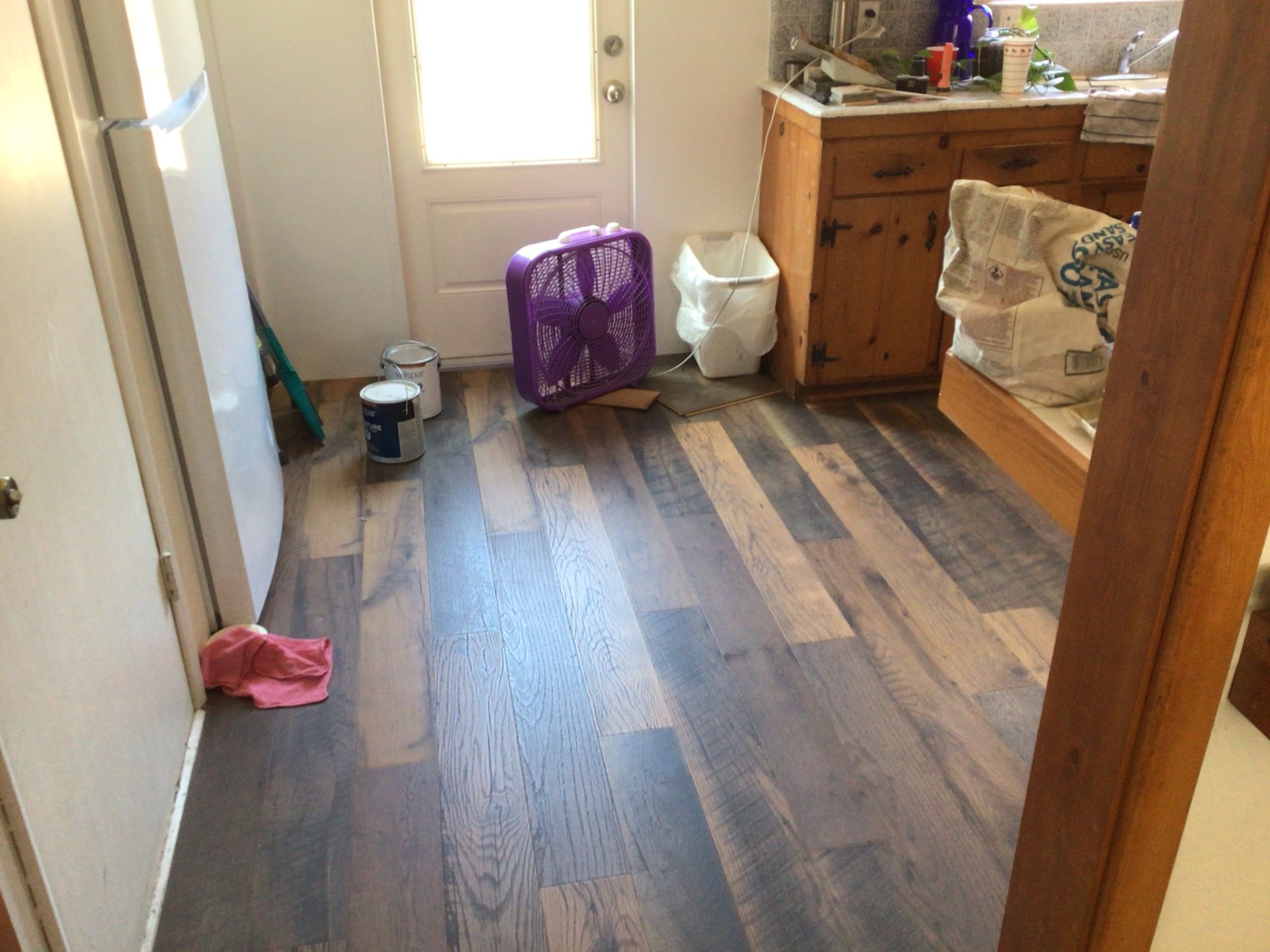

2022, just a month ago, I finally finished plastering the kitchen from the remodel that started in 2013, painted, and put down a new floor.

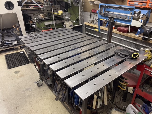

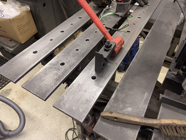

Welding table continued.
Made the M12 threaded holes, here is an idea of how they can be used.
View attachment 3090005View attachment 3090006

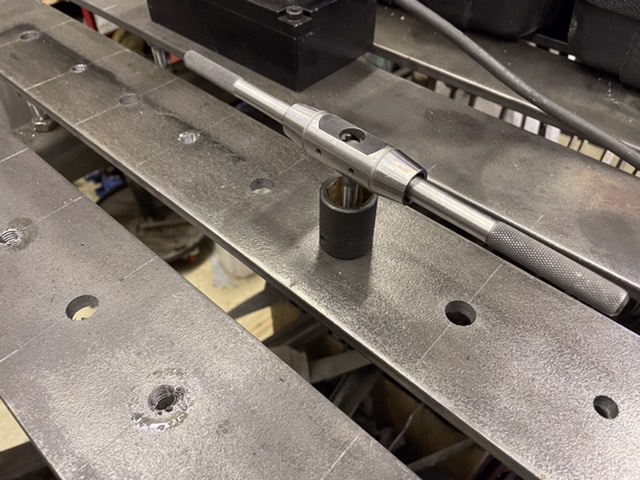

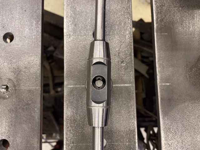

continued with the holes and had to find a simple way to get the threaded holes at the corectish angle.
I didn’t want to spend time to create a tool for it and looked at ready available options.
Found out that using a socket upside down worked good. You just look from the top down and see the rim of the socket.
this gives a good idea of how square you are threading.
View attachment 3090007View attachment 3090008
All holes are in.
I’ve been wanting a welding table myself. Very solid work!

This is from the times when steel was cheaper then gold.🙄
Its heavy, when I made the frame I had to use the cherry picker to turn it around.
Yesterday a neighbor was doing some work in my shop and when I came in later in the evening I found this.
The table is >200kg, I kindly asked him next time to move the wires before rolling the table out of the way.🤨
If I had to do it over I would probably buy a standard fixture table kit.
much easier and faster.
