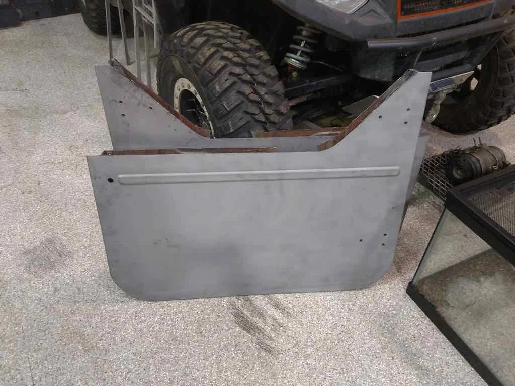

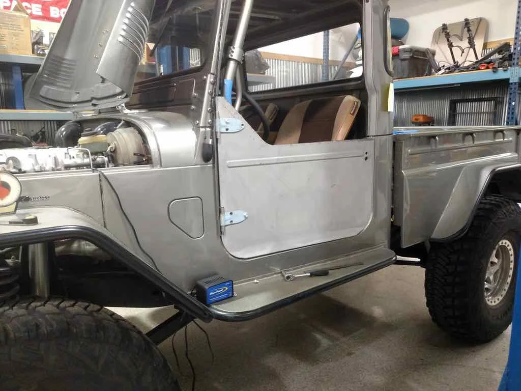

After 10 years since it was first built and 4 years since the last post, its time for a update and facelift...new winch control and fan controller turned into a complete revamp of the engine side of the electrical. Changing the dash configuration with the new cluster from Dakota Digital and water jet cut dash panel with added glovebox. I am finally going to clean up the LineX on the fenders and repaint the cowl and hood. Also started a set of half doors using a pretty nice set of factory 64 doors which will be painted body color at the same time. This old girl doesn't get wheeled much anymore, so its time to get her looking good again.

Like the angles on those doors! What is the plan to cap them off? I bent my caps with 1/4 radius bends and like the look, but I learned that you have to weld them in place in the door, otherwise they can really twist and warp and suddenly not fit.
Mine are still on a shelf; however, I wonder how hot they will be when installed in the sun, such that it is not comfortable on your arm.
Already capped them off with 18ga sheet metal. Tacked them with the doors mounted then finish welded them on the bench. I plan on doing some kind of top for an armrest, just not sure yet.
