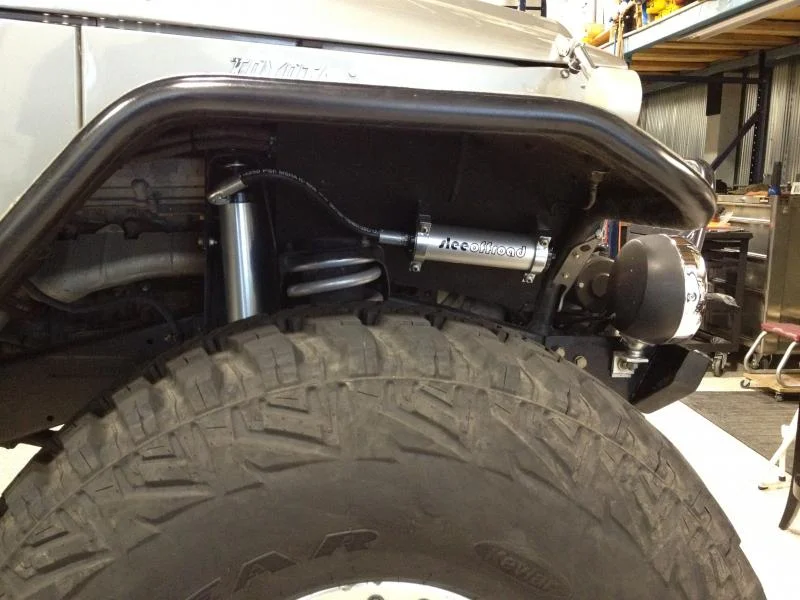

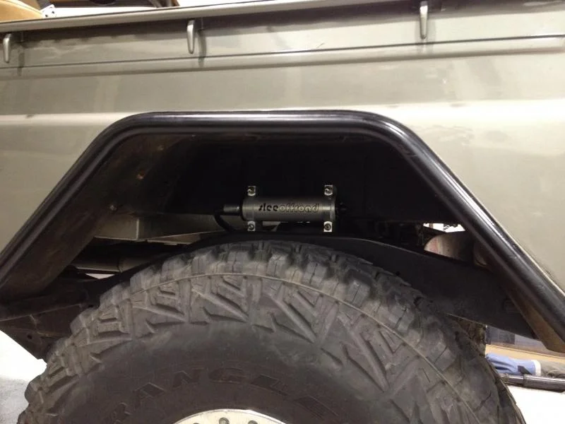

Been working with Slee on some reservoir shocks for the 45 and they came in just in time for Pismo. These things are a work of art and putting them under the truck seems like injustice. I went with a 2.5" body shock, built in bump stops, and large remote reservoirs for maximum dampening. Charged them at 175 lbs. nitrogen and did a short drive down the street. What a huge improvement. Cant wait to get the truck to the dunes to get a real feel for the new setup. These are available from Slee for 80s and 100s from stock to any lift height with no shock adapters needed, so they are a true bolt in design.
Very pretty.
I believe those tires could use a wash however.
Sand is wonderful at cleaning tires :)
good looking shocks .. valving you choose .?
little hi jack .. your opinion on those tires ?
thanks !
