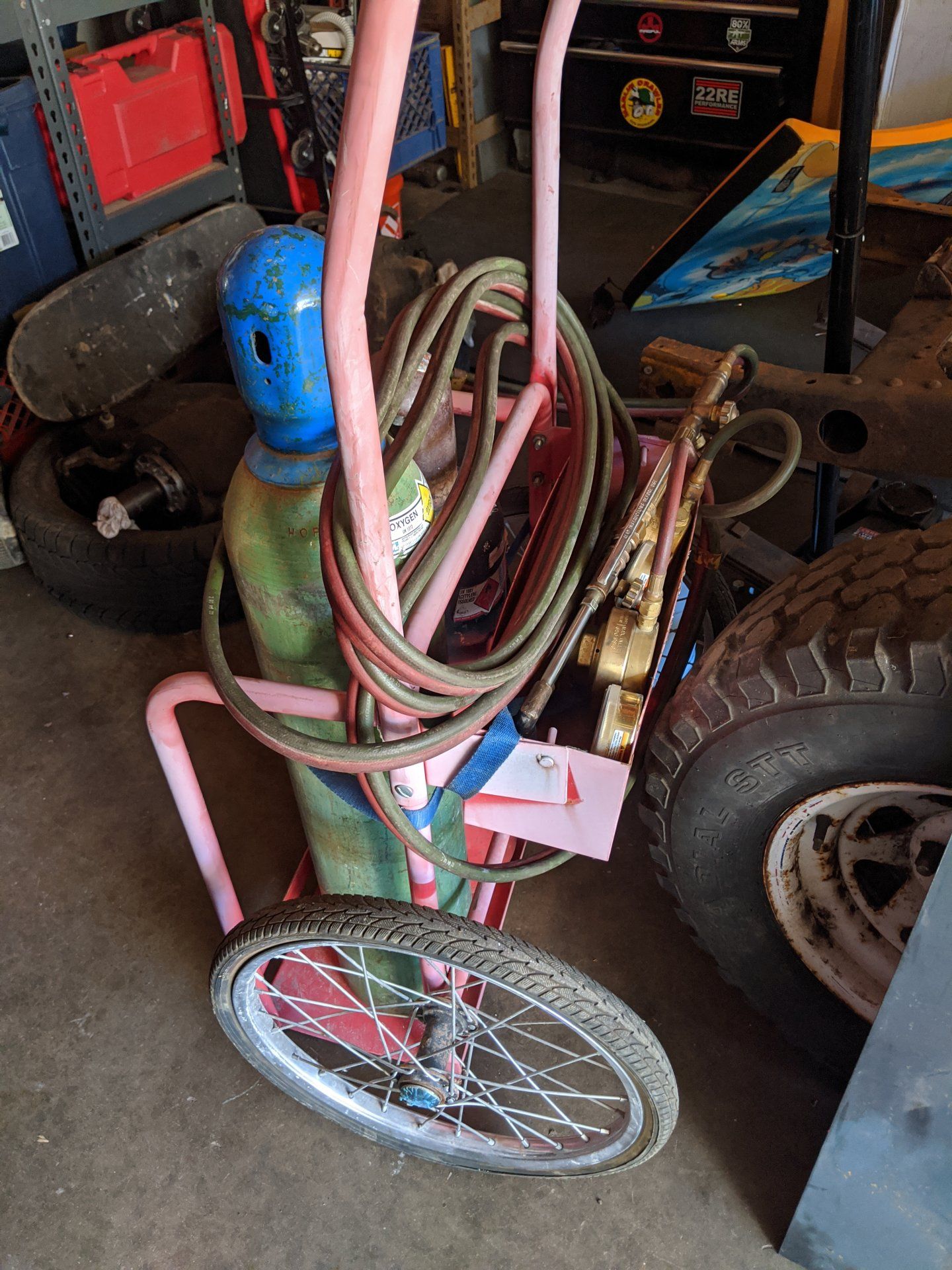

Got these three things for $80!
Victor Jr. Torch set with tanks to cut off spring perches etc...

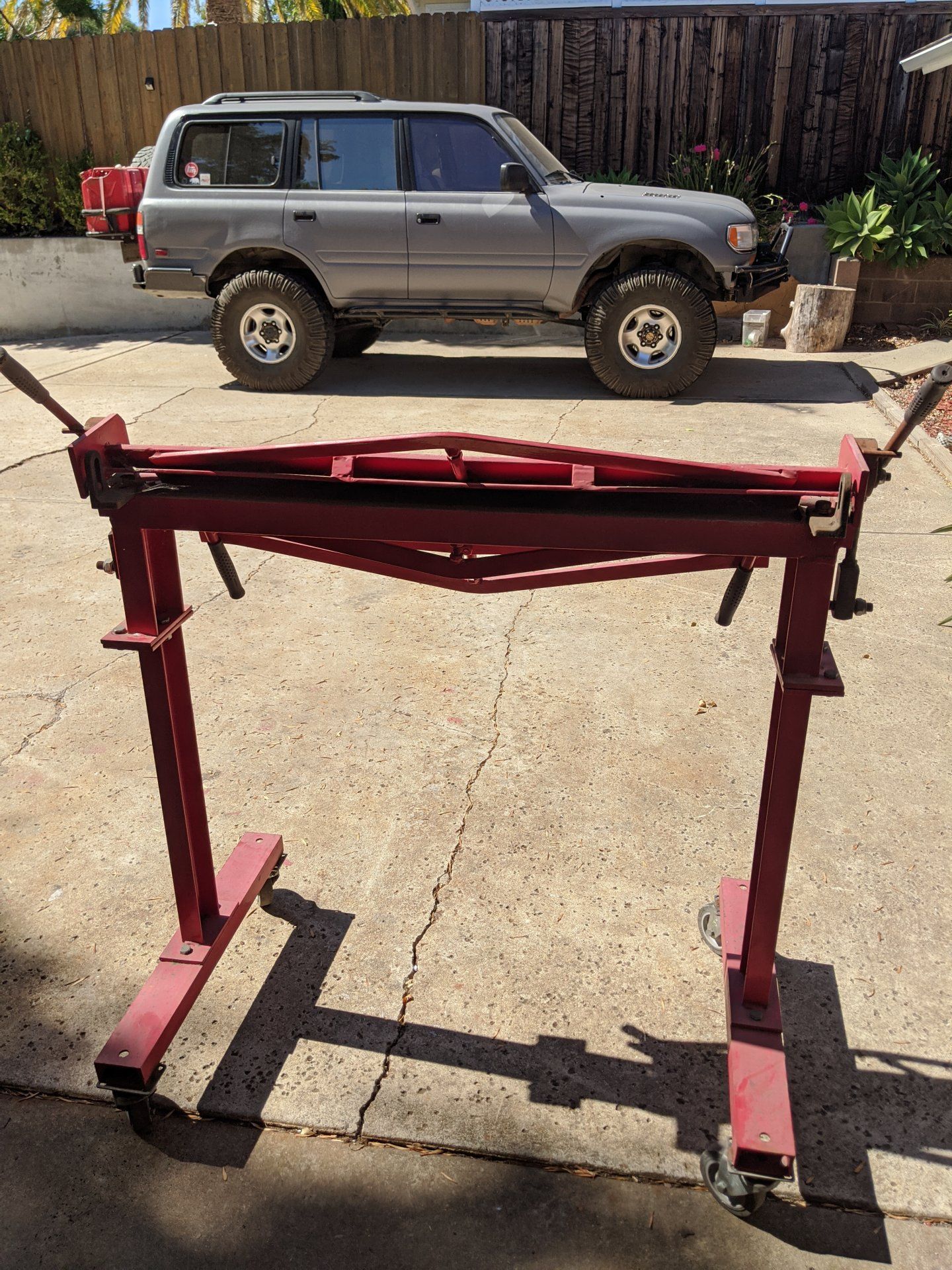

36" metal brake to make new floor pans
Chair to sit on, put my head in my hands and say WTF have I gotten myself into???
Scored on the tools, I have always wanted a brake, the 3' size is perfect for a garage shop.

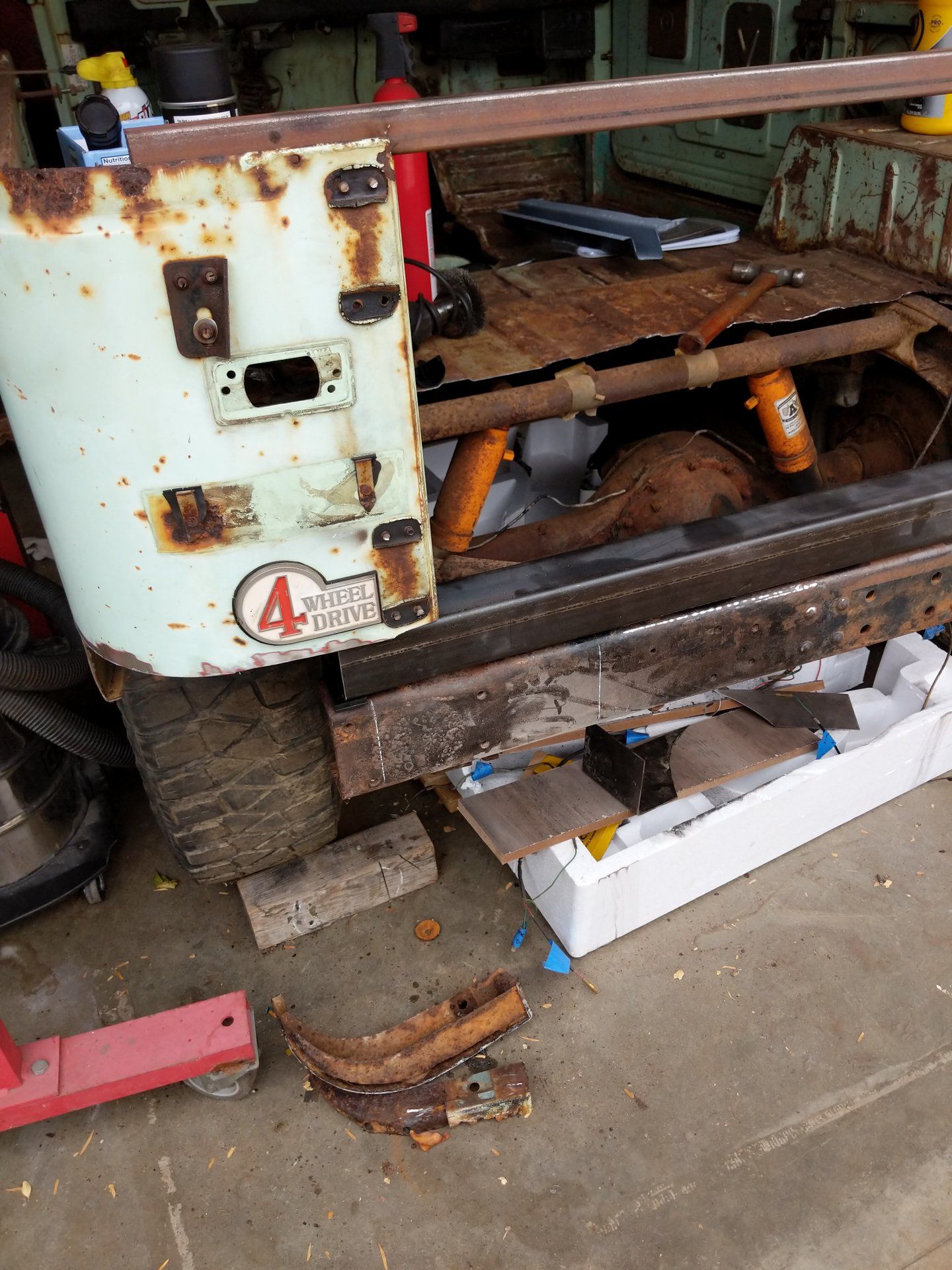

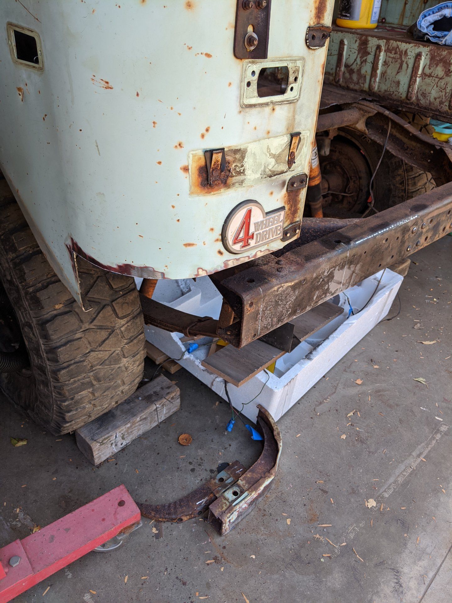

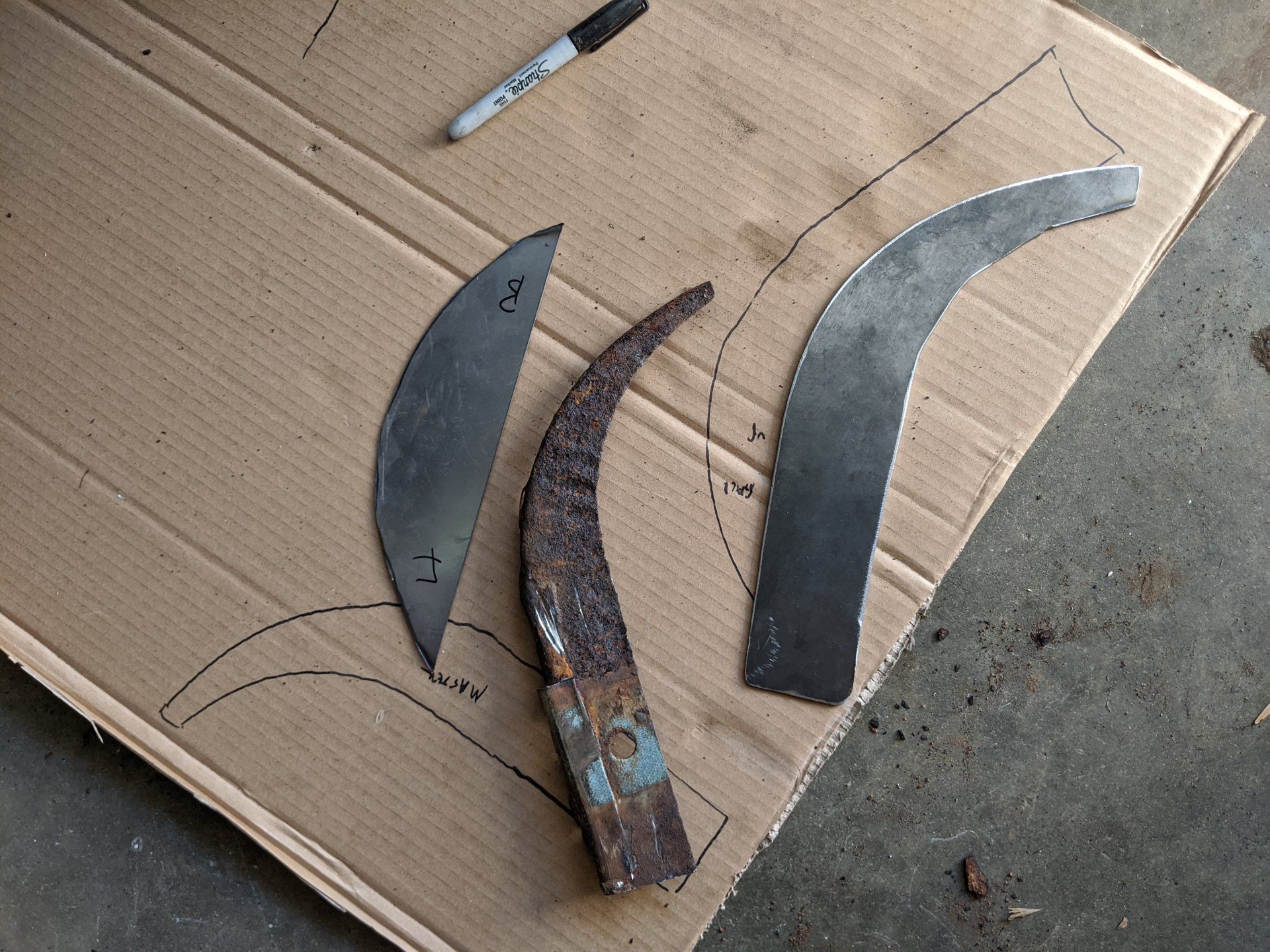

Trying to reproduce the outer curve from the rear quarter panel supports, but the one I pulled off is pretty bent, so there was a lot of cutting, fitting, grinding, cursing, sitting in the chair and then doing it all over again. I tried with 10 gauge and 18 gauge, but think I have it close enough to reproduce. I'll make 4 out of 16 gauge and then skin them in 18gauge.
I'm thinking of running the 2.5" square tubing past the tail gate opening since the curve doesn't start until further out, it'll add strength. I'll weld the curved ends to the tube which I'll cap so water doesn't get in.

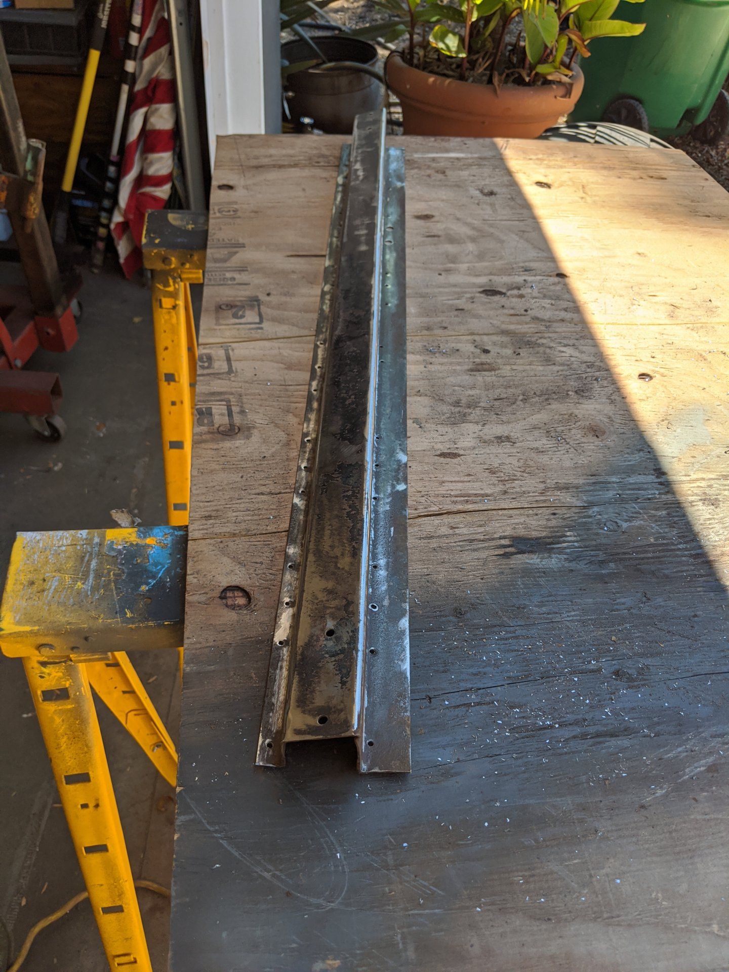

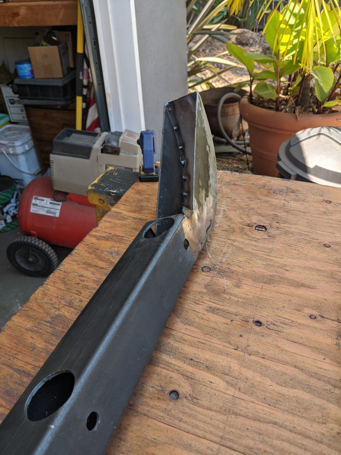

I decided to make the new sill out of 2.5" .120 wall. One of the things I always forget is that there are so many people on this site and other sites that are great fabricators that they can bang things out. For guys like me it just takes a long time to make anything, it is not what I do for a living, I'm not a tradesman, I am a hack but having a blast
I fit it, test fit, fit it again and ended up making the curves out of 10 gauge steel I had lying around the garage. I cut four half moons. I put a door on to make sure everything lined up and shimmed the sill to the height it would be at with the bodymounts.
I made the 2.5" .120 wall tube longer so that all four body mounts go into that piece of steel as opposed to having them go into the sides. just made it easier to make the sides because they don't need to have the same structural rigidity. I skinned the wings with some 18 gauge I had lying around and then used the flap wheel to make it purdy.
I got this quart of paint from the dump as part of a chemical exchange program. I poured a ton of it in the tube and tried to get the entire inside covered.
