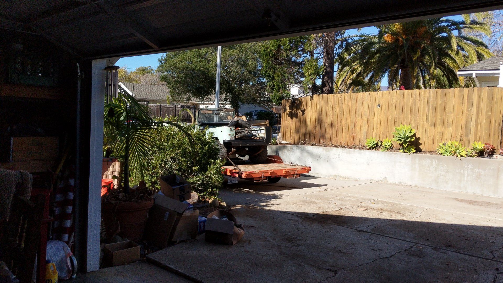

Happy wife, happy life...what does that mean? It means that a project had to go and the fj40 didn't make the cut:( I learned a ton though and will find a keeper at some point
Nice Picture frame, We can't see what project made the cut .
:frown: I was really enjoying this Build
For a minute I thought those boxes by the door meant someone was moving out....... :)
If I didnt make the tough decision, I would be moving out....
