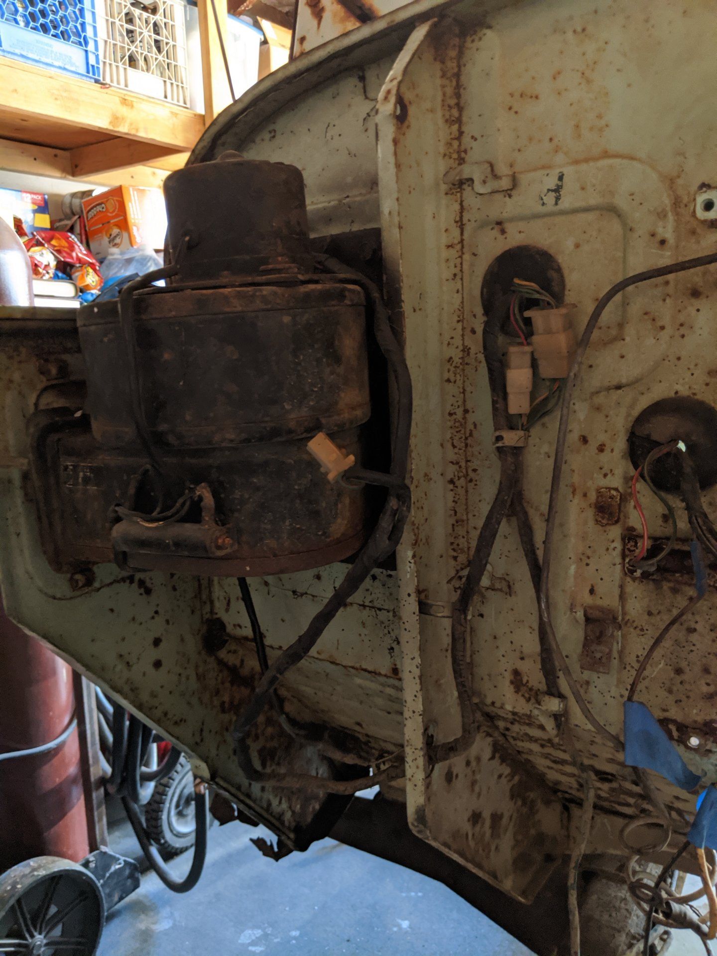

Yeah, a few things I noted. First, there are vapor tubes build in to the passenger seat that are tee'd to the gas tank and run all the way to the rear passenger quarter panel (this vapor thingy) and the driver side front fender which is a vacuum solenoid of some sort...a lot of tubing that will be removed! Anecdotally, the passenger rear wheel well is rustier than the driver side, not sure if fuel vapor promotes rust or if the top leaked there more etc...

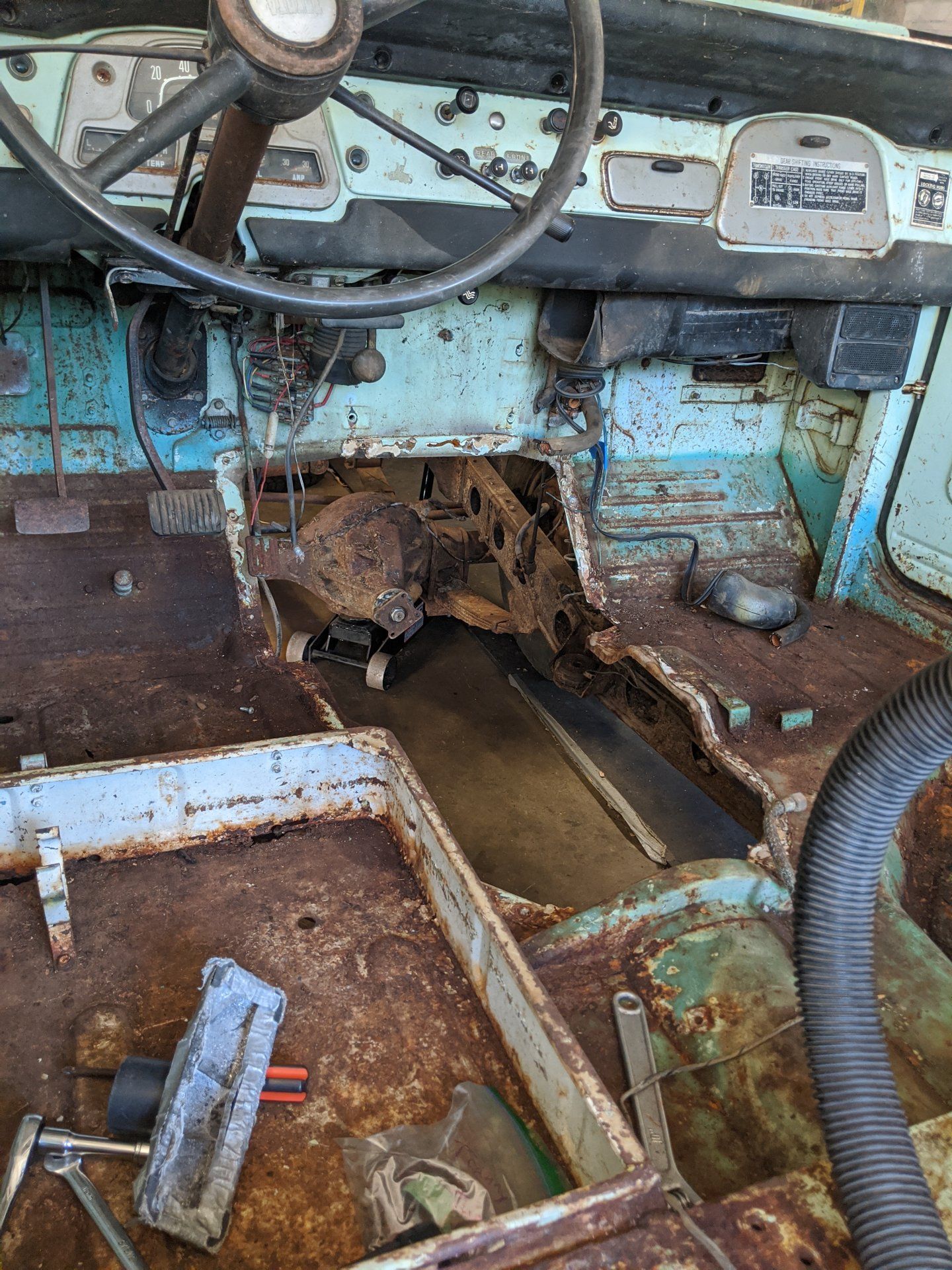

Was there a skid plate attached to the tank? The skid plate bolted to the top of the wheel well in front of the tank. Follow the angle of the tank down, then ran underneath the tank. Believe two bolts held it to the bottom of the tank.
Yup...it is kind of a jigsaw puzzle. The vapor canister covers the bolts to the seat and the rollcage covered the bolt to that. All out now...

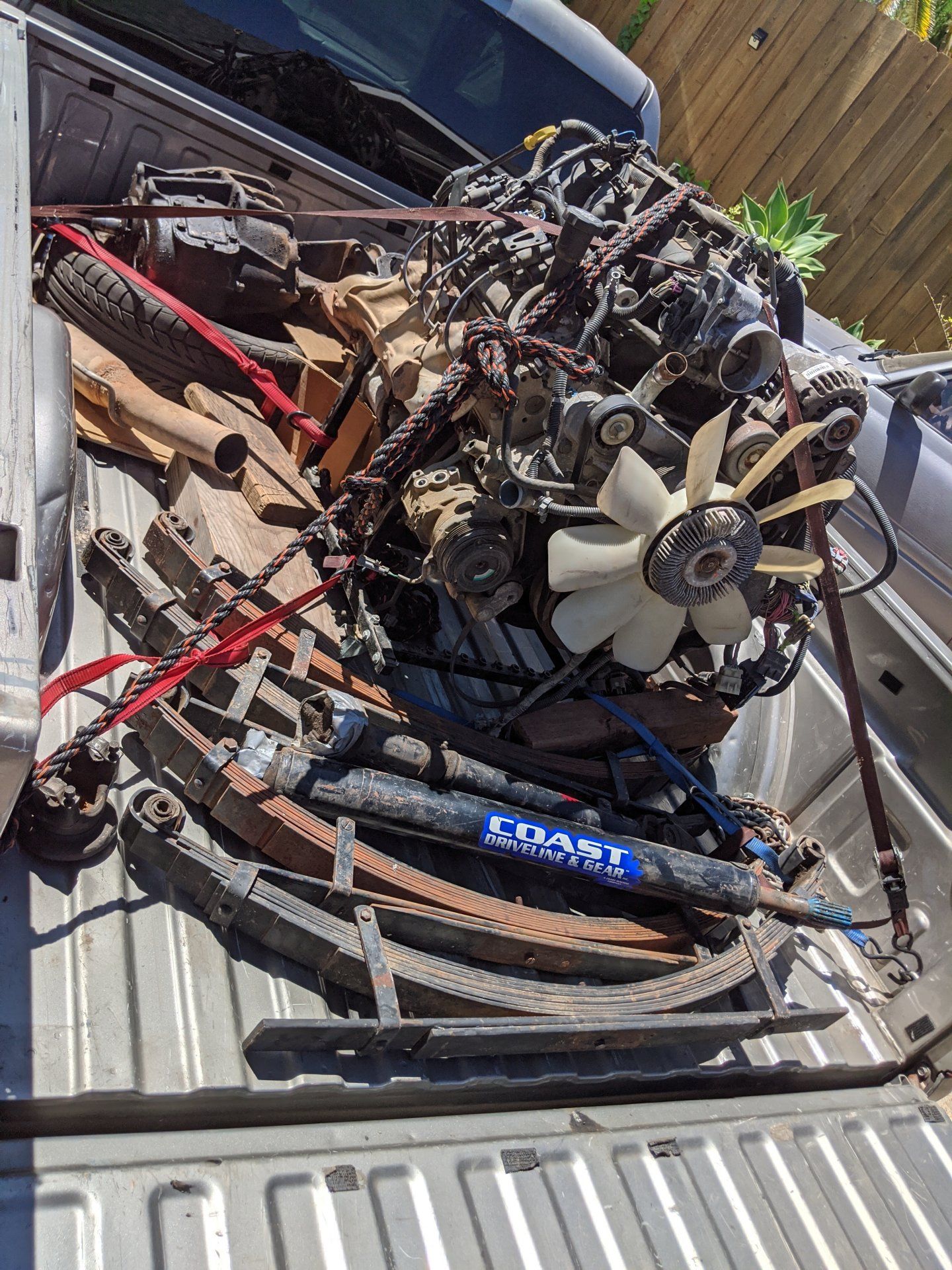

Current plan: 6.0L, SM465, NP205, 1 Tons (or fj60 if I can find some) and keep a lot of the patina. I'll fix all the rust that is structural, but not stress too much about cosmetics.

Ok, got the milk for my wife and had a few minutes left so I pulled the engine, which is now for sale
Ok folks...not too much to update, I did a few things like pulled out the steering column and cleaned up some things, but I could use some advice on how to approach the body work as I don't really know how to do it.
Here is my plan:
Wire brush the interior and replace anything with holes in it (floor board, etc...). Next I will replace the quarter panel and rear sill, then I'll paint the interior with chasis saver or rust bullet (should I use that rust converter stuff since I'll top coat it?). Once that's done, I'll pull the tub off set up the suspension then paint it
Ok, so a few questions.
1) since the stock inside rocker laps over the floor, I assume it ok do do that again? I thought panels were supposed to butt together to avoid capturing moisture
2) should I start in the back and work forward or at the firewall and work my way towards the rear...does it matter?
3) I was thinking of replacing the rear sill with a 2.5" piece of square tube.
4) I'm also thinking of replacing the rockers with square tube for sliders...
Seem reasonable?
