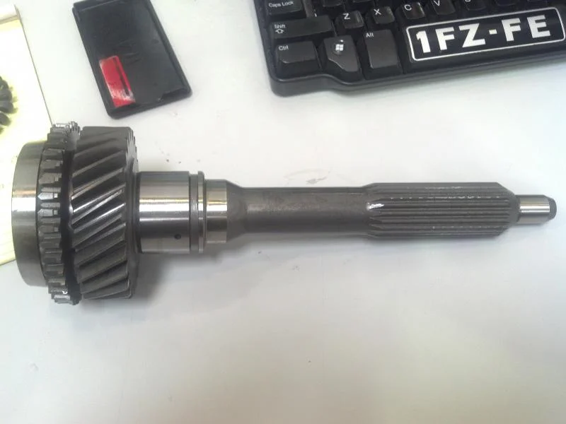

Engine and Transmission Sourced
So, a little bit of an update here as I have my motor and transmission sourced. Going for a one-of-a-kind setup for sure.
  • H55F and related bits have arrived at Valley Hybrids - Thanks Onur
  • 1HD-FT flywheel expected sometime in the next week - Thanks Akella
  • 1HD-FT motor expected sometime in the next week - Thanks Cruzerhead...yes 24 valves of Toyota Turbo-Diesel Power!
  • Cab is currently being moved to the new frame - should arrive sometime in July - Thanks EcoOffroad
Just a little bit of Cruiser Pron for those who are wondering...

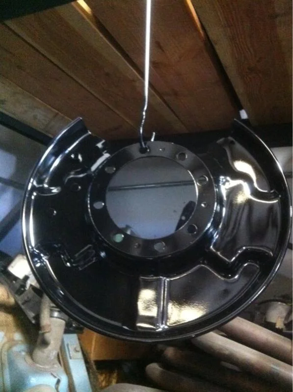

Two more items made it in just before the holidays...
One of Kevin's Tailgates :p
picture.php
Custom Plates :grinpimp:
picture.php
The truck heads into the production mode after the New Year! :bounce:

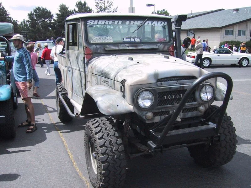

Haven't seen that truck in a while...it used to live here in Boise, Id. This is the last time I saw it on the road, circa 2002.
You gonna keep the Shred The Rad sticker?
